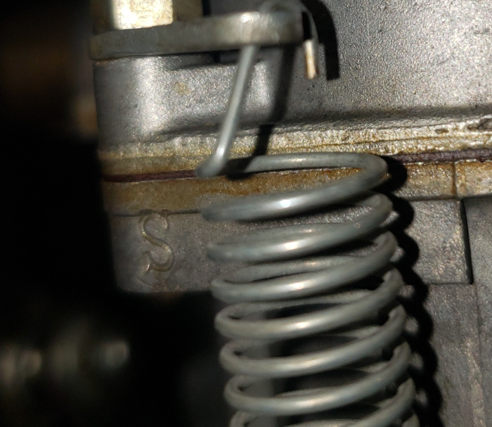

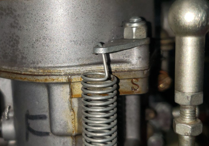

ctc911ctc   Here are the pictures I promised, first, here is t...   Jun 1 2025, 07:22 PM

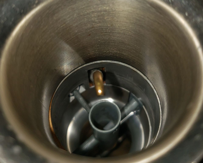

ctc911ctc   ..................Continued................. Insi...   Jun 1 2025, 07:25 PM
sixnotfour   Not Even Italian.... Those are from PMO way back w...   Jun 1 2025, 07:41 PM

ctc911ctc   :shades2: Almost matching…………huh……....   Jun 1 2025, 08:24 PM

brant   I don’t know what stoddard was doing Assume the...   Jun 5 2025, 06:33 AM

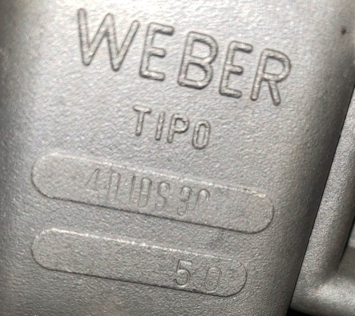

ctc911ctc   ****UPDATE**** Sooooo.......it would seem that on...   Jun 5 2025, 10:10 AM
rgalla9146   Those are replacement newer production carbs. ...   Jun 5 2025, 11:34 AM

Graydingo   Yeah those aren't PMO, Carter was making those...   Jun 5 2025, 03:51 PM
sixnotfour   Yeah those aren't PMO, Carter was making thos...   Jun 7 2025, 08:30 AM

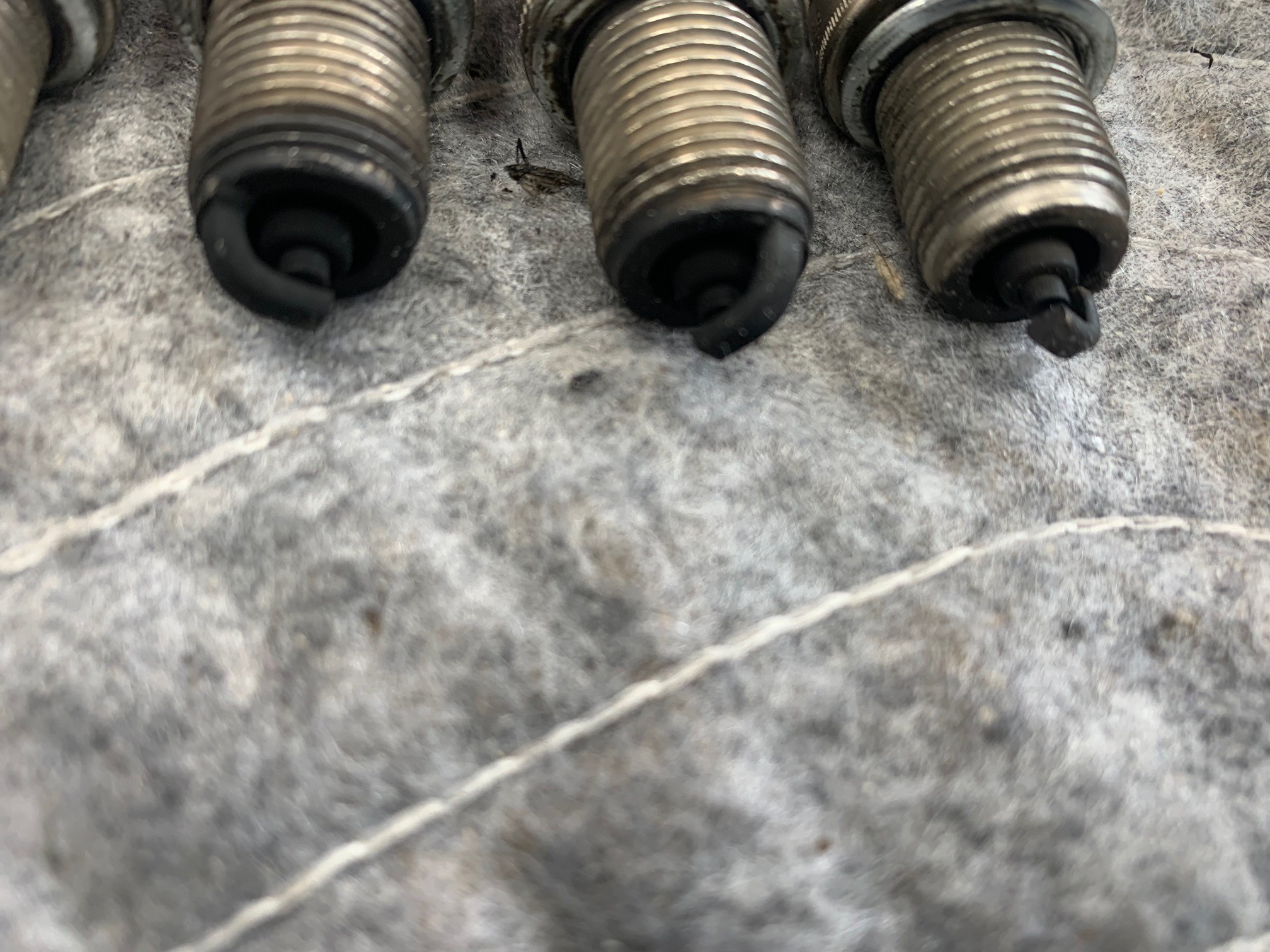

ctc911ctc   SORRRY - pictures are in the Preview but not in th...   Mar 11 2026, 04:06 PM

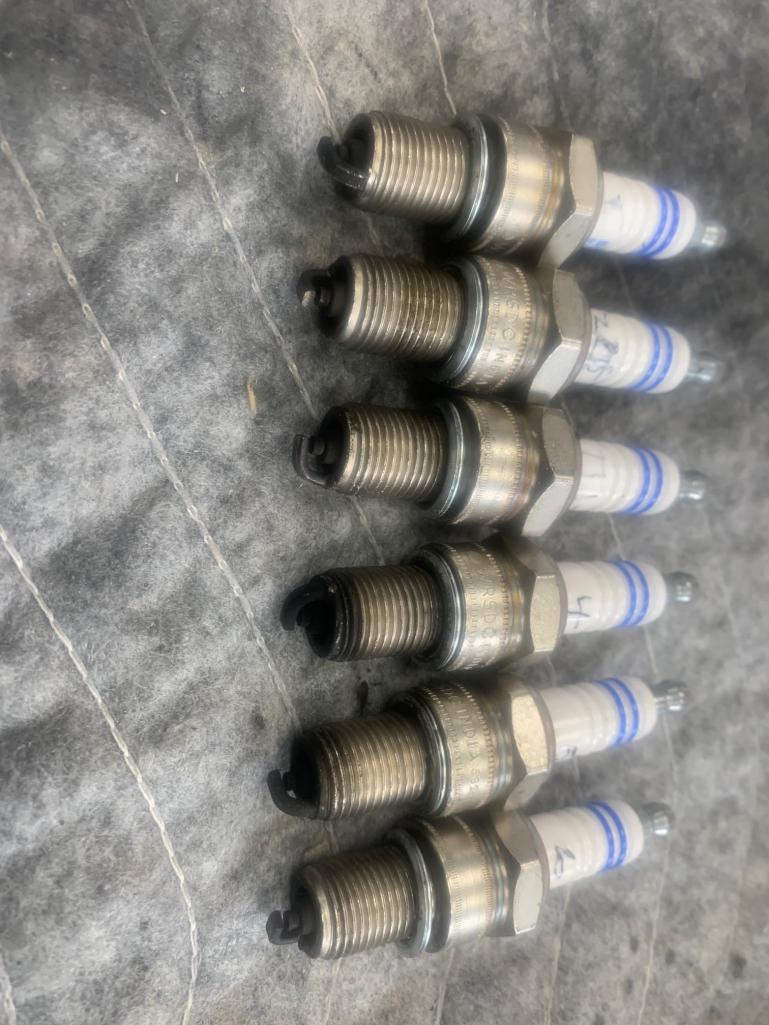

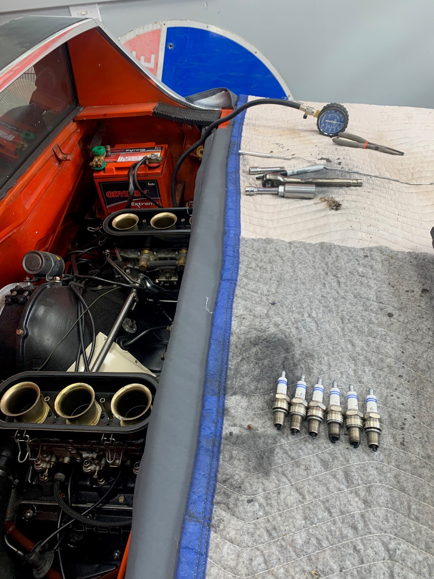

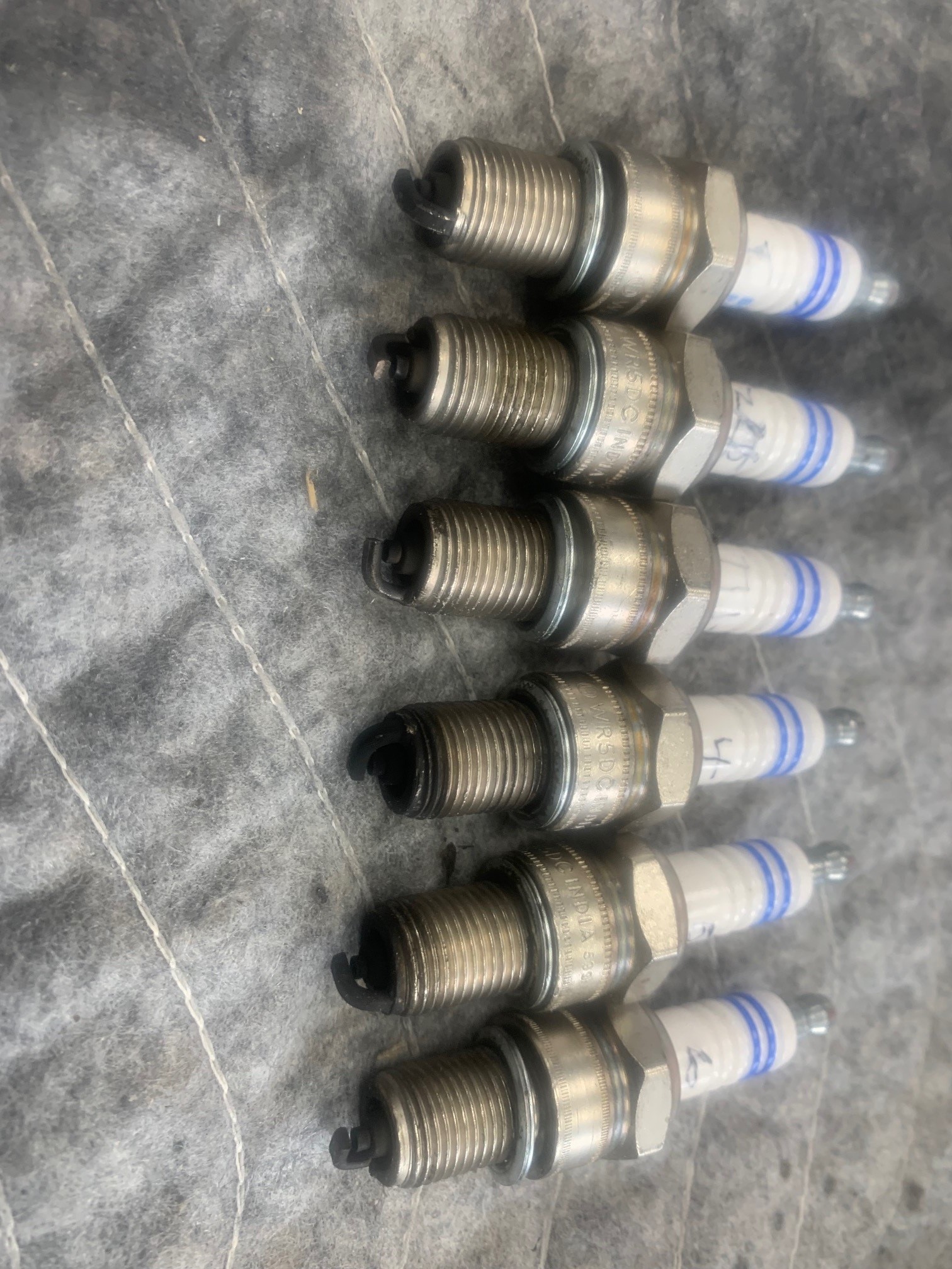

930cabman   One side very rich should provide a clue to what...   Mar 11 2026, 04:38 PM
ctc911ctc   Fixed the pictures within the last post - BUMP   Mar 12 2026, 07:02 AM
Superhawk996   www.914world.com/bbs2/index.php?showtopic=376092...   Mar 12 2026, 07:38 AM
930cabman   I'd go back to the basics and check everything   Mar 12 2026, 02:11 PM
rudedude   If you have had them all apart you shouid know wha...   Mar 12 2026, 05:36 PM
Superhawk996   If you have had them all apart you shouid know wh...   Mar 13 2026, 06:35 AM
gereed75   Just curious - does it seem to start/ run better w...   Mar 13 2026, 11:40 AM
930cabman   Just curious - does it seem to start/ run better ...   Mar 13 2026, 04:05 PM
sixnotfour   :blink:   Mar 13 2026, 10:56 PM
sixnotfour   back to square 2.. square 1 check that when #1 is ...   Mar 13 2026, 10:58 PM
