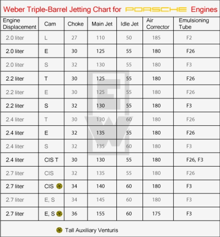

As mentioned, this is on a 2.7 from a 1974 CIS engine (stock).
Jetting and all carb related settings were based off recommendation from Paul Abbott and I do not have them in front of me, but know many others used the same with success so I trust those.
The fuel pump was ordered from Pelican- Pierburg pump. Pelicans number is:7-21440-51-0-INT

I put a temp inline near the carbs and blocked off the outlet to check max PSI and it read 12PSI, if that is not correct, I assume the more accurate way would be to have the outlet of pressure gauge hook up to the carbs when car is running to see what pressure is at idle?
Mains: 135
Idle:55
Air correction: 180
Emulsion tubes: F26
Venturis: 32

Are 135 mains the norm for a 2.7?
I don’t have a 2.7.
I run any where from 180 mains to 210 mains on the track. But race car. 2.0 liters. Depends on the altitude of the race

QUOTE(brant @ Jun 6 2025, 04:02 PM) *
I don’t have a 2.7.
Not sure if there is a 'normal' for these engines as I usually see 2.7 being way more built than my stock one if running carbs, but based on what I have seen in general it seems like that is a good starting point at the least and again, Paul Abbott recommended them so I would trust that at least for getting a baseline going
