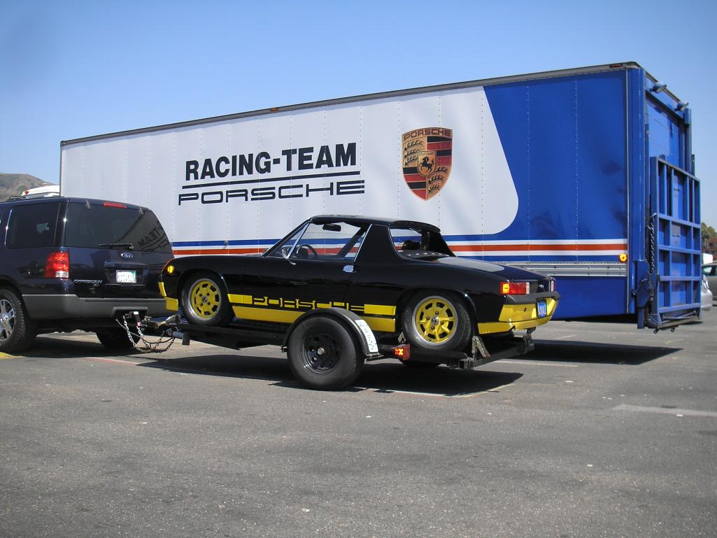

This is my trailer that I purchased here years ago (the one with the bumblebee). I think it is about as small as you can go. It was made by a local 914 racer years ago before I purchased it. I could barely feel it behind the Expedition when towing. The bummer was that the trailers fenders prevent you from opening the door once pulled on the trailer if you are inside you have to climb out the window and roll window as much as you can from outside. It does have an electric winch on it so it can be pulled on the trailer and strapped without opening the doors.

Wow, that is compact. My car has no roof so getting in wouldn't be any harder than usual. Food for thought.
