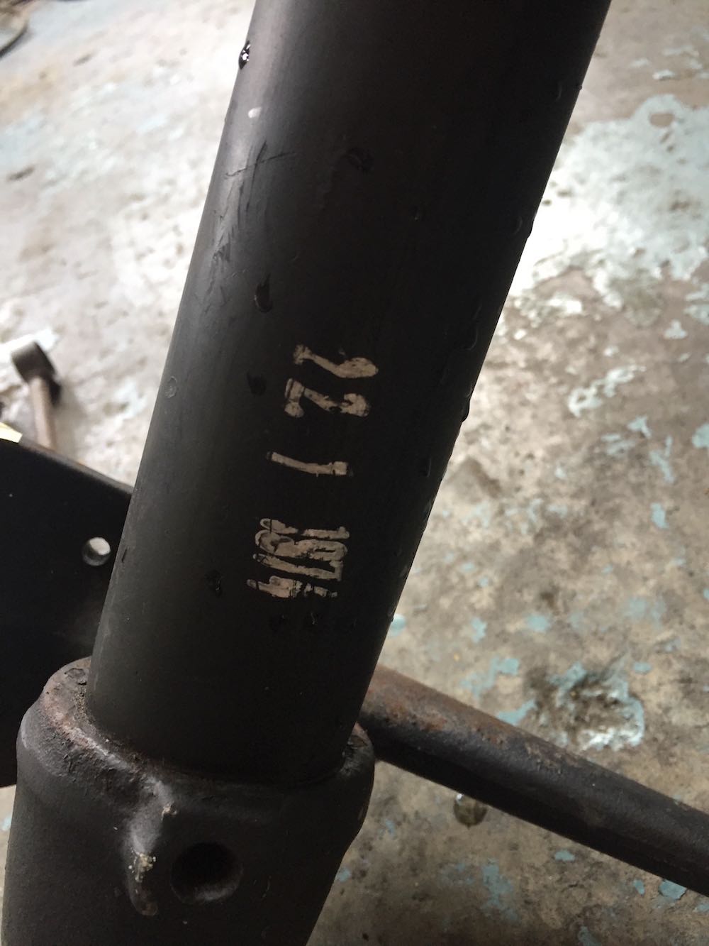

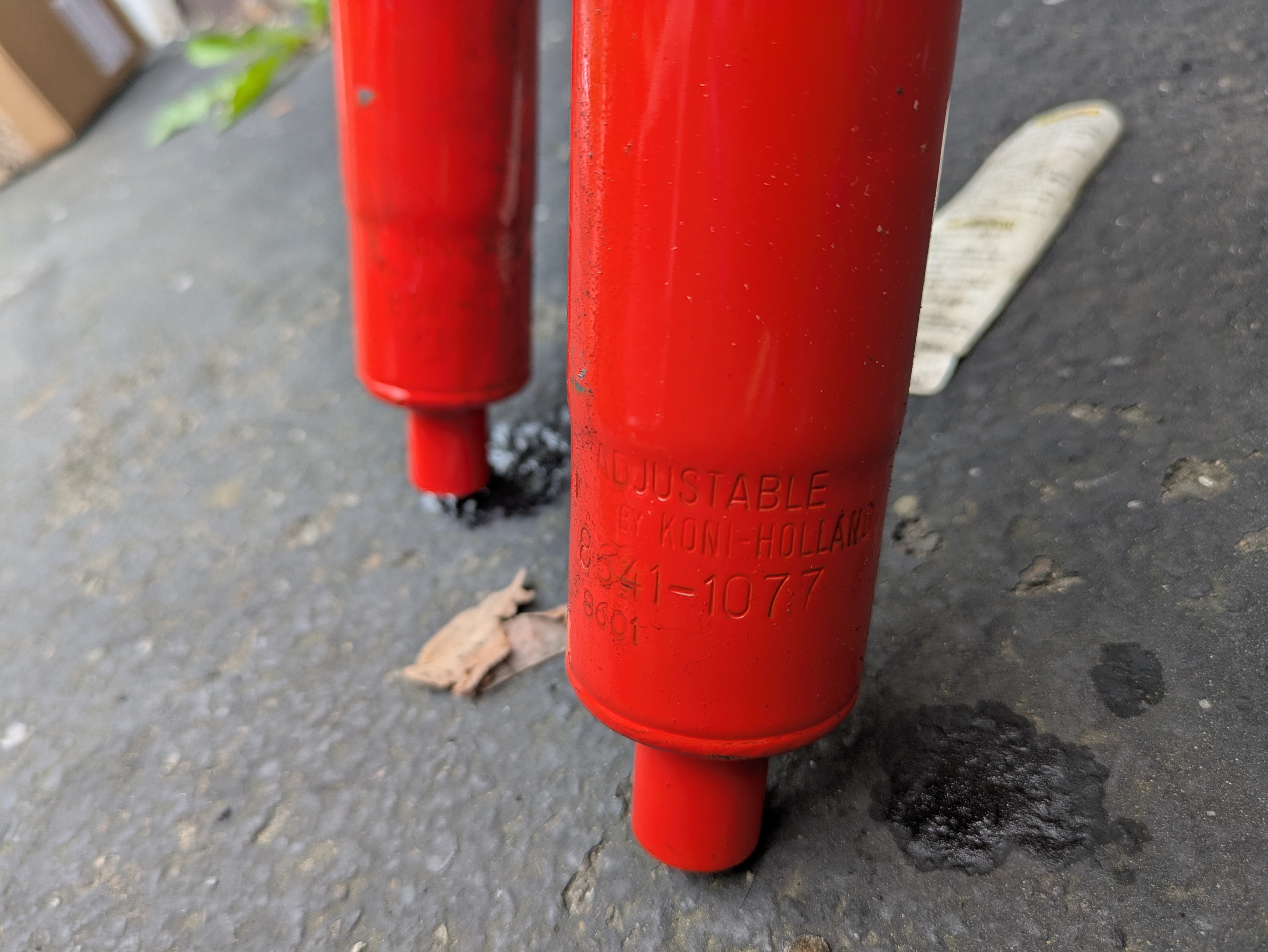

Here is the tag on the old konis
Everything went together fine, that big hold down thing didn't screw all the way into the strut but neither did the konis.

Ahh, well, I guess this is more like 5mm. It was nearly the same on the Koni. Maybe that is the point then.

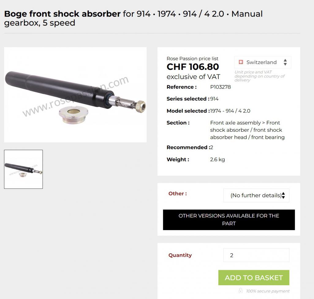

I was looking around for alternatives and found this:
https://www.rosepassion.com/en/diagrams-por...1-103278-z90088

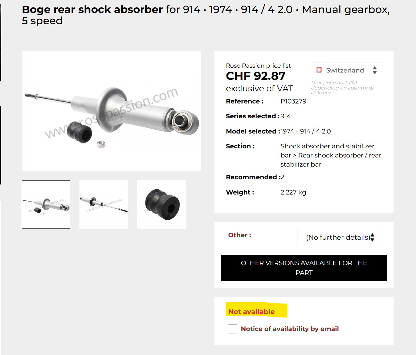

Real Boge's?? Didn't know they were made anymore. Look reasonably inexpensive too... Unfortunately, the rears are listed as out of stock...
https://www.rosepassion.com/en/diagrams-por...absorber-103279
I know AA has remanufactured both front and rear (further up in this thread). Shipping of a couple of rears to this side of the pond would be pretty expensive, and there is always the question if they even accept things with pressurized gas... @dr914@autoatlanta.com : you said above that they were manufactured in England... Any way to get them directly here in the "old world"?
EDIT: just found there are also front and rear KYB units available here… worth a try?

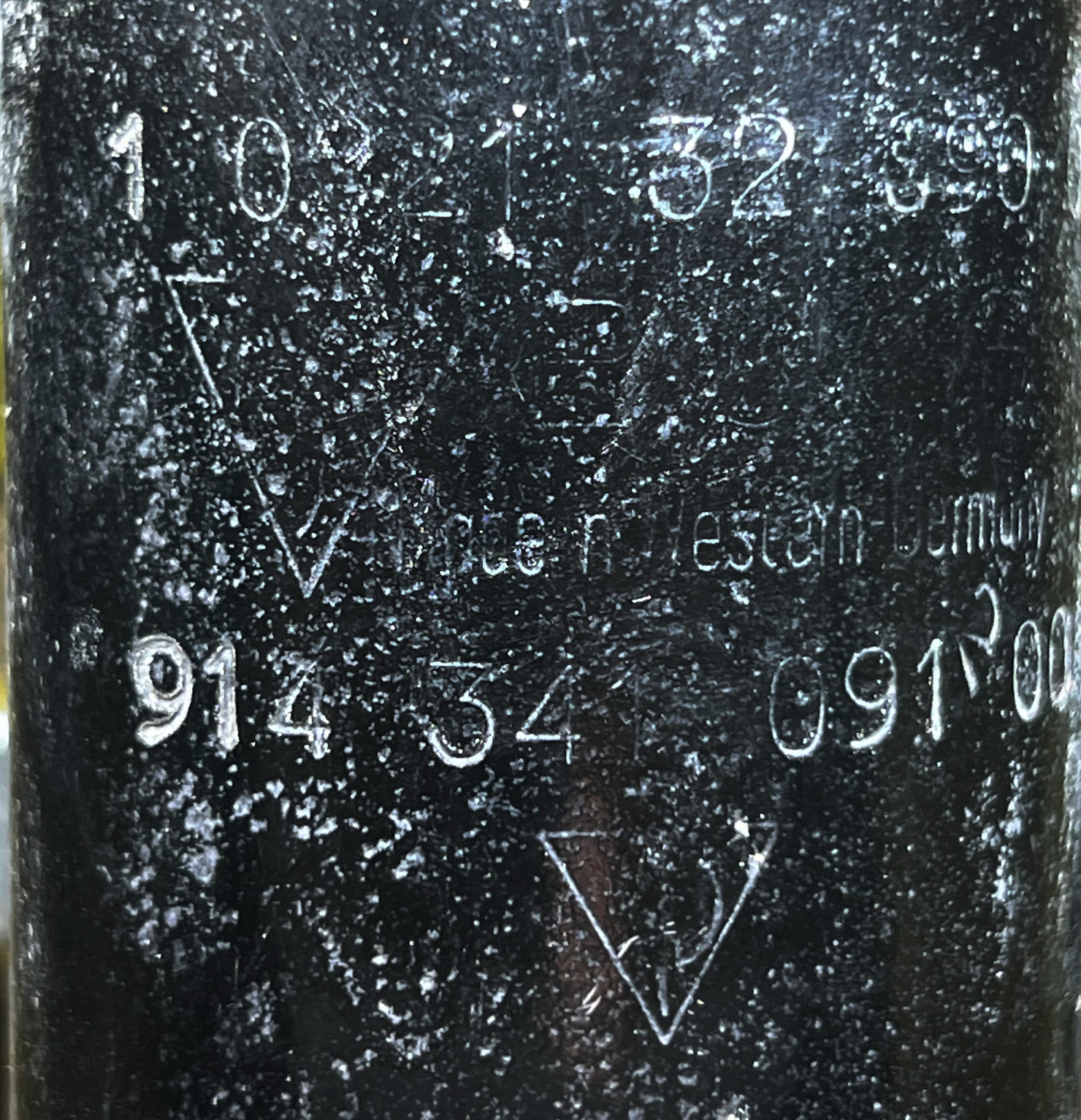

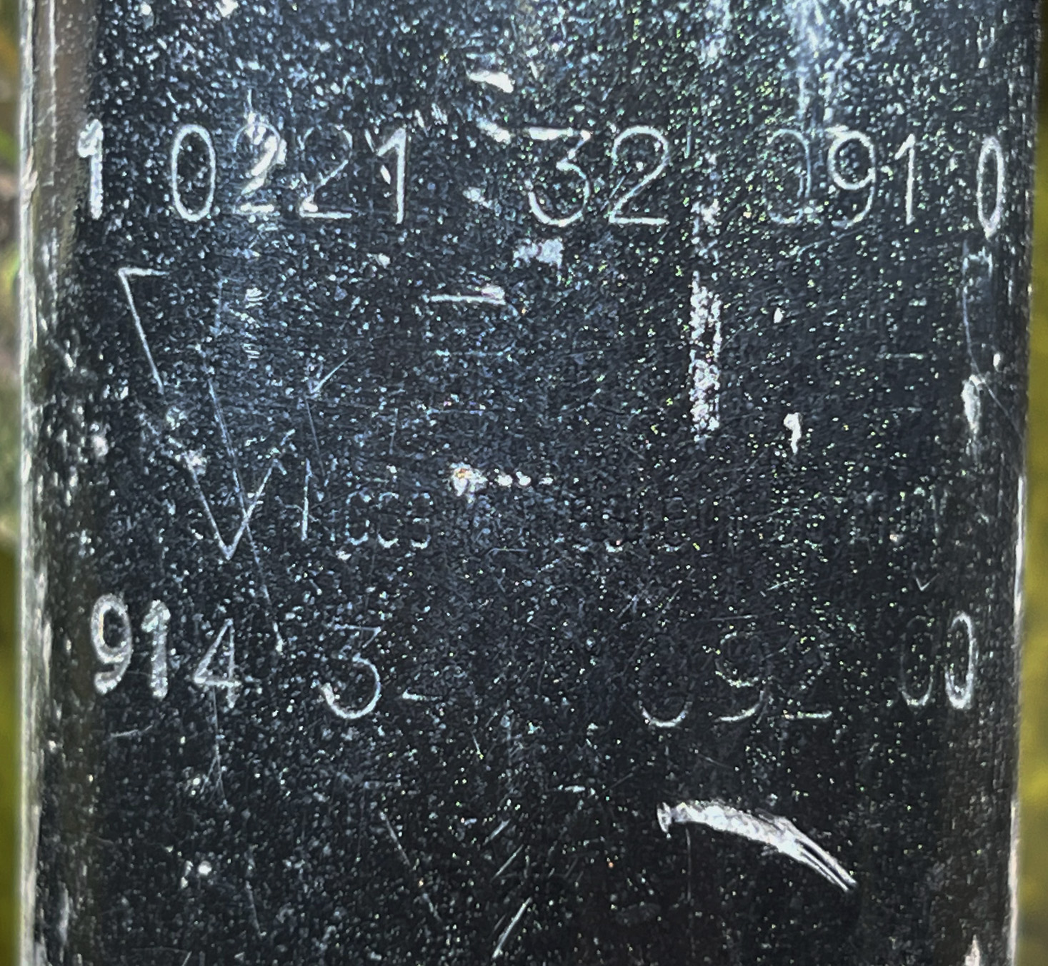

If the struts have been switched out, you need to figure out if they are Boge, Bilstein or Koni and if the caliper spacing is 3” or 3 1/2. Early 3” Boge 911 struts will take the same Boge inserts as a 914 but everything else is different.
The most practical way to tell if the torsion bars are bigger is to measure them. If they are 911/914-6 size, they are 1mm larger. That makes them stiffer but doesn’t automatically make them “harsh”.
So the first step is to figure out what you have so you can decide on the best solution.

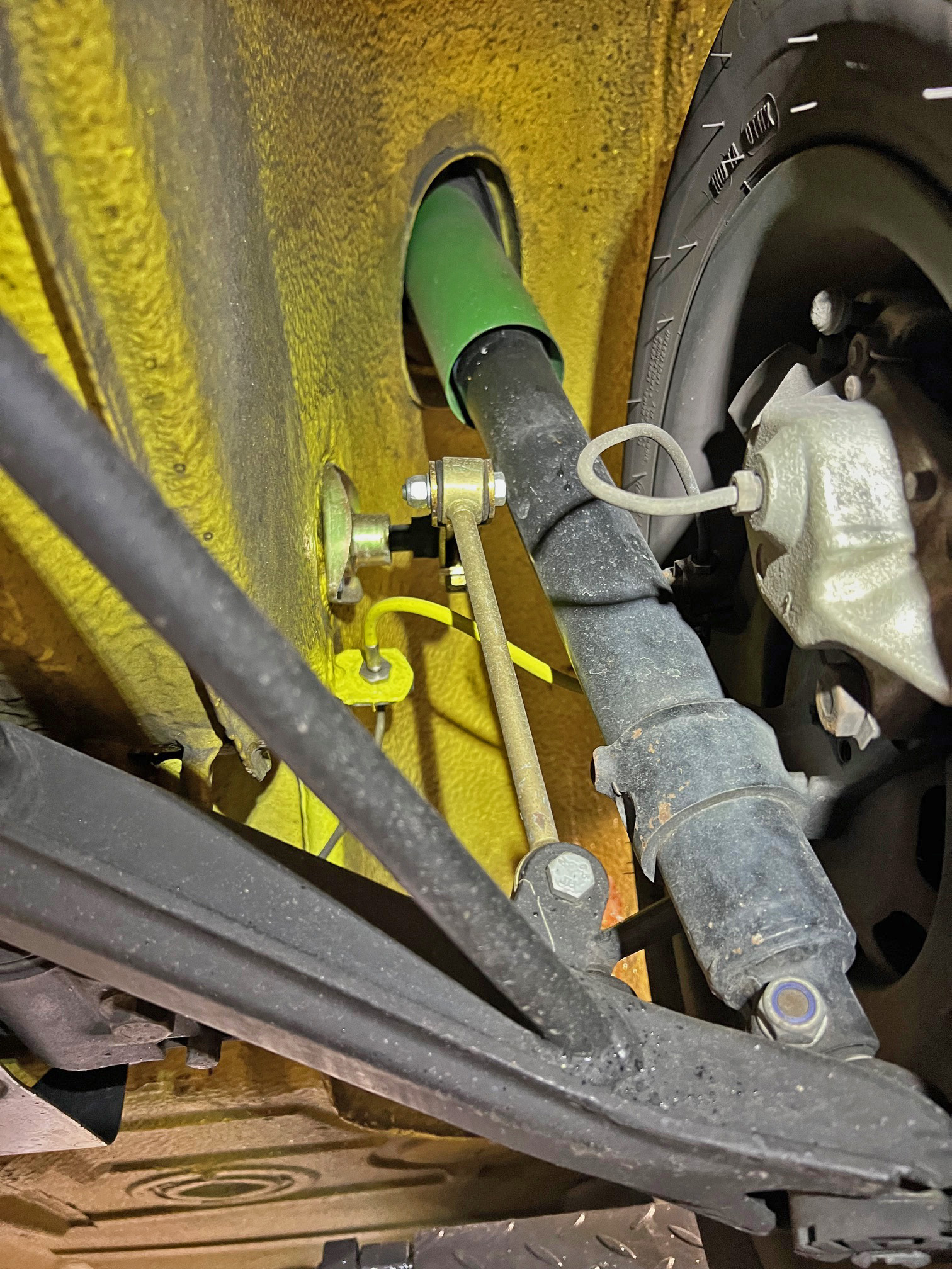

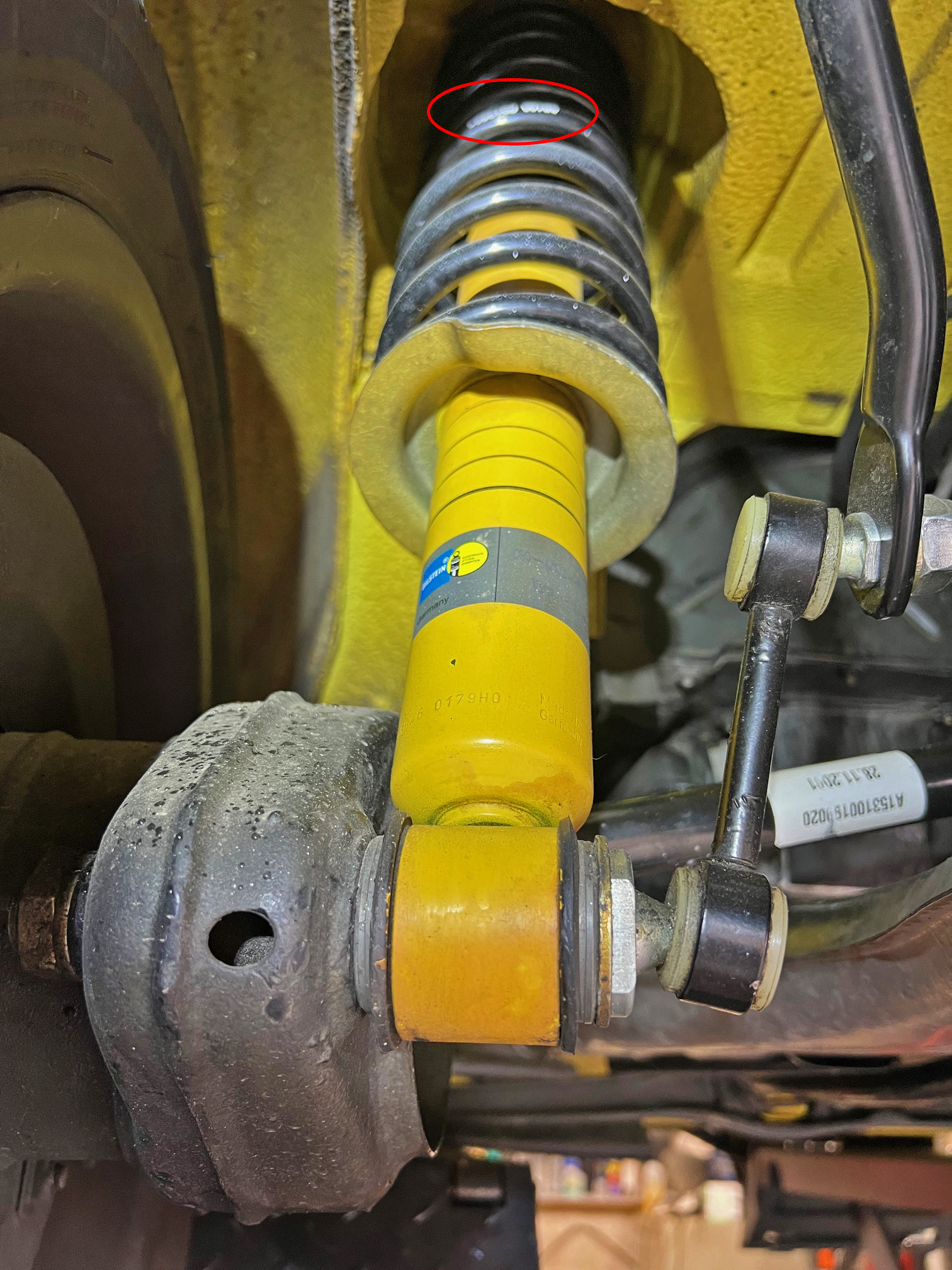

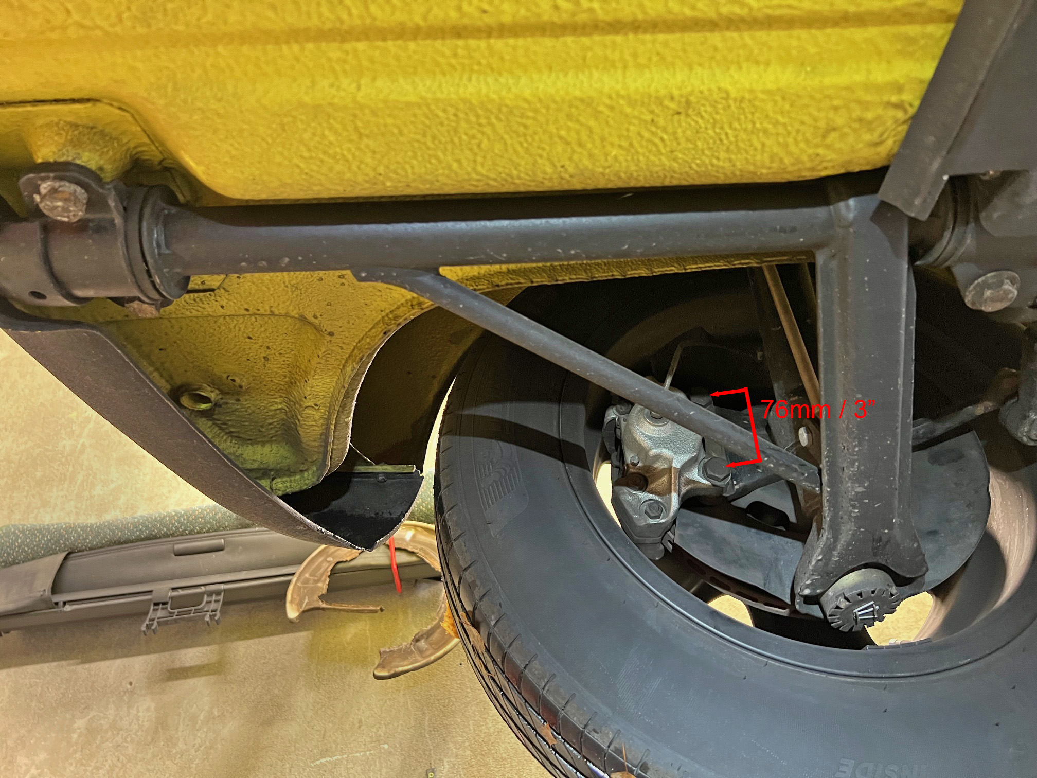

So, the bolt center to center spacing on the calipers looks to be around 76mm or 3", so older non-S 911 parts I assume.
Viewed from the front they look like this:
The green dust cap up top looks newer than the strut itself...

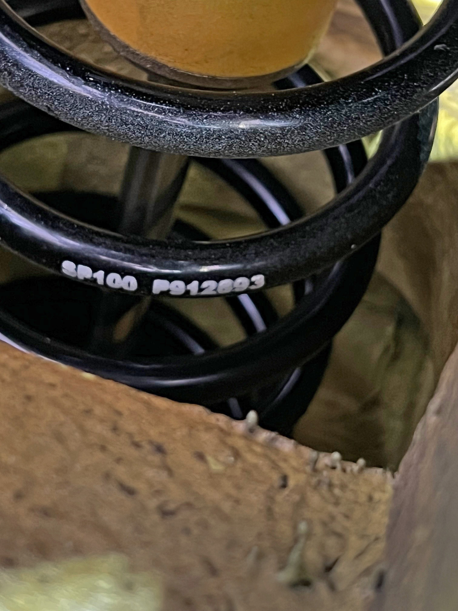

And I did actually find a marking on the rear springs...
Did a search for the number but didn't find anything right away, but I assume SP100 indicates 100# springs? (more or less stock... hopefully not 100Kg...) 912 parts?
Edit: AI is telling me they are probably aftermarket from Weltmeister.

It looks like the strut uses an early pinch bolt (large nut securing the bolt, split between the ends that secure the ball joint). If that’s correct, they are probably early 911T struts and probably Boge. Boge struts will have an embossed area halfway up the body with Boge name and part number. So long story short, if they are Boge 3” struts, Boge replacement inserts will drop right in. Easy to do at home. Jack up the side of the car, remove top nut on strut, drop the strut under the fender lip, pipe wrench to remove gland nut. Install is reverse but use a jack under the ball joint to raise the strut back into the strut retaining area on the car. Takes 15-20 minutes per side. No need to remove the entire strut from the suspension. Just be carrot the paint on the fender.
Personally, I would do the fronts and take it for a drive. You might not need the rears done. The front controls 75% of the feel of the car.
I could be wrong but the 914-4 rear sway bars were 15mm and 914-6 were 16mm. Not a significant difference in feel but if it’s a bar for a six, it’s pretty valuable compared to one for a four. At least to an owner of a real six. You can also disengage the rear bar and see if you like the ride. Using a rear bar isn’t mandatory on a 914. Some guys control the roll with just springs. Maybe a bit more understeer but it’s a common setup to just use a front. Easy enough to try it and see if it works for you.

re your springs. not sure 100 lb springs are original spec.
others here know more.
i have a vague recollection the originals were in the 50-60 ib range.
there is some figure in the factory manual which is in kp.
seem to remember something about three different strengths.
but can't remember how that worked. someone here would know.
i reused my original springs. seems to be working ok with the B6s i put in 5 years back.

Yes, the manual has 3 different values from 220-240 Kp - those are minor differences, possibly to keep springs matched due to manufacturing differences at the time.
60 pounds/inch is about right... Here is the calculation I infer from the manual info
Spring free length=471mm
The 220-240 Kp value is measured at L1=239 - from that I infer that the spring is compressed to that length to measure. That means a compression of 471-239 = 232mm or 9.13"
240Kp*2.2=528 lbs force at a compression of 9.13"
528/9.13 = 57.8 pounds per inch.
Hope i got that calculation correct.
wonkipop

out of interest i just did a calculation on the rear boge shocks screen grab you posted above.
1 swiss francs currently = $1.90 aud. so cost would be $176 aud for each shock.
+ GST 10% payable when its landed in aus. good as $200 aud. + freight. thats a stab in the dark. but given its heavy-ish. wild guess. $50.00 aud.
so i'd be looking at around $250 aud per rear boge shock.
not too much different to billstein. maybe $100 cheaper but that depends of freight. though i have not checked bill prices in aus currently.

QUOTE(mepstein @ Nov 2 2025, 01:14 PM) *
If the struts have been switched out, you need to figure out if they are Boge, Bilstein or Koni ...
OK, so the first thing I did was look for the part number on the struts - which was more or less where you said it should be, but of course facing outward. So I pulled the front wheels off and tried to read the numbers... A bit hard because I think the struts may have been painted over once. With the help of the phone camera - which sometimes sees more than the naked eye - and some oblique light and chalk, I got most of it...
So, from what I can read:
Left side -
1 0221 32 090 0
914 341 091 00
Right side -
1 0221 32 091 0
914 341 092 00
Those numbers do not correspond with the Porsche parts catalog numbers I have here, which show
914 341 081 02 (up to '72, right side is 082)
914 341 081 05 (after '72, right side is 082)
And then there are those triangles you see in the photos... The Koni logo is triangular. So, maybe Koni replacement struts? Or what?
Aslo, looking at the parts diagram, the A-arms are separate parts from the struts. So might it be possible that they are still the original 914 parts with the 17.9mm torsion bars, or would they necessarily have to have been changed to 911 parts to go with the struts?
Always an interesting "archeological dig" to try to figure out what is really on/in these cars...

QUOTE(chmillman @ Nov 3 2025, 05:46 AM) *
Left side -
1 0221 32 090 0
914 341 091 00
Right side -
1 0221 32 091 0
914 341 092 00
the triangle things are porsche logos.
triangle with a P inside it (a stylised P).
this is what i understand that to mean.
its a production line part.
the sigla windscreens when fitted on production line had the triangle and P.
the kinonglas windscreens had the VW logo (and later VW and audi rings).
along the way the cars had either sigla screens or kinonglas depending on the batch - months of year basically. but the big difference between production line installed parts and then later spare parts is the vehicle manufacturer logo.
after the production line fitment, replacement OEM parts just had the supplier logos or names. but no longer the vehicle manufacturer logos.
i still had orig boge shocks and struts on mine in 2019 when i recommissioned.
cleaned them up a bit and put the bil inserts in at the front.
all they had were the date stamps on the struts.
date stamp was 1 week before the VW production number stamped on the chassis and k plate. nothing else. struts 22 jan. car chassis stampe 28 jan.
EDIT.
so what i am saying is if its got the triangle with P that alone means its very likely unless the struts came from some other car that its the orig production line fitted front struts.
the other empty triangle might well be a koni symbol i don't know.
and its got a 914 first three digits part number. so its 914 specific.
and konis were not standard production fitment. you had to tick a box to get them.
you can see from my photo the bog standard boges.
not much on them. just the date stamp. i could look again closely at mine.
but i don't think there is anything else there. no boge logo. no vw logo as far as i have ever been able to detect. maybe there is and i can't remember but the date stamps caught my eye. i cleaned up of stray undercoating and kept clear of those date stamps and then reinstalled.
anyways. i think you might have original struts. koni option ticked. (IMG:style_emoticons/default/confused24.gif) (IMG:style_emoticons/default/biggrin.gif) (IMG:style_emoticons/default/beerchug.gif)
