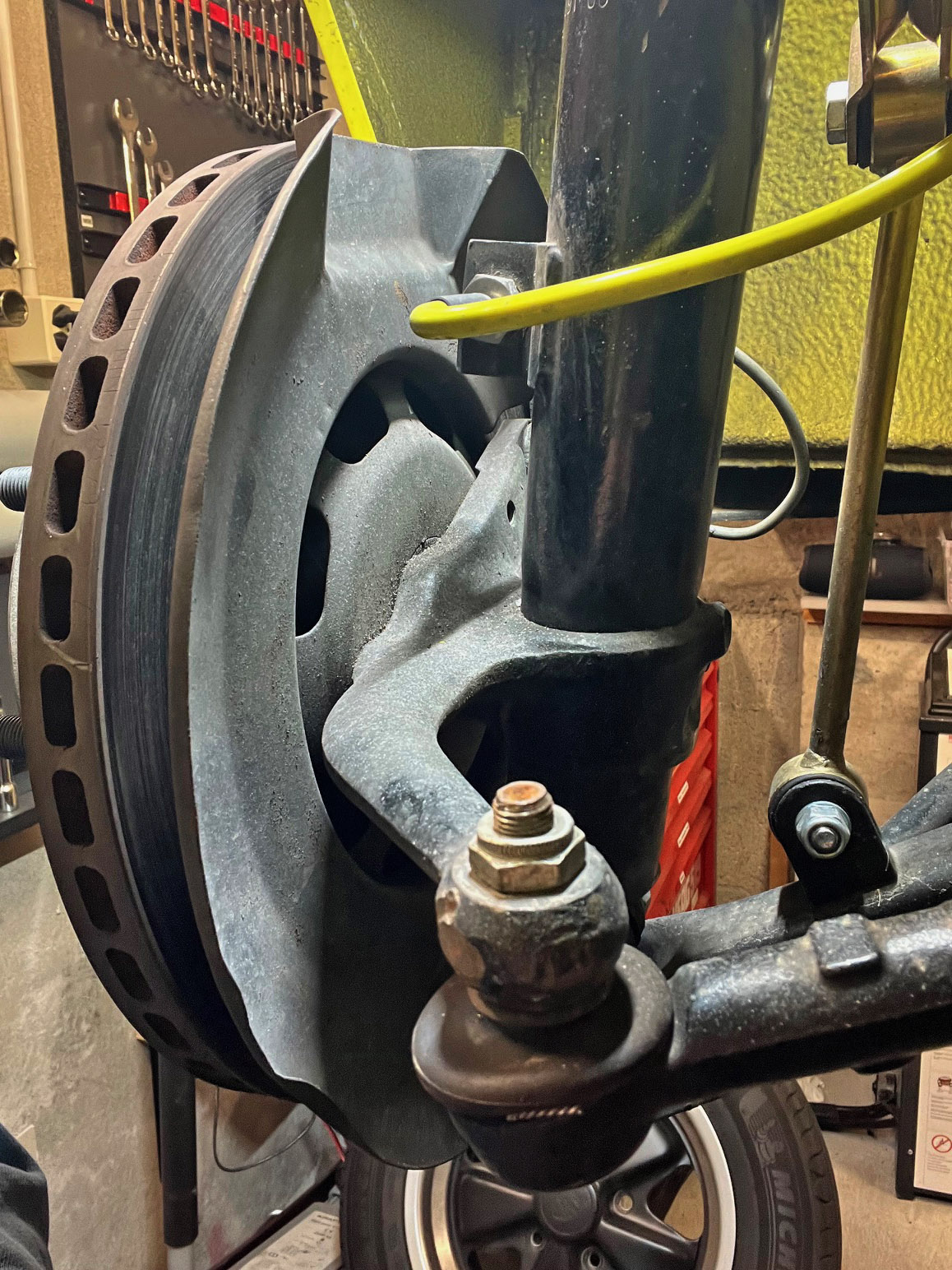

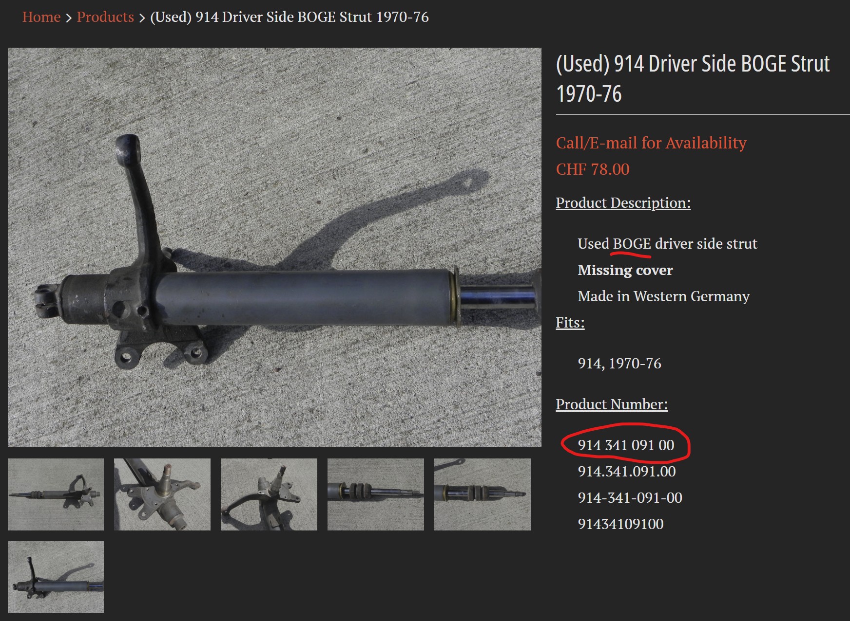

Well, not according to the image above... I have the same parts catalog.
72 and up left side is listed as 914 341 081 05 (082 right side)
Mine are 914 341 091 00 (092 right side)
Interesting, I found a used part for sale at AASE which has my part number and says it's a Boge strut...
What's most important here is what kind/brand of shock insert will fit in them to replace the BBB's (Bone-Breaking-Bilsteins) ?
Edit:
More searching under that part number gives me all sorts of references for the inserts - not the strut itself. So, is it possible that the number on the outside indicates the insert to be used?
Edit #2:
Ahh, and this found on PMB's website:
914-6 Struts are simply 911T struts in all measures. The odd thing is they come with a 914 part number. That said, don't be confused; the 914-4 strut is quite different. One clue is a straight steering arm on the 914-4 version. Another is the smaller spindle. Yet another is the 16mm "coarse" thread (16x1.5) rotors attachment nut vs. a 16mm "fine" thread (16x1) attachment nut for the 914-6 and 911 versions. If the odd chance (they're not that common) you have 914-6 struts, you're good to go. Part number for the -6 struts is 914 341 091 00 and 914 341 092 00. Again, they are otherwise identical to the 911 version. Again, a "guess" would have it that these had to have 914 part numbers to be assembled as a complete unit into a 914-6. That "unit" (which would consist of the strut, inserts, hubs, rotors, backing plates, balljoints, a-arms, etc...) would basically have no other part numbers on it. Having the 914.341.xxx.xx number would signify that that "unit" had the proper 914-6 17mm torsion bars with the 911 spline count.
Wow... they're really -6 struts?

@chmillman
interesting. i see what you are saying
its also engraved with bilstein as well.
here is a thought.
looking very closely at parts catalogue i notice something else.
there is no listing for the 914-6 as applicable car in listings to right.
this could be a typo omission - would not be first time.
and all they are really listing is the boge components.
but bilsteins and konis were definitely options, right through production.
for 4s and 6s.
something else to bear in mind is that whilst changing the shocks as normal maintenance involves simply buying the insert whether boge or bilstien (or i am guessing koni) i dont think thats how it would have been done on the production line. i could be wrong but i think they would have been ready to go so to speak as a complete component.
the production line workers i think were unlikely to have been inserting the shock into the strut.
i reckon the strut came complete from boge or alternatively bilstein. or koni? already fully assembled.
i am going to guess that my strut will be engraved with 914 341 081 or 082.
i won't go so far as to say it has 05 on the end ofr it like the parts manual says.
those last two digits are the superceding part number. and 05 could be last itteration which is not necessarily what went on in 73 or 74. could be. but not necessarily.
usually what happens in these catalogues is the final itteration that fits all the cars as a spare part is listed.
but i will bet the parts number faces the wheel like yours and makes it pretty hard for me to see at the moment.
out of that i think that the 081/082 becoming 091/092 is to identify the struct with bilstein insert as a production line item.
and i wonder if there is a further number for the koni equipped strut.
reason i say this is i know a B6 goes straight into a strut that i know was originally equipped with a boge insert. they were the originals i pulled out of the car in 2019.
so i know the insert goes into that strut. either of the inserts.
something like that must be the explanation.
there is certainly a few missing listings of parts there in that section of the catalogue.
i have found similar missing listings for some L jet parts.
but some of those i found scattered in other sections of the catalogue far away from the EFI components groupings.
its possible these alternative shocks are elsewhere in the catalogue in a not so obvious place - because they were options?
EDIT
i am guessing the top number 1 0221 32 090 0/091 0 is a bilstein part number?
sixnotfour

@chmillman
AASE bros ad you posted is up the creek.
thats a 6 front strut they are advertising as a 4. (IMG:style_emoticons/default/biggrin.gif)
rest of description is right. takes a boge (originally). its got a bent steering arm. (IMG:style_emoticons/default/biggrin.gif)

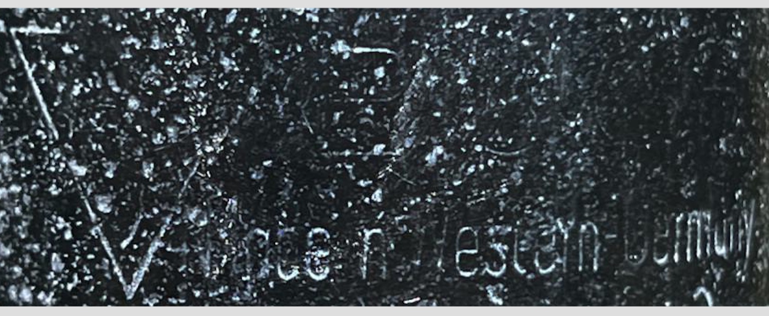

QUOTE(sixnotfour @ Nov 3 2025, 05:36 PM) *
EDIT
BOGE manufacturer number ?
Looks like it in this pic....
matches chmillmans when you blow up his photo for markings.
can just see boge and the big triangle is the boge trademark.
all a bit faint and barely there on his.

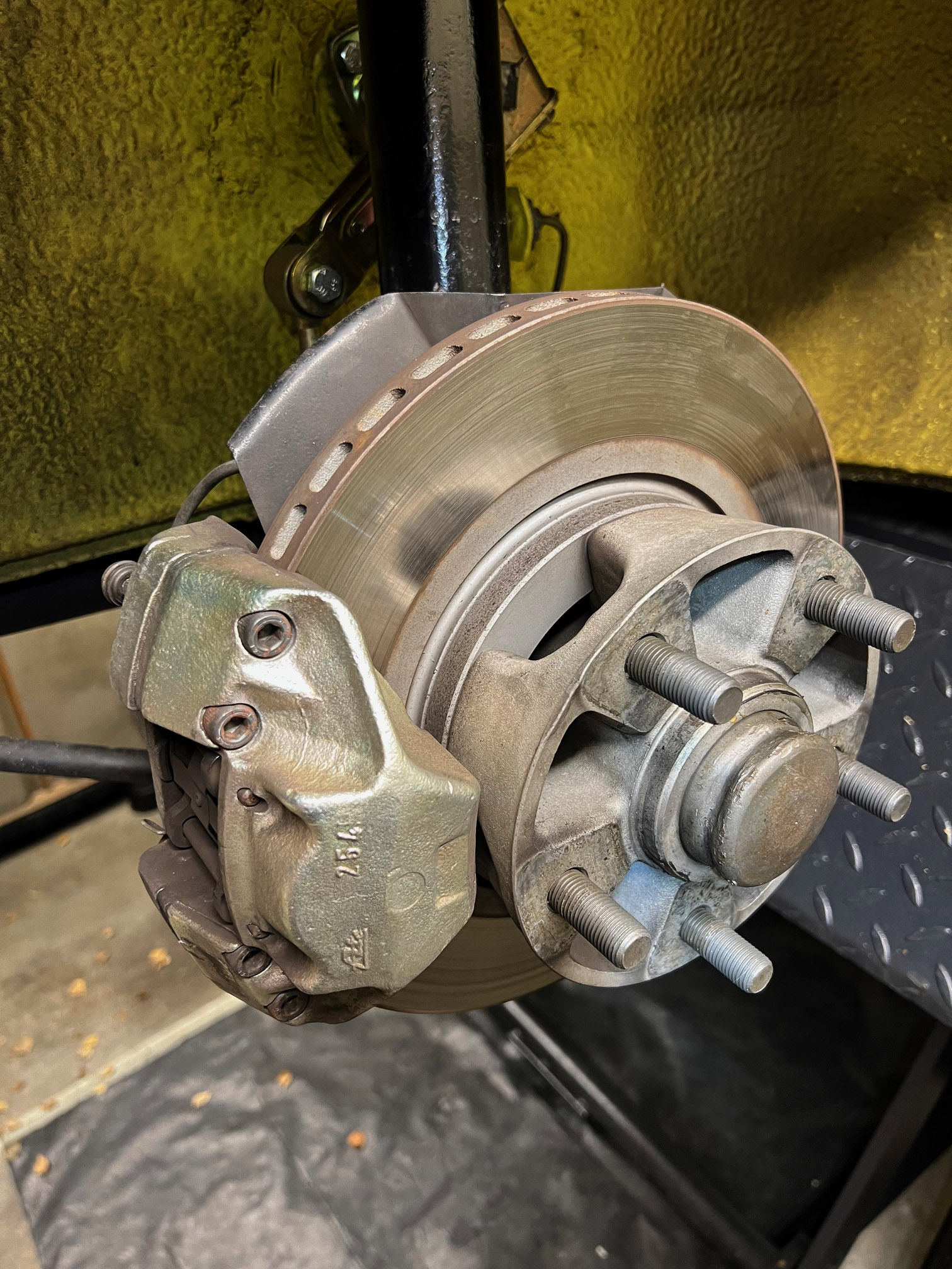

given the rest of the description e shea lists out yours must be running 5 stud conversion? - done proper? with /6 hubs? and real 6 struts with bent steering arm? arm is to do with the track width.
Yes, "real 5-stud conversion". One of the reasons I bought the car, because it already had that, plus the lovely real Fuchs black center 7x15 wheels.
Thanks to all who contributed to this thread! (IMG:style_emoticons/default/beerchug.gif) (IMG:style_emoticons/default/first.gif)

Back in here because the “Boge” front inserts advertised by a seller here turned out not to be Boge after all, after asking for more details, they said they are actually Kayabas (KYB). Excel-G’s, supposedly OEM spec. Anyone tried running those? I have had good experiences with their Gas-A-Justs iin other cars - but only standard shocks, not strut inserts.
