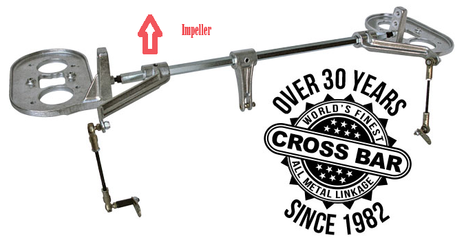

@Barefoot I am a Dellorto fanboy. Here are my questions. What type of sync tool are you using snail or unisync? Do you have a center pull linkage, cable linkage, or a hexbar or similar? post pics of the linkage to the throttle lever.
What Is your idle speed and is it stable? If you idle is stable, pull you plug a plug wire and make sure the idle drops. replace it and then test each cylinder. Let us know. At stable idle, are all of the carb throats Kg/hour of air the same? How many air bypass screws are fully seated? When were the valves last adjusted? Do you know what cam is in the car?

@Barefoot I will PM my contact info to you and some initial questions and instructions. It will make the process faster and we won't be bumping this thread. I attached a picture that shows how I believe the linkage is oriented as you look into the engine bay from the driver side.
