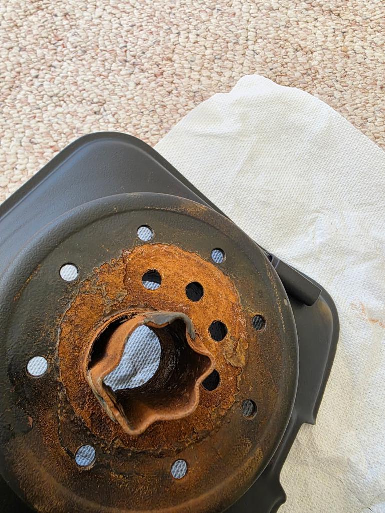

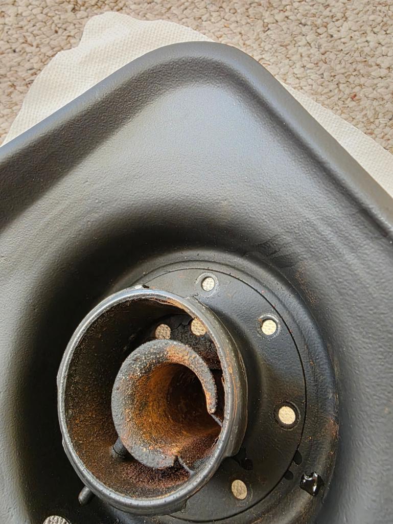

A few years back, before repro units were available, I had my tank restored with a process called Gas tank Renu. At the same time, I had the fuel filler assembly blasted and powder coated.
Last week, as I went to add fuel for first Summer jaunt, I noticed lots of rust and flaking in the fuel filler neck. I just removed that as I was also concerned if tank sealant had failed.
Good news is that the tank sealant remains rock hard. Bad news is that The filler is worse than I first noticed. I will definitely need to clean out some of the crud from that which is now in the tank.
I think the fuel cap spring may not have helped the filler neck coating. Is the spring even needed?
Attached are photos of filler assembly. I can blast it again, but then what? Should I try having it powder coated again, perhaps it was done poorly last time. Should I instead paint it with an epoxy based paint? Other?

It's possible the gas fumes damaged the powder coat.
If you blast it again, maybe try paint instead?
Also, did you put a new gasket between the filler and the tank?

Oh boy, you can tell the fuel ate away the powder coating.
Would get that blasted again and just use some regular paint that holds up against fuel.

here's an off the wall question
do you use pure ethanol fuel?
