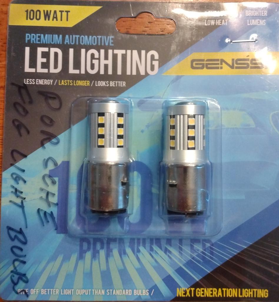

Got these on AmazonAttached Image Attached Image

be careful. i believe the fuse for the driving lights is 8 amps. 100 watts @ 12v is 8.3 amps

I installed a 10 amp fuse.

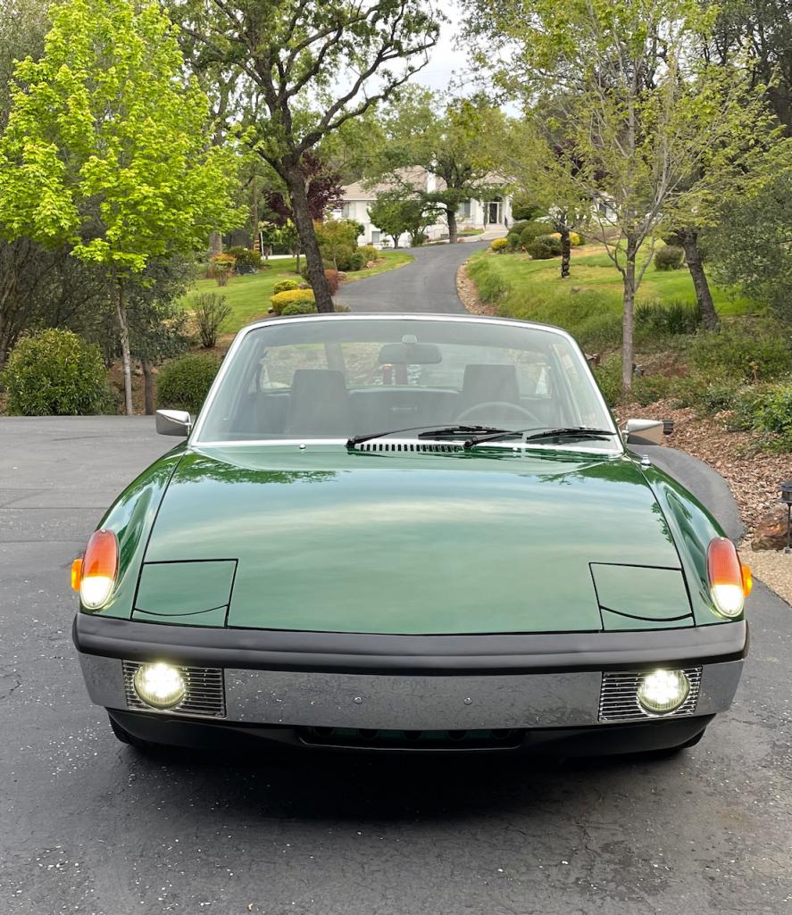

I have Jerry's (Spokeworks) LED driving lights in my car and I love them. (IMG:style_emoticons/default/beerchug.gif)

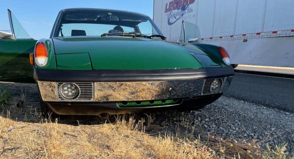

Are these installed in factory fog light housings with a factory fog light lens? Driving lights lenses , cornering lenses, and fog light lenses have different light patterns.

(IMG:style_emoticons/default/agree.gif) I have the Pilot driving lights and happy with them ,they are legal here also ,LED lamps are illegal unless they are standard fitment from new which they weren't on a 914 ,cheers

I suspect the 100 Watts refers to the equivalent output rather than the actual power draw. That seems to be pretty typical in the LED world because people are used to buying bulbs by wattage rather than lumens. YMMV
Also be careful installing a larger fuse without checking the ampacity of the wire in the circuit.

^^ What Jim said. Likely 100w output for both bulbs combined, so really about 10w each in electricity like house bulbs. Best to measure them though, but will be way less than incandescent due to led efficiency.

Thanks for the replies. The active word here is H3. Euro-spec cars came with H3 halogen bulbs for the driving/fogs and H4's for the non-sealed-beam headlights. Not the same base as BA20 shown in the pic above.

Here are the Spokeworks LED fog/driving lights in my car. They use the stock housing, lens and clips.
