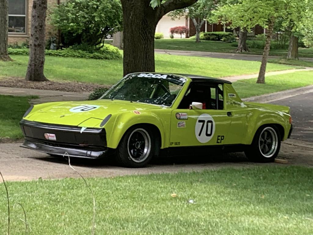

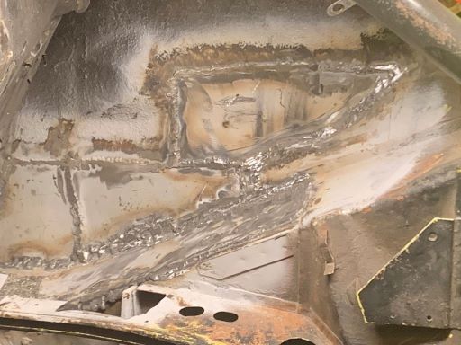

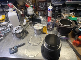

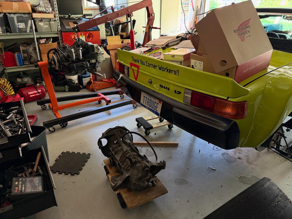

Just figured to share the progress I have made over the past few months.
Primarily an engine refresh and some remediation. Good news is I'm ready for a Test & Tune this Sunday and should make it back to the races a week after.

Not a great look a week or so before Waterford Hills Vintage Event
FastFroggy
post Jul 15 2025, 02:15 PM
Posts: 78
Joined: 27-November 15
From: South East MI
Member No.: 19,415
Note, low tension piston rings no workie
