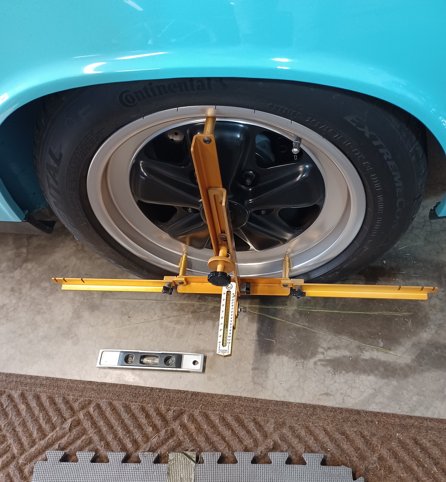

This winter I installed Koni Adj strut inserts in the front, and just left the alignment settings where they were at.
I borrowed a buddy's Camber/Caster gauge and decided to fine tune things today.
Started out putting 185lbs in the drivers seat. (my weight) and then set the ride height all around. putting the front A-arms at level.
Then went about checking the Camber. on the front they were only slightly different, So I set them both at -3 deg camber. Caster seemed OK at 6 deg. so I left it there.
Rear camber is -2.5 deg (2. 30min?) on the right and -2.62 (2.37min) left. I really don't want to mess with this.
It seems to handle pretty good. Is that too much front camber for a street car? I'm not really too worried about tire wear.

Olympic 914
post Jun 20 2025, 09:11 AM
Posts: 1,772
Joined: 7-July 11
From: Pittsburgh PA
Member No.: 13,287
QUOTE(dr914@autoatlanta.com @ Jun 19 2025, 01:40 PM) *
3 degrees neg in the front is outrageous, besides hard steering slow cumbersome turn in, like you said the tires will wear out., There is NO benefit what so ever setting the camber that neg. zero is standard, 1/2 a degree if racing
Outrageous... (IMG:style_emoticons/default/blink.gif)
Ok I was expecting a couple dissenting opinions.
I have driven the car this way for a bunch of years, Many times on the Dragon and on the winding roads in SW Pennsylvania. I always thought it handled just fine. Driving friends 914s with skinnier tires. I felt they handled a bit lighter, maybe more nimble.
I simply attributed it to the difference in tire sizes. I am running 205-50/ 16 fronts and 225-50.16 rear. on 7+8" wheels.
Since I still have the tool, I think I will knock back the camber a bit, and see how it does.

Full disclosure...
Its not at -3deg. Whenever I would make adjustments the Zero would change. Just tapping on the strut would do it.
The gauge has a factory set "0" but can be adjusted for a not level surface. Since I did it in my garage. There is a slight slope towards the center drain.
It seems that the tires flexibility would compensate for a little bit off.
After another round of measurements, it turns out that I can't get more than -1deg on the right but have more adjustment on the left.
The car has been in a couple accidents, nothing serious but maybe enough to affect the adjustment.
The guy I borrowed the gauge from had similar issues and stated he just got it close enough to drive it around until he got it professional aligned.
I got it as close to equal on both sides as I could. It's more like -.75 now.
