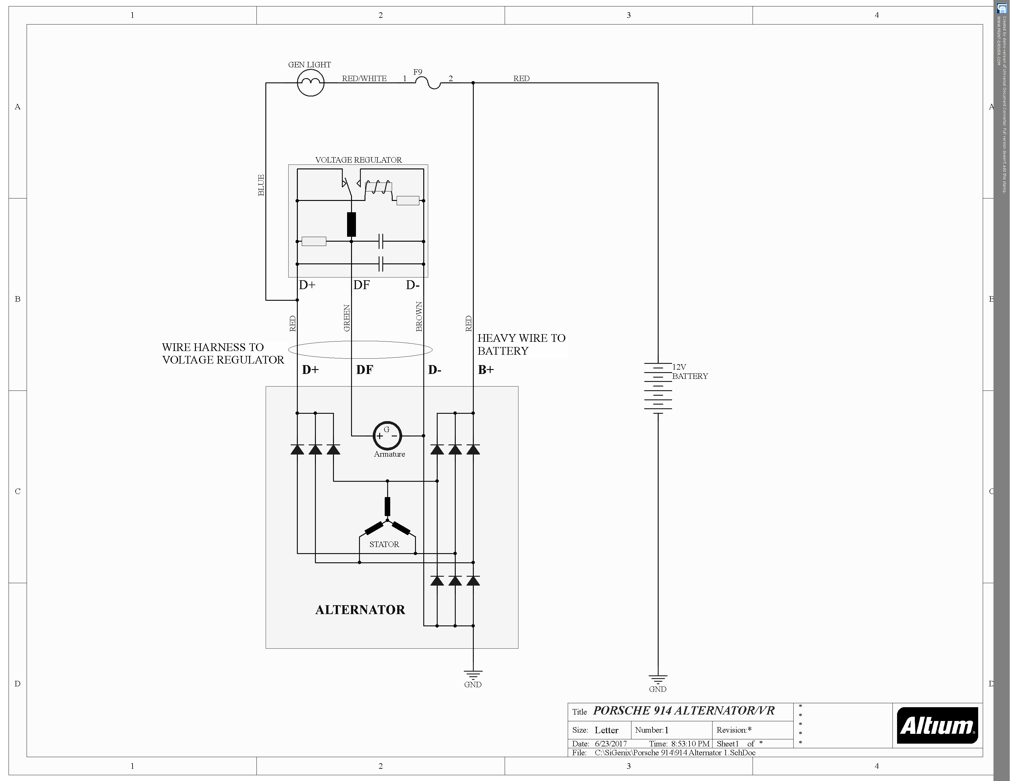

If the GEN light doesn't come on with the key ON it is likely your alternator is not operating regardless of RPM.
Below are the alternator connections for the 914/4. The /6 is schematically the same. The GEN light provides enough current to the voltage regulator to start the alternator.
Pull the bulb and check to make sure it is good.
If the bulb is good, with the bulb carrier still out, turn on the ignition (don't start) and measure the voltage on both sides of the bulb to chassis. You should have battery voltage on one side and less than battery voltage on the other side.

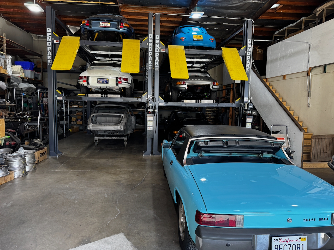

Wrapping this up - the great guys at Scott's Independent in Anaheim have found an issue with the recently rebuilt alternator that was installed just a couple of months ago. Some corrosion on the inside for some reason.
No matter the cause, a new/rebuilt alternator has been fit and it's good to go. Pick it up in the morning. Hopefully, that's the cause and the fix!
Side note - Scott has a beautiful 73 2.0 914 in Olympic Blue...just like mine in the midwest! It's a great shop.
