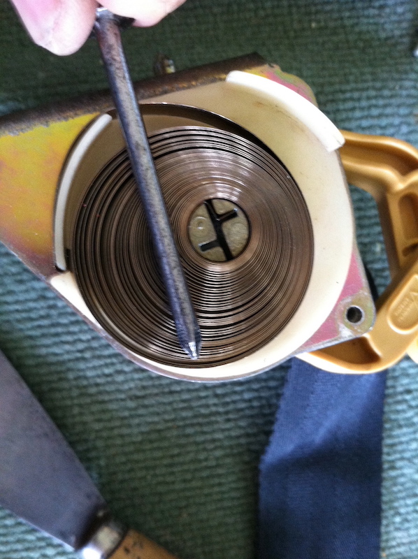

I have taken the sides off the seat belt. A really horrible disaster. Had to go to Seatbeltplanet.com to get a new seatbelt. The spring inside the housing was impossible to put back correctly.

I was able to reassemble mine and have it work but it took a little patience. I did end up buying new ones from seatbelt planet though since even after cleaning and lubing they still didn't retract like I wanted.

I took mine apart and had the spring explosion. Was able to get re-wound OK with some patience .
Just be VERY careful taking the over off (IMG:style_emoticons/default/blink.gif)

It's very tricky to get the belts to extend when they're out of the car! The retractor has to be perfectly vertical because the pendulum inside is designed to lock the belt under fore and aft acceleration/deceleration.
BTW, the edge of that spring is pretty sharp. Had to throw away the gloves I used when putting it back in because they were sliced to ribbons! I may also still have a couple of scars...
