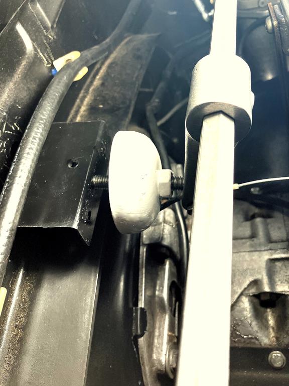

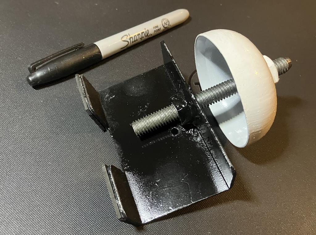

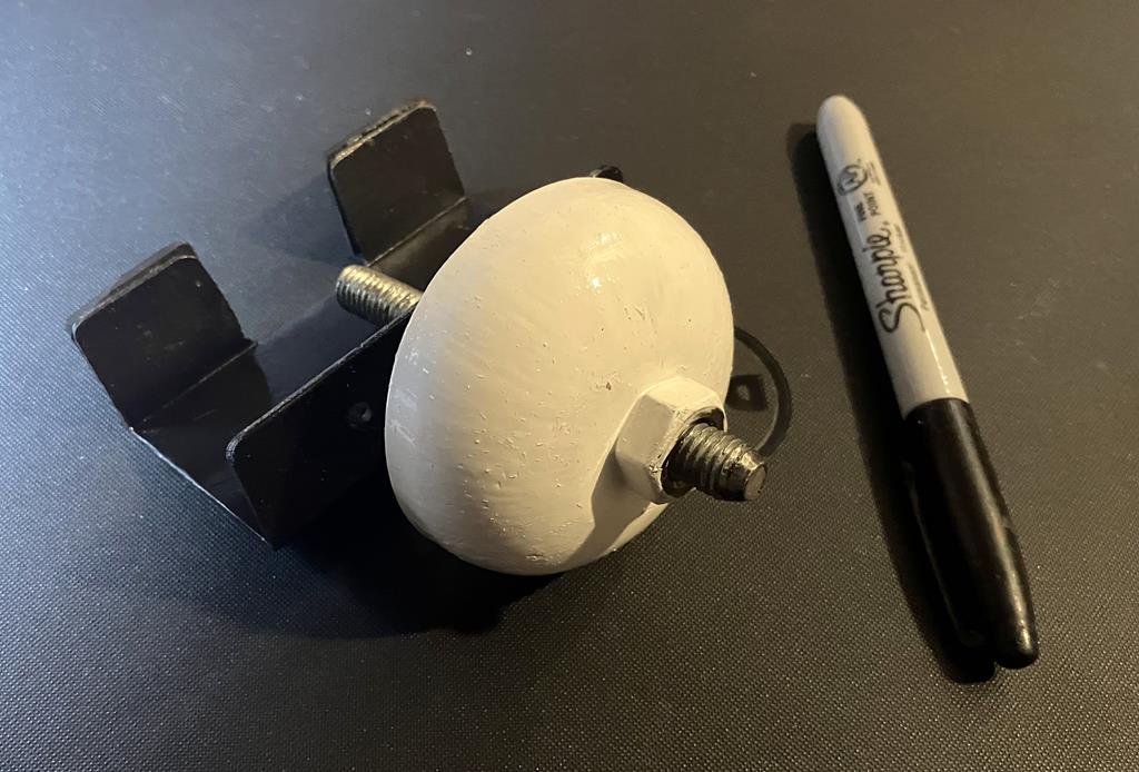

Using scrap pieces laying around I devised this tool to adjust and hold a throttle position while balancing my carbs with two snails. I simply wedge the tool between the rear firewall and the hex linkage pivot point and adjust RPM by turning the white bell-shaped piece. I can adjust and hold RPM hands free from idle to full throttle.

NARP74   Very Nice! Necessity at work again.   Jun 24 2025, 03:10 PM
