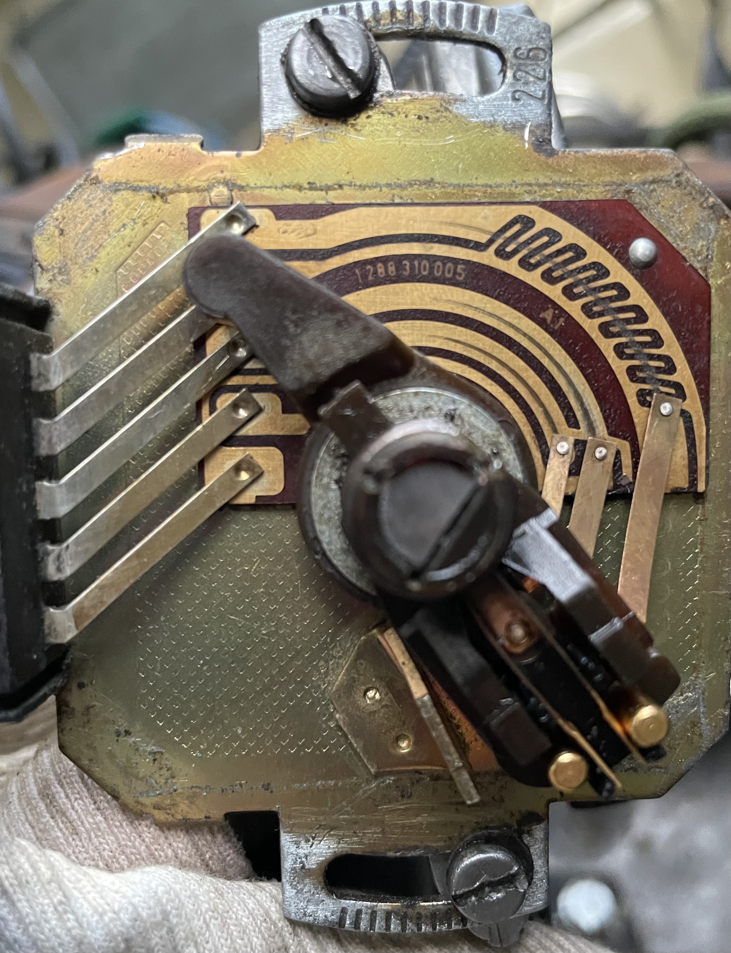

I messed with attempting to configure my TPS before installing my replacement TB last week. Here’s a pic of how mine lined up:

Did you set the TPS according to the instructions? You need a multimeter for that. Super easy but fiddly. Off hand, having it maxed out like the picture seems to be a doubtful position.

That TPS board is worn out, should be replaced.

You should at least use an eraser on that tps
