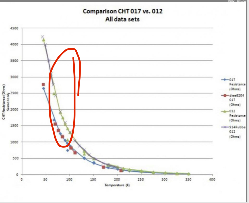

I'm actually so frustrated with this right now... I get a different resistance range every time I check the CHT. Batteries have been replaced in the DMM.
The other day (the last time I checked) resistance was around 2300 ohm .. hey that's close to what it's supposed to be - I'll go ahead and re-install. Go to do that today and we're around 1600 ohms (IMG:style_emoticons/default/headbang.gif)
So - I guess the best thing to do is order a new part.

Not sure if you should run off to that. Just put a pot in line replacing the cht. Set it to whatever it should be as cold. If you think it is nefarious signals from the cht that will tell you right away
Easy man - chill. You’re getting too stressed.
That region of the CHT has a very steep slope to the curve. If you’re holding the sensor in your hand to measure, it’s going to warm up in response to body temperature and resistance will decrease rapidly. Even just exposing it to hot air temp could be affecting it. What the temperature there in Texas today - probably 120F in the shade? (IMG:style_emoticons/default/barf.gif) See circled region below.
This region only affects mixture at startup and has no relevance to running temperature and mixture at operating temp.
Not saying you can’t have something going on with corrosion in the sensor, the wire, or even with your DMM but I wouldn’t be freaked out by what you’re measuring.

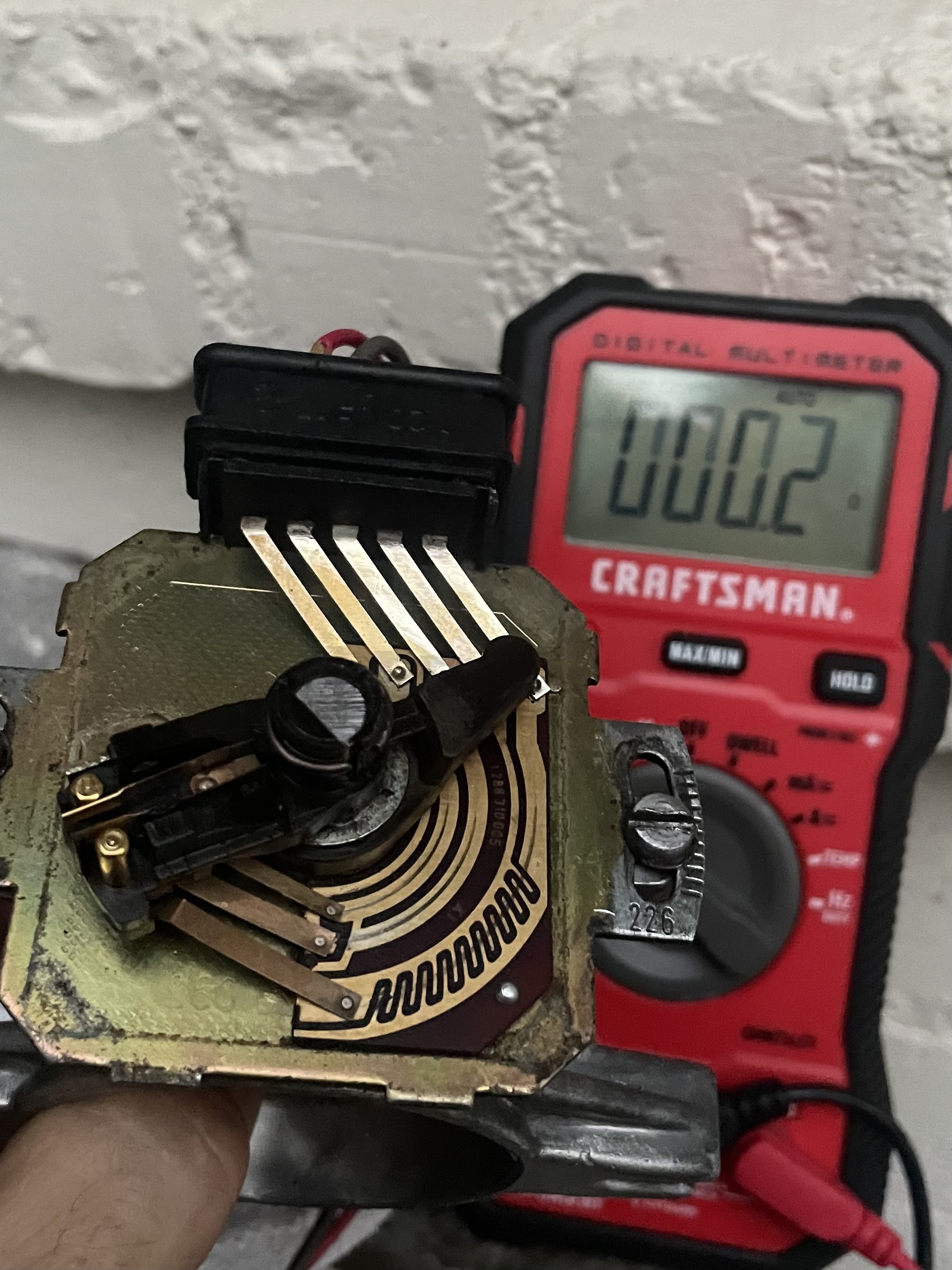

.. Also, don't discount that TPS. If your ECU doesn't know you are at idle all kinds of badness could result.
BTW, here’s a shot showing where I locked my TPS down. I did it as close to the instructions as possible but the ohm meter jumps around like crazy and it’s very hard to be consistent - maybe that’s just the characteristics of a TPS that could stand to be replaced though. Also Zero ohms could technically mean 0.9 to 0.1 I suppose, so I'm hoping 'close enough' - like I said, the car pulls well. Idle correction/perfection is the issue though.

I've lost track of things in this thread. IIRC, Your first post said the car idled at ~900RPM, later you said 1100RPM and the idle adjustment screw on the TB is all the way in. AFR showed 16+ at idle and at cruise. You are experiencing some backfiring and TPS may be in question because you can't zero it out at idle.
Going back to the first issue of the high/inconsistent idle, I'm betting that you're TB needs a rebuild. I had both a high idle and an inconsistent idle (I'm not talking about surging) until I had my TB rebuilt.
Your AFR readings seem a bit suspect. If the mixture is wrong then that could account for your backfires.
You should be able to get the TPS to O Ohms. If not, it may impact your ability to get a steady idle, especially if the signal it's providing the ECU is constantly fluctuating.

Grab an eraser and clean the contacts. That position looks more like mine now.

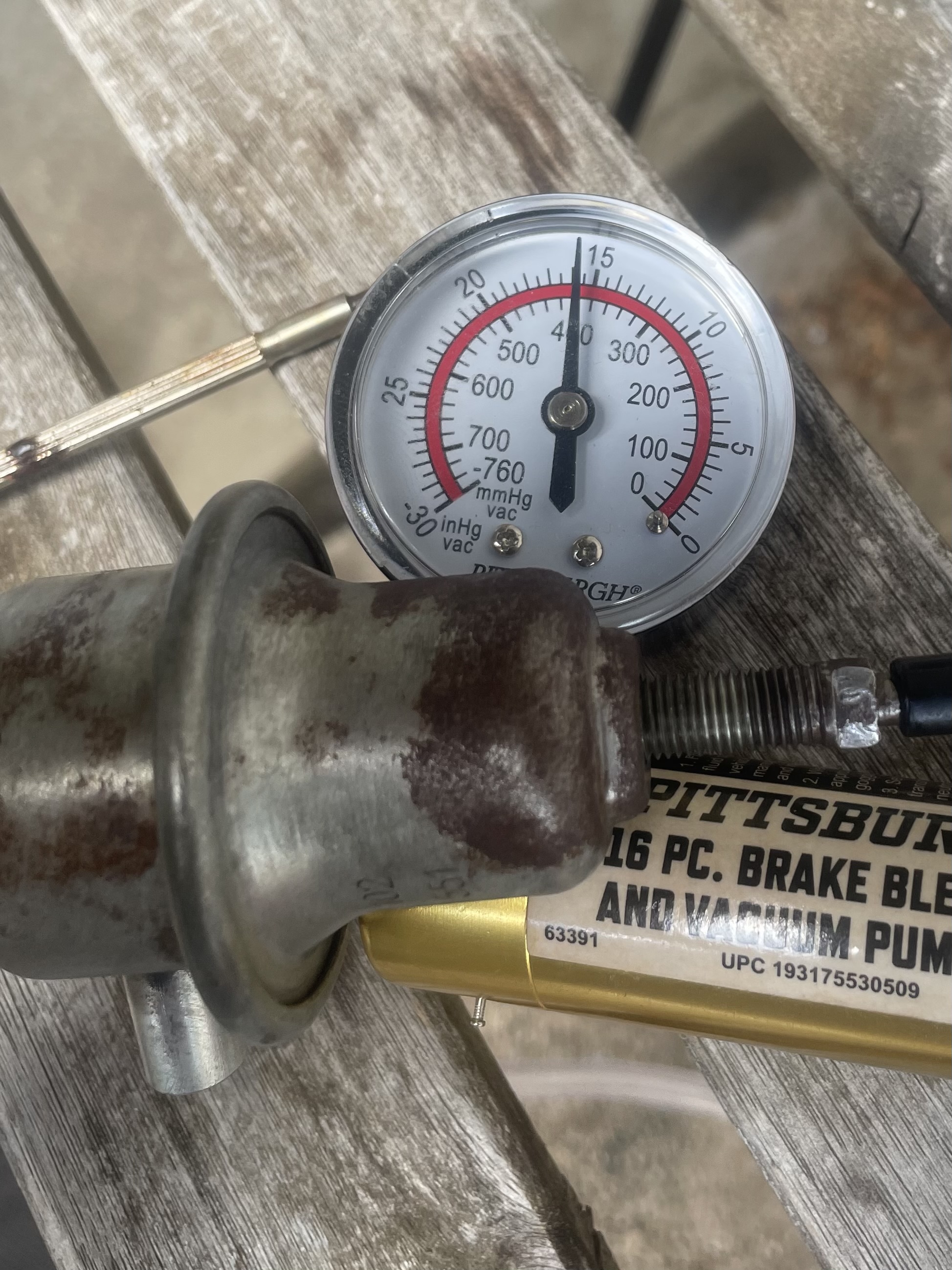

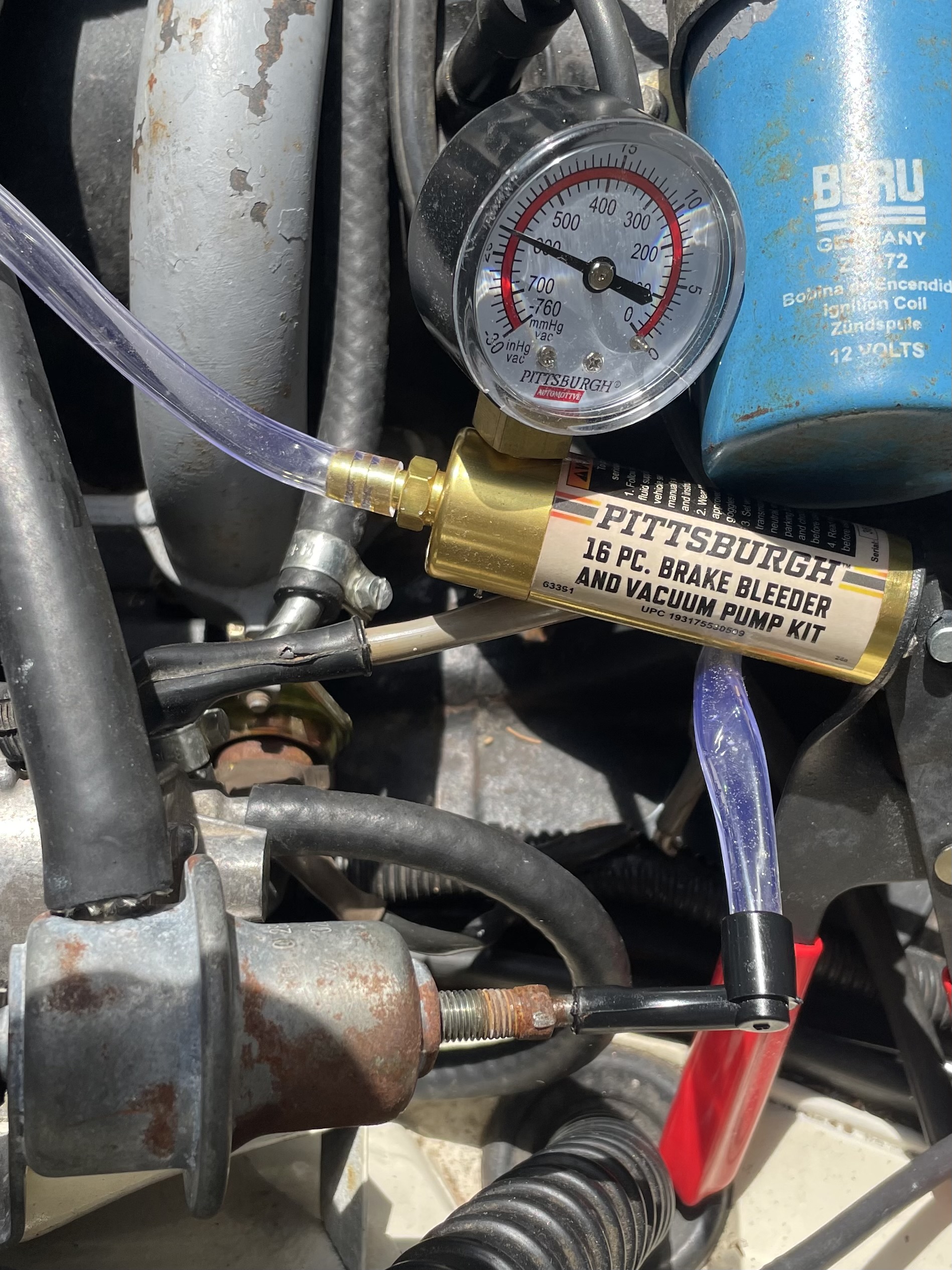

My Decel Valve is apparently stuck - I pulled a vacuum on it which never releases after screwing the bolt waay out.
Gonna soak it a bit and re-check, will report back.

Stuck open or closed? Do you know what your vacuum is at Idle? I set mine so it’s activated 2 over that. Problem is that when you idle high your vacuum is higher typically. I had to fiddle with it a few times.

I’m not sure I understand how it works completely. I just saw that it held well over the 17nHg vac (that is mentioned by pbander’s site), while no air could be blown thru it.
I interpreted that as stuck closed.

Ok I flooded the ports of the decel valve with a penetrant oil mix followed by carb cleaner and then penetrant again.. worked the bolt to extremes many times and finally was able to get air thru the two larger ports. The carb cleaner blew out a bunch of crud.
I found a spot along the bolt’s length that I could get close to 17inHg AND get air thru the ports also. It slowly leaks - I timed 16 to 14inHg in about 3 minutes. The bolt is still waay extended.
