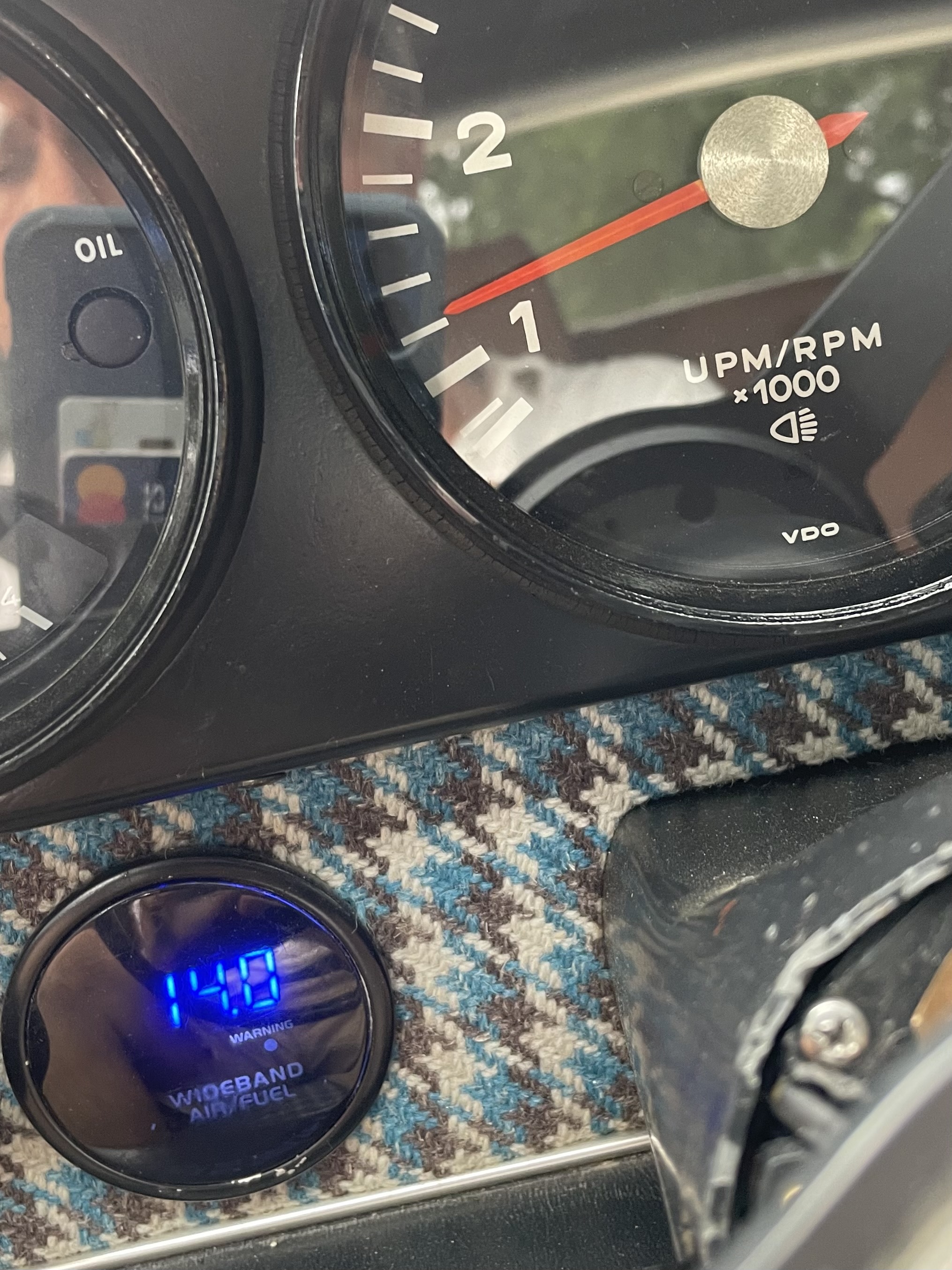

Well blocking the small hose from the plenum with my thumb brought idle down to 1000rpm apprx (still not the suggested 850)… but, I adjusted the decel valve to apprx 19inHg and that sets my idle to about 1200rpm (after a good drive and warm up). I still occasionally got some backfiring if loading up the cylinders with fuel and not using all of it before/while decelerating. Also, while driving the gauge tends toward too lean (inexperienced opinion I guess, but I’d regularly see 17,18,19s).
Here’s a shot just after the latest test drive, back at idle:

That is looking really good. Until you get the TPS fixed I wouldn't worry about anything. You will be chasing your tail till all the bits are functional. Set that decel to 20. My car pulls 23 till it warms up. After it is nice and hot it does 18-19 at idle.
Do you have your original dizzy and is it hooked up correctly?
