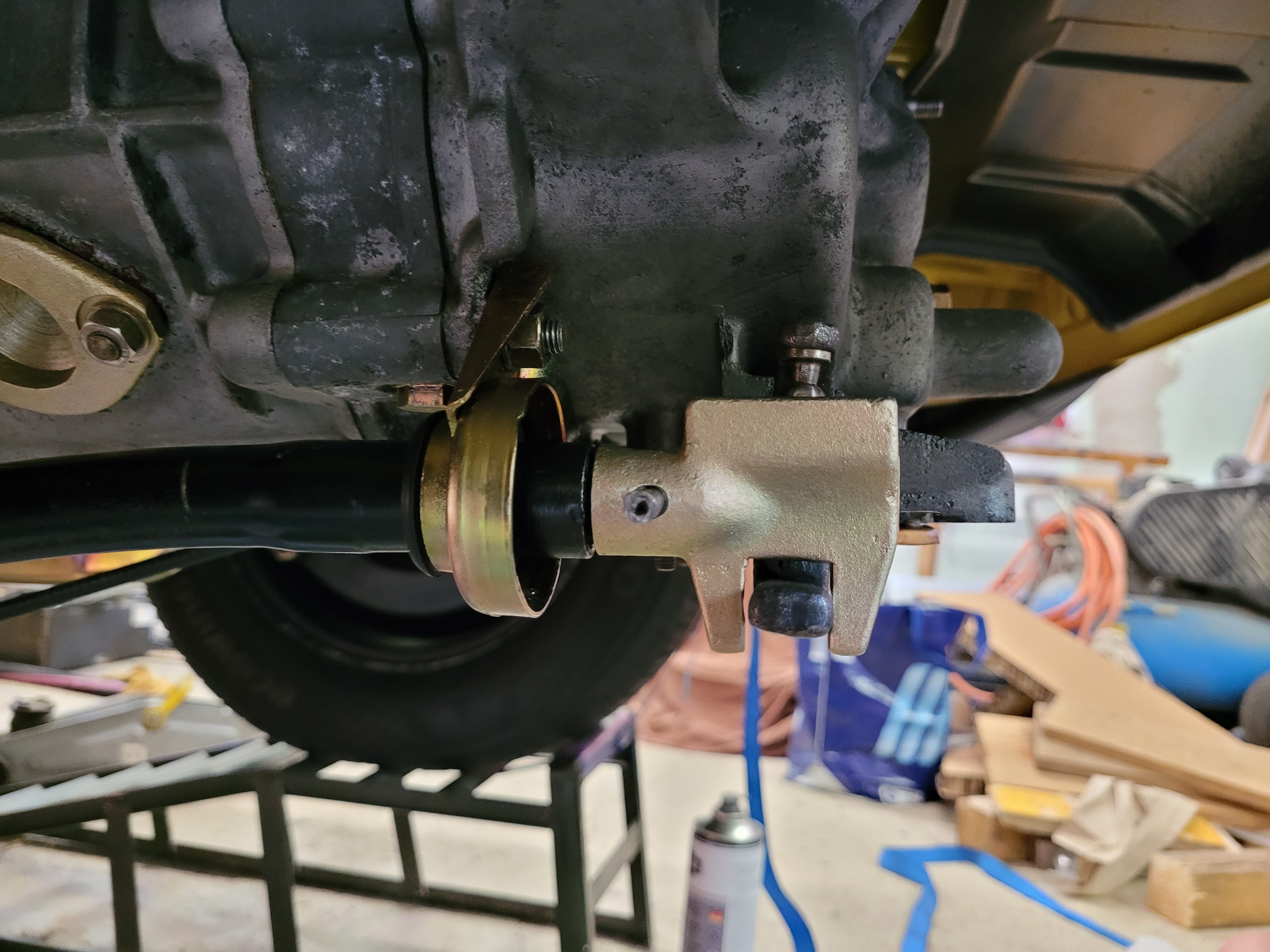

Hello,
currently I like to finish the gear shifting parts of my car. I wasn't able to find the right alignment oft the fork and lever of the gear box. The orignal manuals also doesn't give me an answer. Does anyone know how it should be aligned?

There’s no adjustment at the aft end, adjustment is done by removing the cover on the tunnel.
Loosen the clamp so you can move the shift lever without moving the rear sections. Put the shift lever in fourth gear position and use a bungee or rope to hold the lever in position. I clamp the forward bar with vice grips to hold position. Then go to the shift mechanism at the tail of the transmission and put it in fourth gear. Tighten up the clamp bolt and test drive to make sure you can select all six gears. Mark the forward and rear bars at the clamp and make minute adjustments per the marks v
