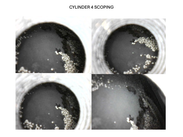

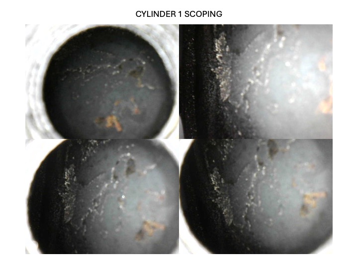

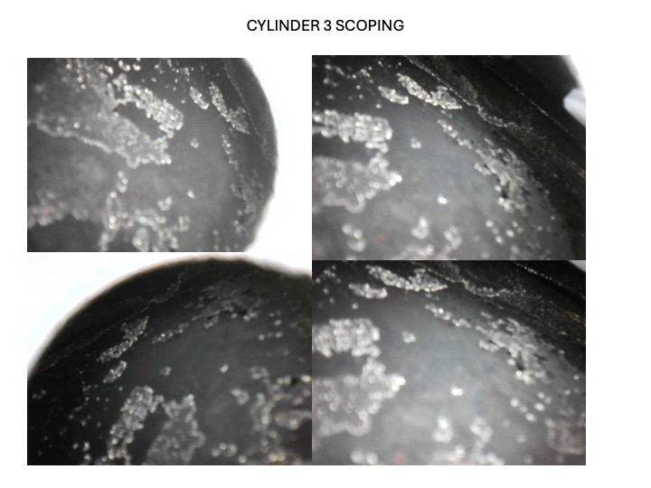

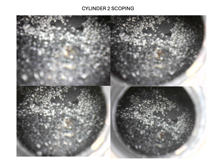

DC_neun_vierzehn   I decided to start with the scoping first. Here ar...   Jul 17 2025, 11:46 AM
emerygt350   I don't see anything that looks like damage, b...   Jul 17 2025, 12:06 PM
WFG   Could be a cracked piston at the pin. Happened to ...   Jul 17 2025, 12:59 PM
emerygt350   You localized the sound to cyl 4? Maybe time to r...   Jul 17 2025, 02:22 PM

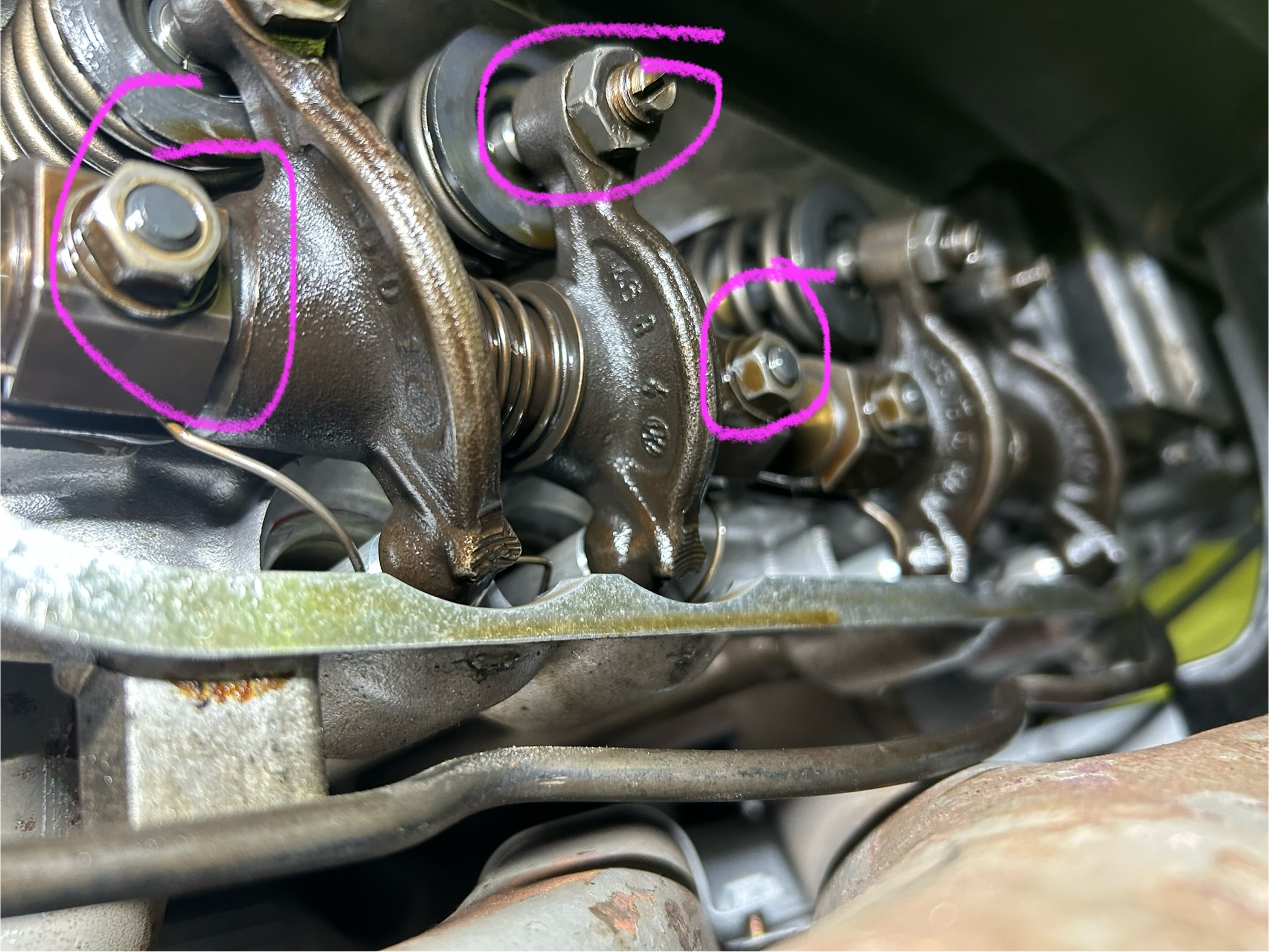

DC_neun_vierzehn   So I wasn't crazy when I posted earlier that I...   Jul 18 2025, 02:38 PM
Shivers   So I wasn't crazy when I posted earlier that ...   Jul 18 2025, 04:27 PM
DC_neun_vierzehn   You don’t need much. Undo the two large bolts o...   Jul 19 2025, 07:46 AM

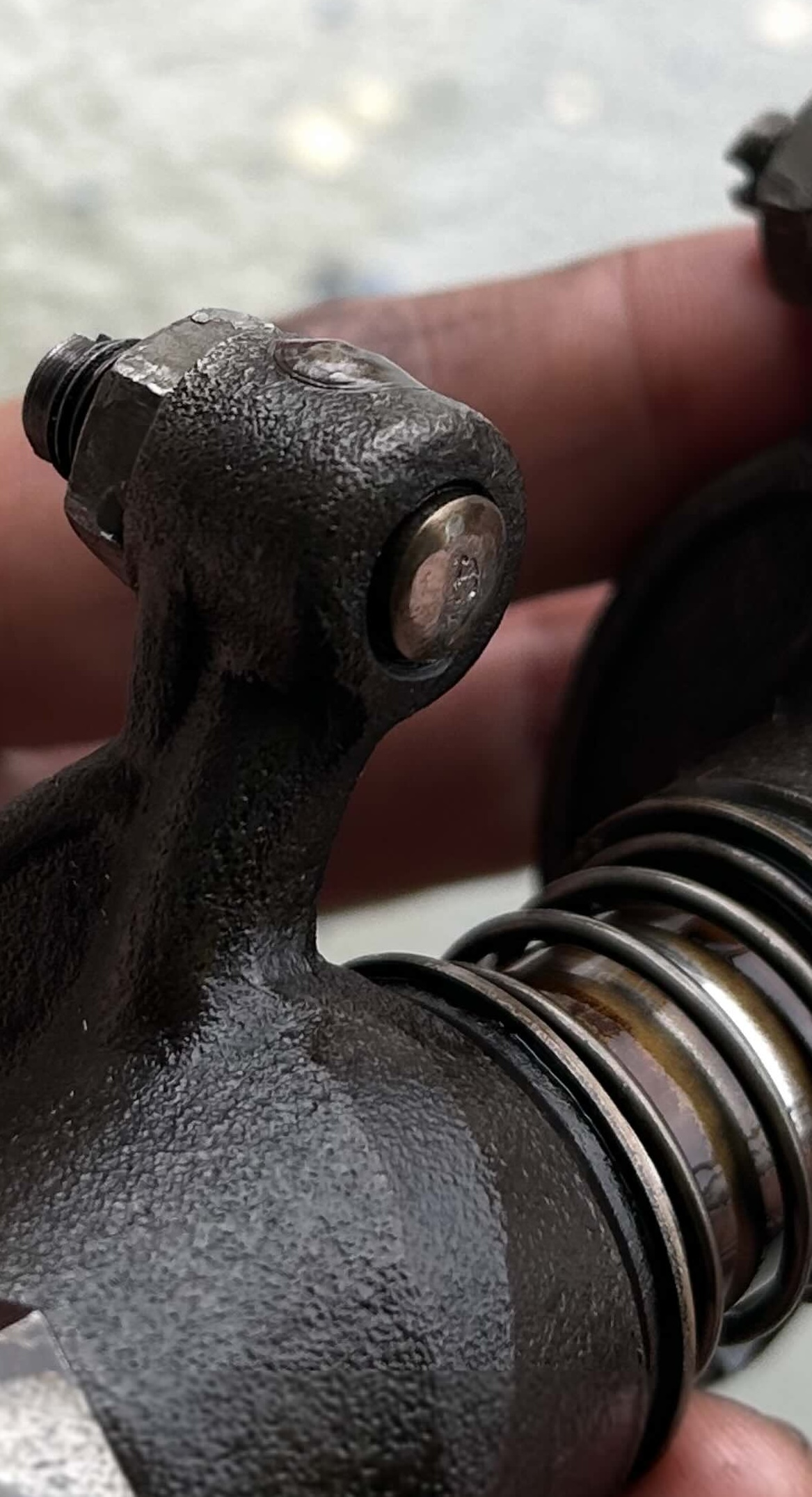

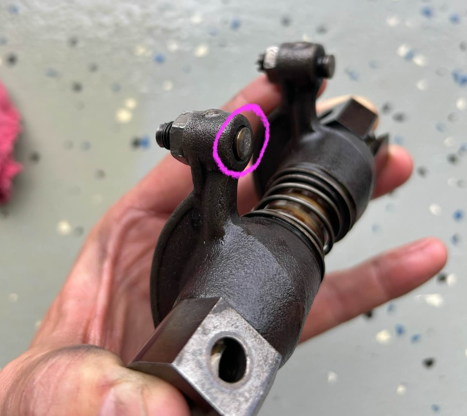

DC_neun_vierzehn   So I thought before I attempt to remove the pushro...   Jul 26 2025, 11:16 AM
tomeric914   Kris, The cam in that motor is a Webcam 73 grind....   Jul 26 2025, 08:14 PM
DC_neun_vierzehn   Kris, The cam in that motor is a Webcam 73 grind...   Jul 28 2025, 07:27 AM
Jack Standz   Looks like a likely suspect. Maybe the valve/sea...   Jul 26 2025, 12:59 PM
emerygt350   Interesting! Valve stems stretch but that...   Jul 26 2025, 01:35 PM
