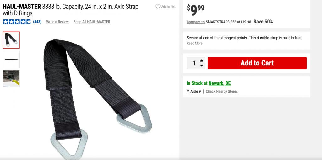

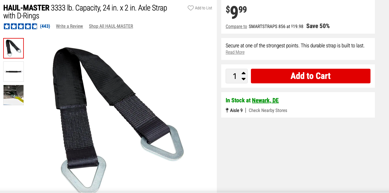

Grab an axle strap at harbor freight, amazon, etc and throw it in the trunk. Loop it over the reinforcement strut on the a-arm and the tow driver can hook his chain to it.

I've done it dozens of times to pull a car onto my trailer with the winch.

Usually a rollback will have a bunch of extras to make it work but the large hook on the end of the cable won't always fit the tow hook. There isn't a lot of clearance between the loop and the floor pan. It also can scratch the paint. The $10 strap solves the issue 99% of the time.
Sometimes deep spoilers are an issue.

Got myself today a couple of the Harbor Freight axle straps you recommended. Now just to be clear, is the best attachment point on the a-arm(s) where I circled in the attached pic?
Osnabruck914
post Jul 30 2025, 04:13 PM
914-6 GT in waiting
Posts: 19,993
Joined: 19-September 09
Member No.: 10,825
QUOTE(Osnabruck914 @ Jul 30 2025, 05:50 PM) *
mepstein,
Osnabruck914
Yes, that portion of the a-arm is more than strong enough to pull your car up the incline of a rollback.
