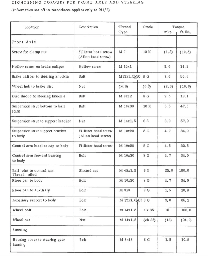

if you have the workshop manual its in there.
Group 4 Front Axle.
there is a table with descriptions.
assuming bolt you question is Control Arm Forward Bearing to Body.
Bolt M10 x 30
Grade 8G
Torque 4.7 Mkp / 34 ftlbs

dunno
here is the page.
could be they revised the bolts along the way.
the factory manual i have does not seem to have all the updates in it necessarily.
could be misprint.
one thing for sure. your 40mm came out, and one went back in and you got more thread in there than a 30mm so got to be ok. (IMG:style_emoticons/default/beerchug.gif)

Yep, that agrees with the Parts Catalog PDF. Thanks everyone!
