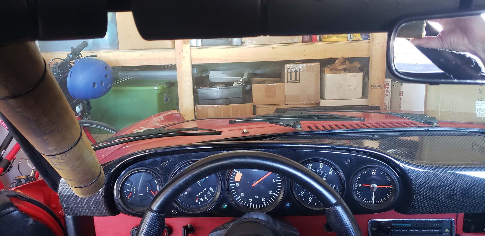

I'm 6'2" and use a 350mm steering wheel. I do have several gauges rotated so the important stuff is in view.
And since i have two eyes, i took two images with a slight offset. Combine the two and you get pretty much exactly what i see when i drive.

Hey thanks, this really helps. It does show, or rather doesn’t show, the gauges very well. If the wheel itself were thinner that would be less of a problem maybe.
Slick though how you rotated them to compensate.

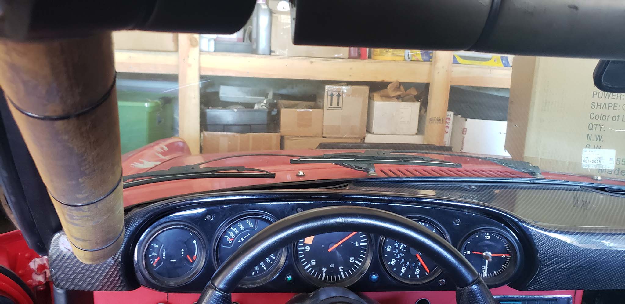

GregAmy
post Aug 3 2025, 01:14 PM
Posts: 2,549
Joined: 22-February 13
From: Middletown CT
Member No.: 15,565

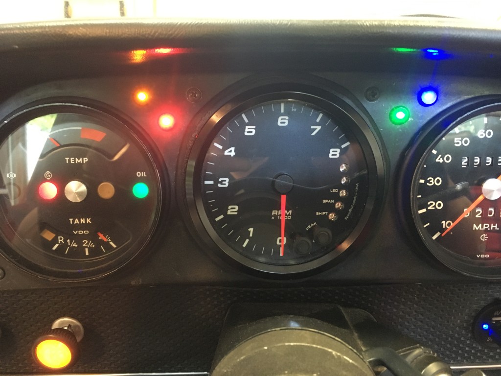

Sitting upright with the phone right up against my eyes.
Edit: and the usual question I get: what's with the LEDs? I added those some time ago when I installed the Speedhut tach. I didn't like where the wanring lights were anyway so I got LEDs and installed them in a more-visible location, wired to the same wires in the back. Left to right:
- Yellow = GEN light
- Red = oil pressure light like Porsche should have done to begin with!
- Green = turn signal
- Blue - high beams

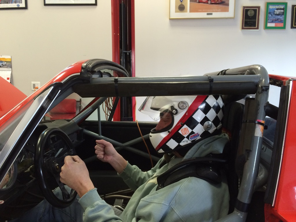

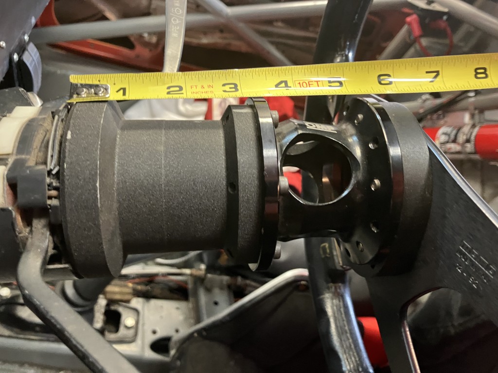

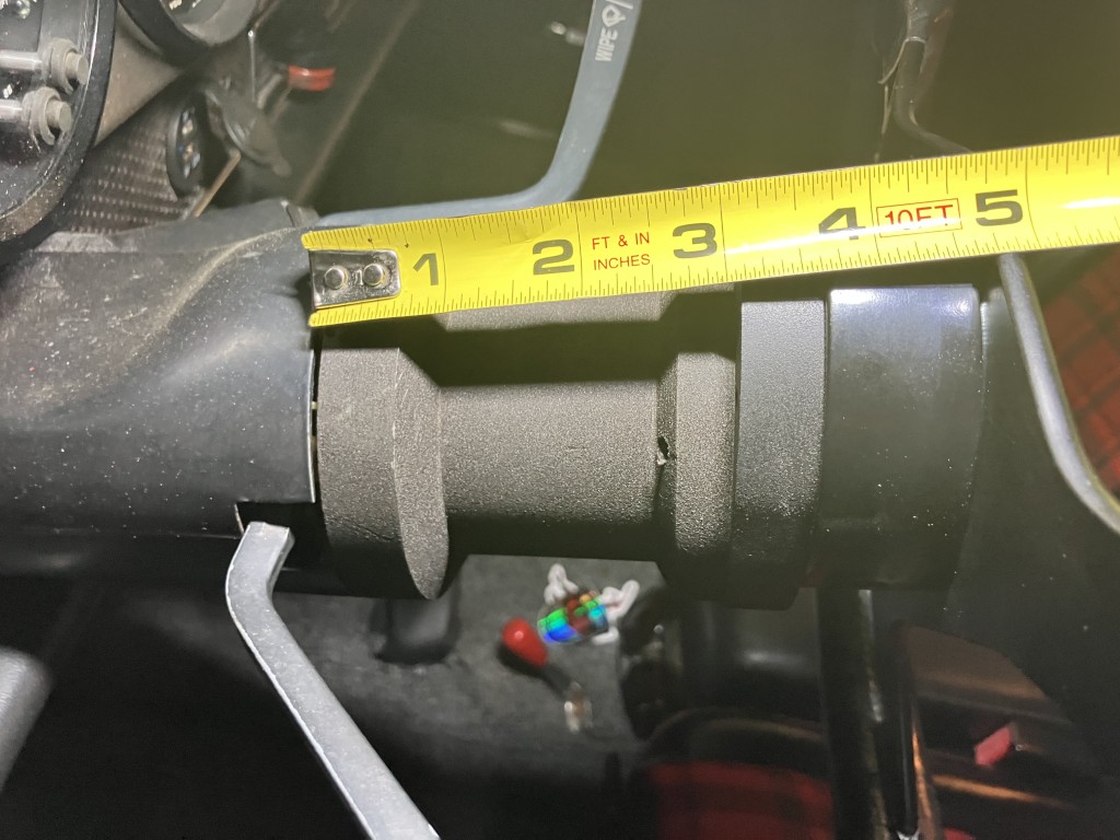

post Aug 5 2025, 03:06 PM
Posts: 2,549
From: Middletown CT
Member No.: 15,565
QUOTE(DC_neun_vierzehn @ Aug 4 2025, 04:03 PM) *
what size space did you use (.5", 1", 2", etc.)?
Remember, our cars have a bit of a dish and offset stock, so these not only compensate for losing that with a flat wheel, but also for my personal driving preference.
Street car. I sit with the seat only slightly forward from dead back to get the correct comfy knee extension. In looking at this photo, I'm not only using a 3" extension and JWest's 16mm thick eccentric, but also an LTB Autosport 1" extension:
Race car. I sit bolted to the floor in a thin Butler aluminum seat. It, too, is almost all the way back to the firewall, and tilted more supine such that the headrest is detached to get my head below the roll hoop. 3" spacer, OPM 2" spacer, and JWest 16mm eccentric.
But notice, since I'm sitting on the floor, I have the eccentric moving the wheel down:
This photo below is what I used as a guide to decide how much in spacing I wanted in that car. This is how I prefer to drive.
