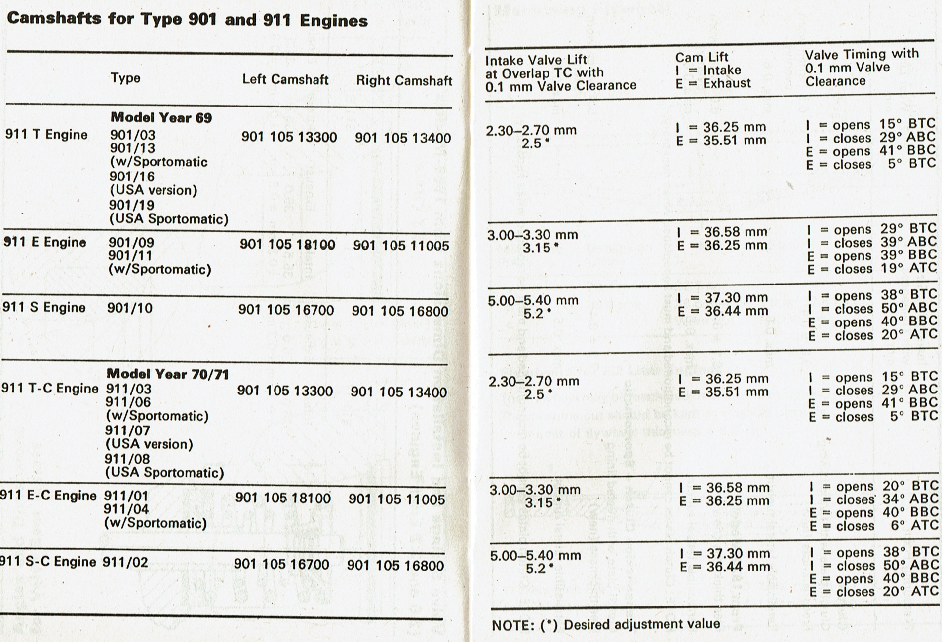

QUOTE(Dugo16 @ Aug 17 2025, 12:29 PM) *
Trying to figure out what cam and crankshaft are in there.
Valve lift measurements below where measured with a dial gauge placed on the valve retainer.
- Intake lift .402
- Exhaust lift .376
If you find copy of the Tech Spec book for your year, it will indicate these specs. Here's an example from '69-71 911 T, E, S
