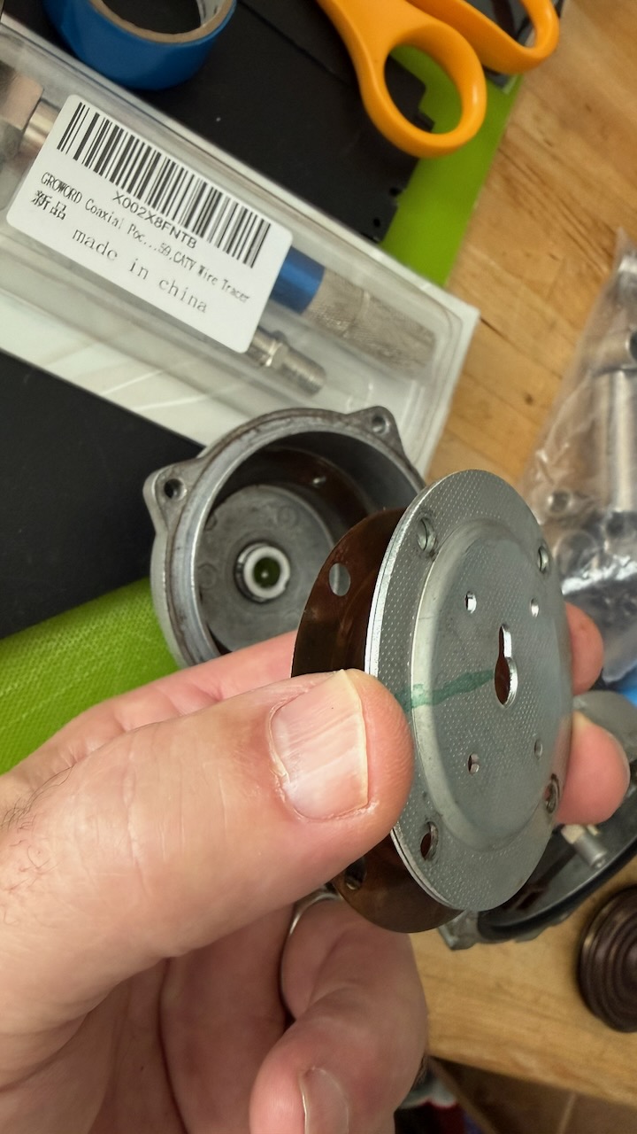

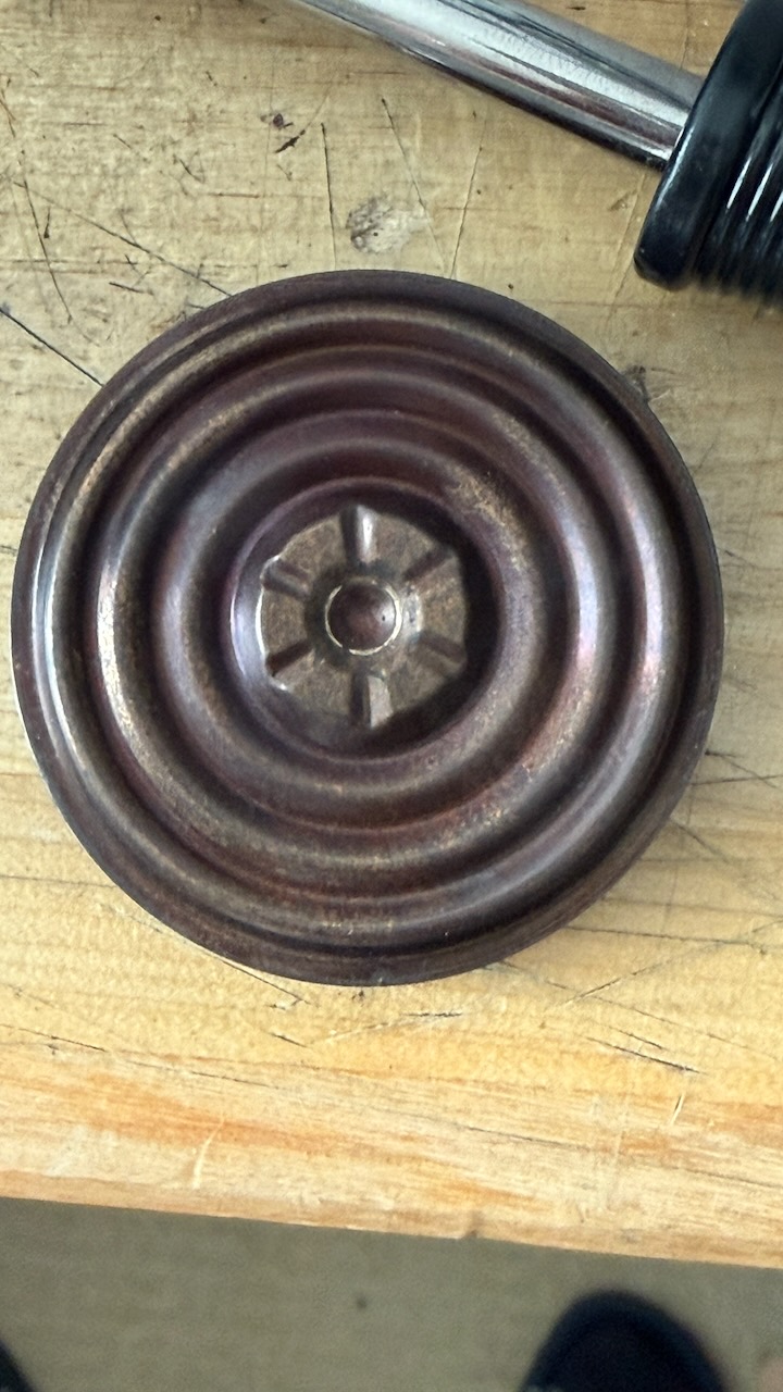

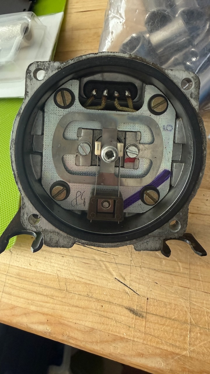

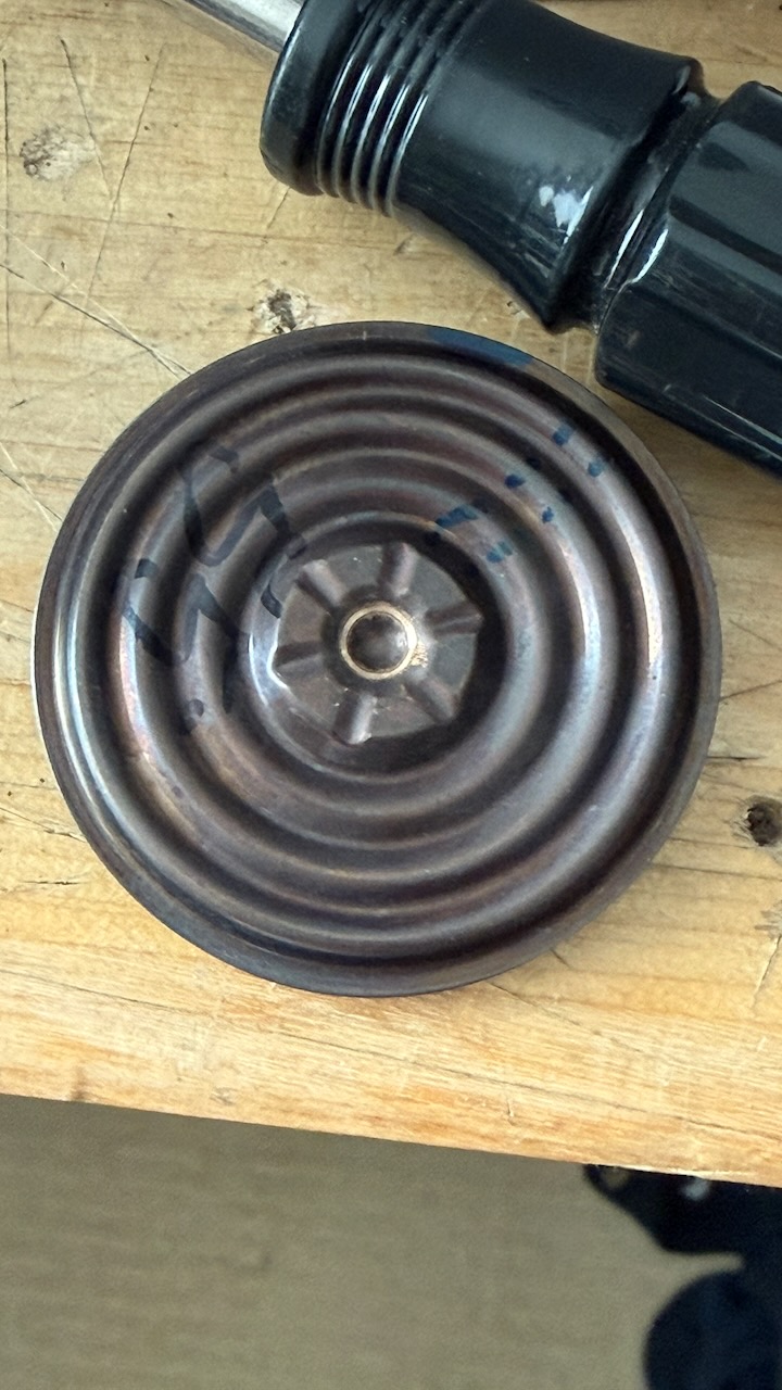

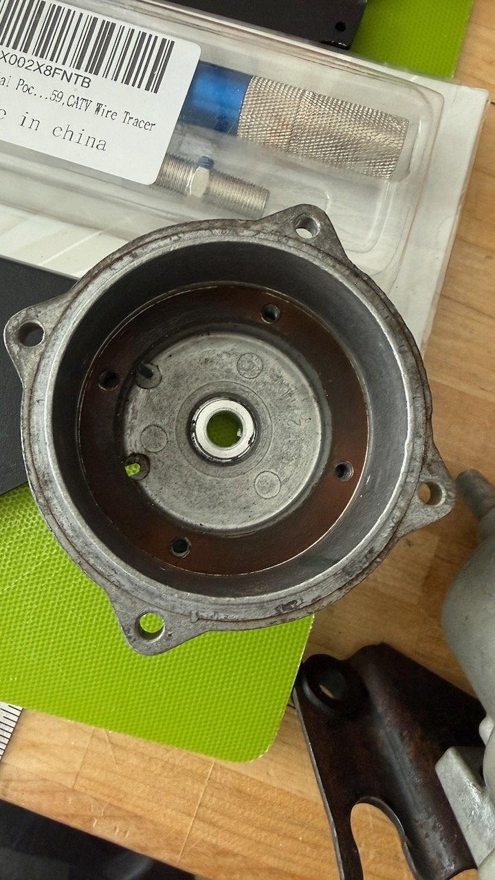

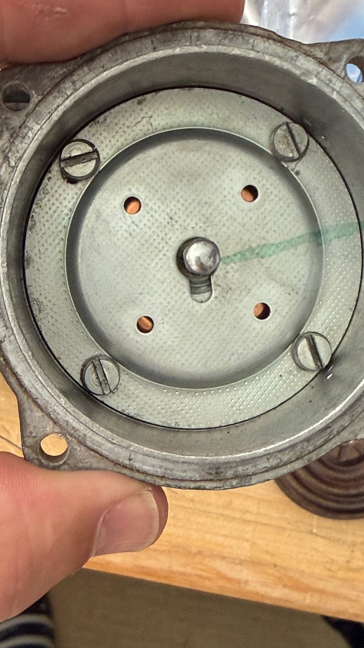

Here's the pics.
First time I've had one open but nothing looks amiss to me - tell me what I'm missing and what i should look at.
diaphragm appears in tact to me.
cell seems good...from what i can tell.
The ONLY thing that I can MAYBE see is that the 4 bolts holding it together didn't seem overly tight. They were tight - just not as tight as I thought they should be. Seemed well-sealed tho...and clean. I doubt the tightness of the 4 bolts had anything to do with it.
Attached ImageAttached ImageAttached Image[attachmentid=951

AND....how do i put it back together?!
