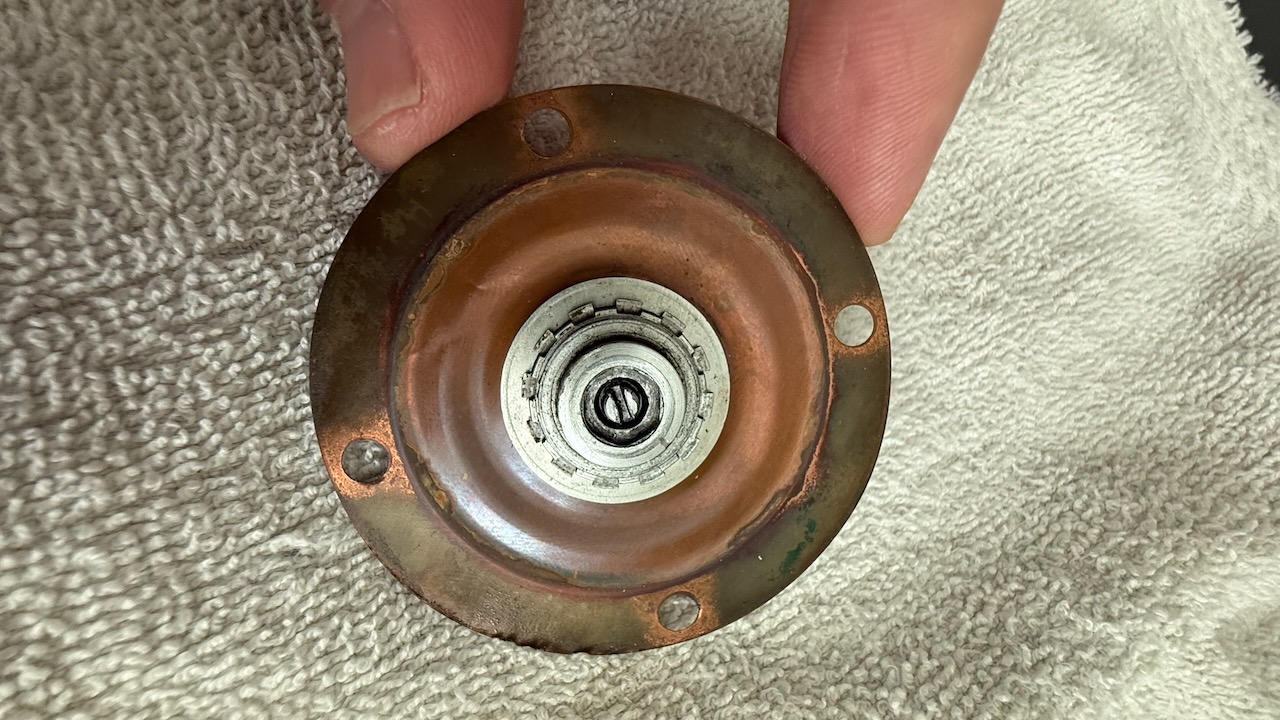

Post photos of the front/back of the diaphragm please.

You can test if the cell is doing what it should be when you get it back together. That will tell you if it is damaged. It should still hold vacuum even if the cell is compromised. Unlikely a crack would pass through both sides. I think. You need to check that diaphragm closely for cracks, post some close up picks of it as Chris mentioned.

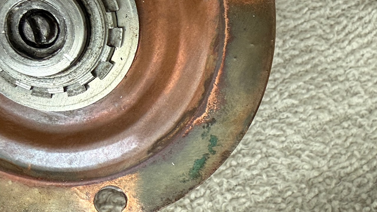

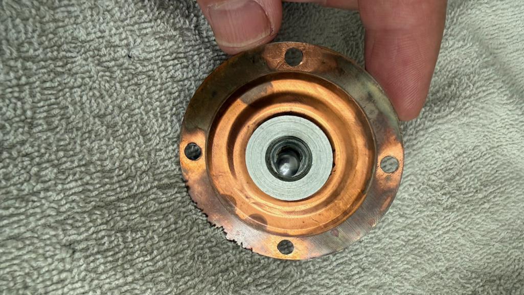

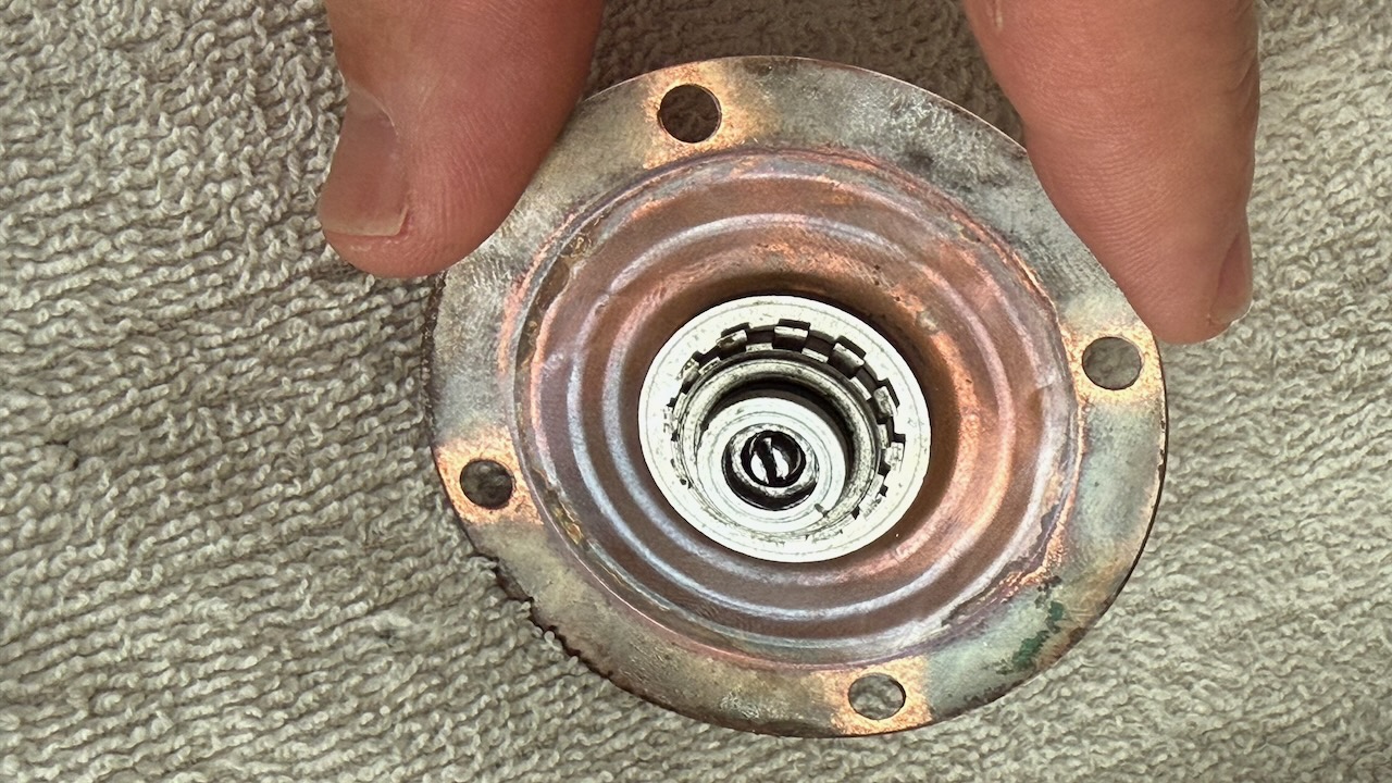

I don't see any breaches. I've held it up to a bright light to look for cracks - none. I've gently flexed it all around and don't see anything.
Attached Image Attached ImageAttached ImageAttached Image[attachmentid=951
918]

QUOTE(FlacaProductions @ Aug 20 2025, 06:51 PM) *
flex it more vigorously
Any crack will be about 3/8" in from the edge

No cracks. I would think that it’ll tear or click if there was a tear.
I’m going to put to back together.
