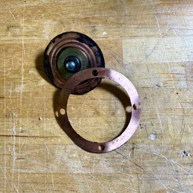

With nothing else to do on this front, I decided to see if I could improve the MPS that I put back together recently. It was leaking down vacuum a little faster than I liked.
First task was to dismantle the one that would not hold ANY vac. See the pic. I'm pretty sure the diaphragm had a leak. (IMG:style_emoticons/default/lol-2.gif)
So after Frankensteining the two and using what I thought was the best parts, I ended up with an MPS that holds solid vacuum and is calibrated to factory specs. I know it will still need adjustment but this is a really solid (re)starting point going ahead.
Couldn't have done it without the VAST knowledge and skills on this board - big thanks.
