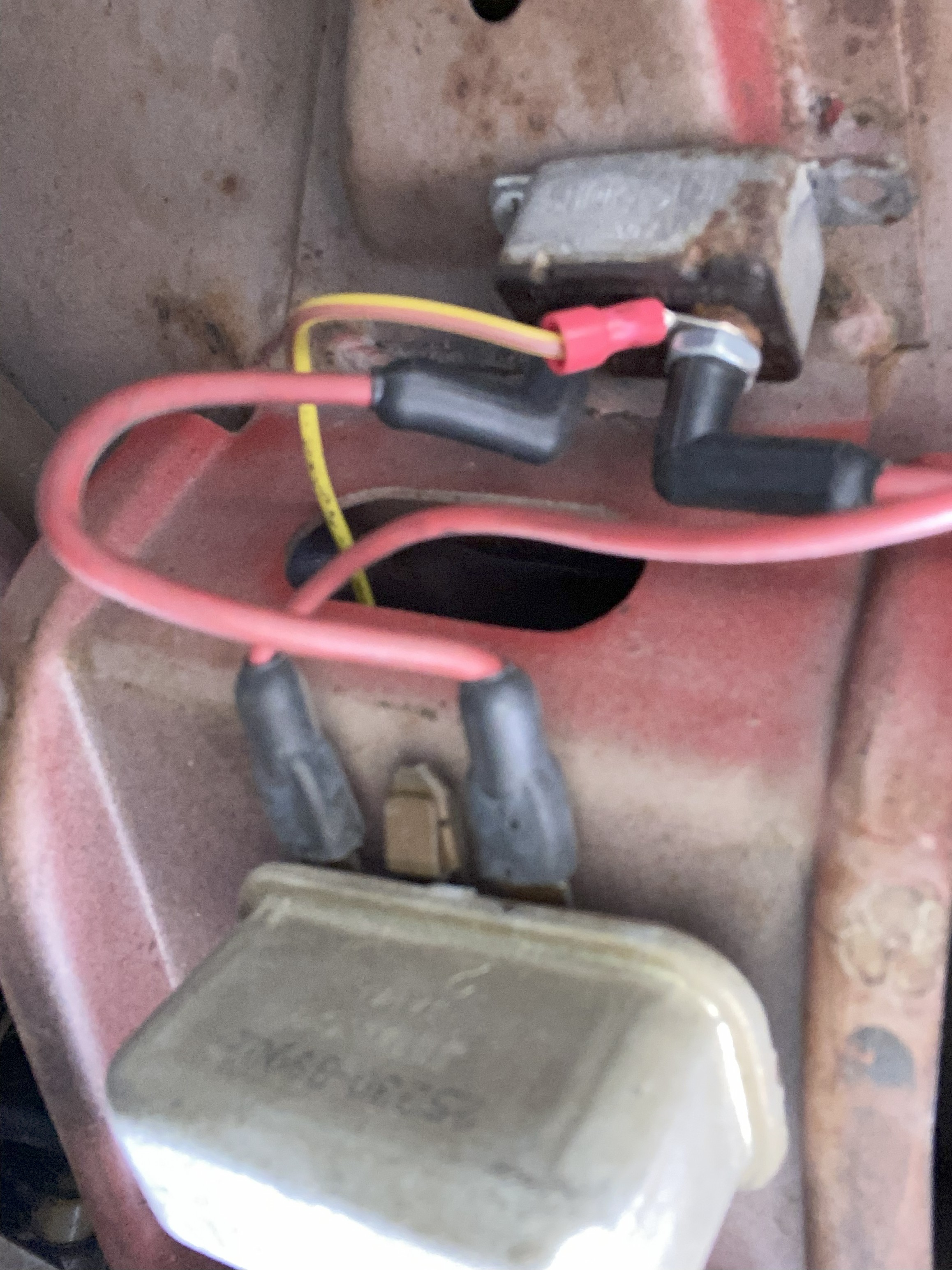

Thanks for the clarification
Could the turn signal relay be one of these?
Found these under the dash

Those look like Air Conditioning relays

Those look like aftermarket relays installed by a previous owner. They don't look like Porsche factory relays. During the 914s production run, the factory liked to use those black plastic round-shaped relays for everything.

The turn signal relay is on the board attached to the fuse panel. Two screws to remove the panel. IIRC it’s the upside-down square one.

On early cars it was not attached to the relay board, I believe.

Can't tell what these cans are for. You'll likely need to trace the wires to see where they go.
