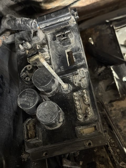

Looking for the connector for this multi-pin plug on the relay board.
Don't need whole harness - just the plug (IMG:style_emoticons/default/smile.gif)

There are four multi-pin connectors to the relay board. 3, 4, 12 & 14 pins.
Which one do you need?

One of the more experienced members suggested I ditch the whole board (I'm doing an engine conversion). Thanks anyway!

If you’re keeping the relay board, you need the twelve pin female connector; part number 91161212204. If you’re going to delete the relay board then you need the fourteen pin male connector part number 91161211305.
