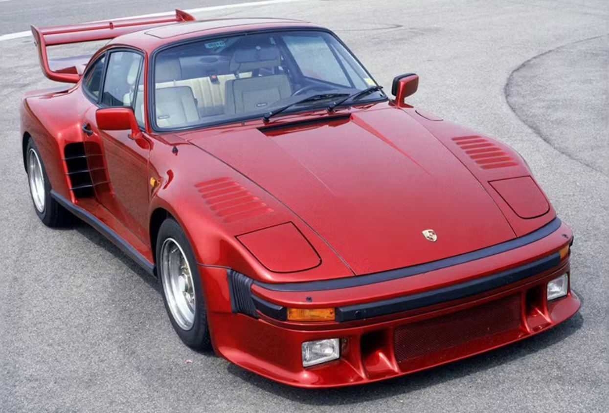

I've fallen in love with the Group 5 car that's recently been delivered to The Red Barn where we're going to give it a bit of love and improvement. This will be covered in various "At The Red Barn" YouTube videos.
This thread will cover that work as well as my attempt to build my own set of Group 5 body panels. You'll have to wait to learn what material(s) I may have selected, as well as seeing which chassis they go on. Well, and if I'll ever really do it!

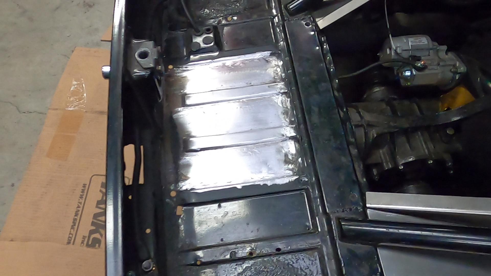

tygaboy   Let's fix that hole in the rear of the trunk. ...   Sep 8 2025, 04:29 PM

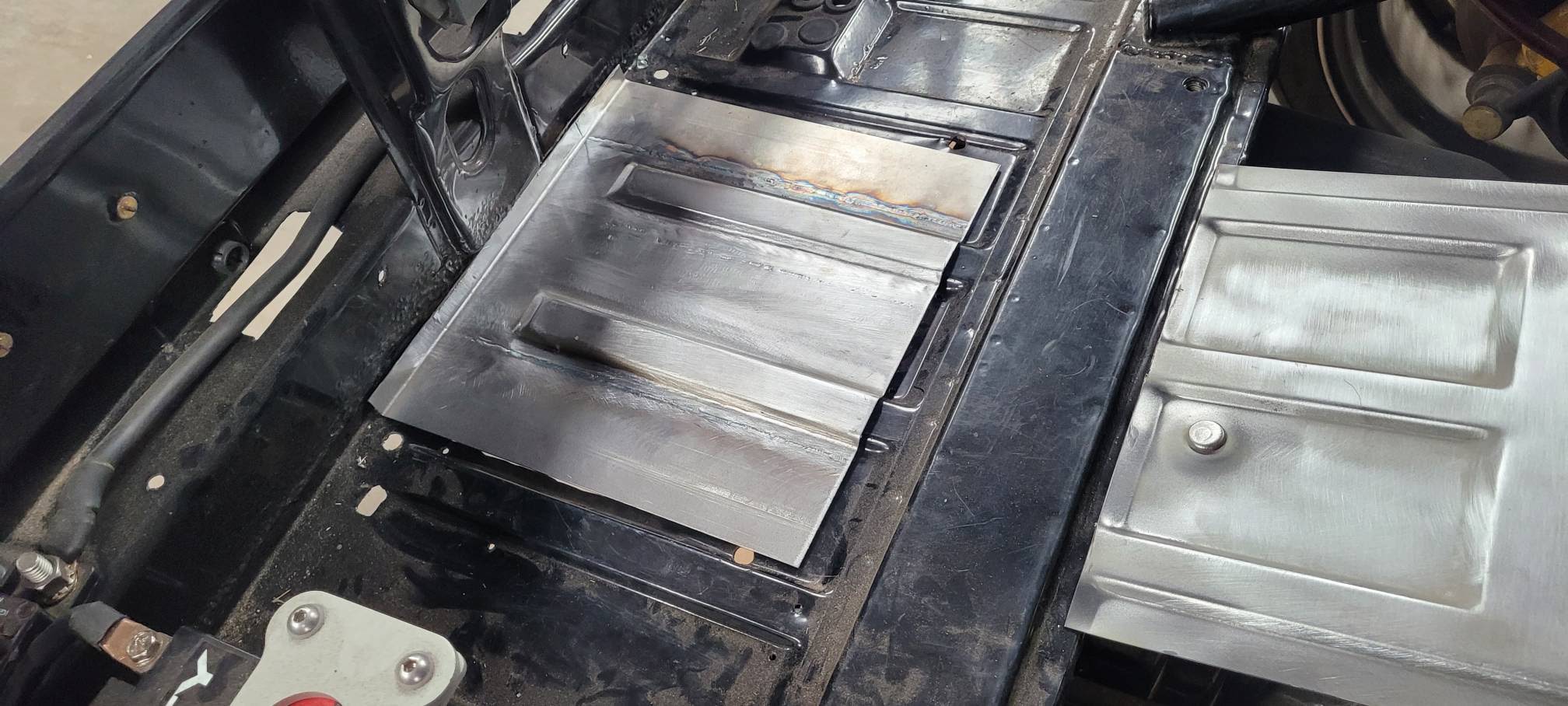

tygaboy   The hole, she is patched! Butt welded factory ...   Sep 10 2025, 04:30 PM

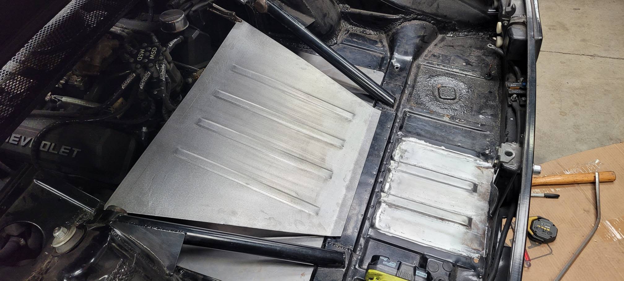

tygaboy   We opted to go with all new material for the lower...   Sep 11 2025, 01:12 PM

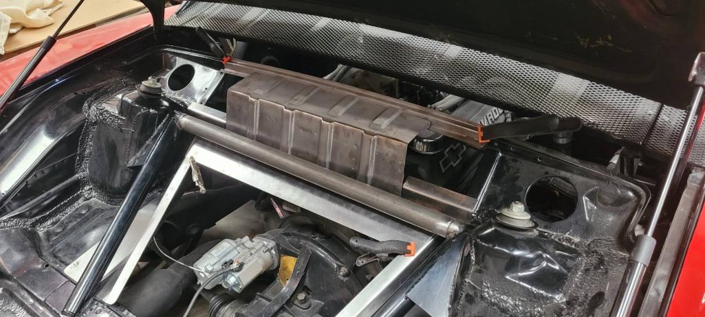

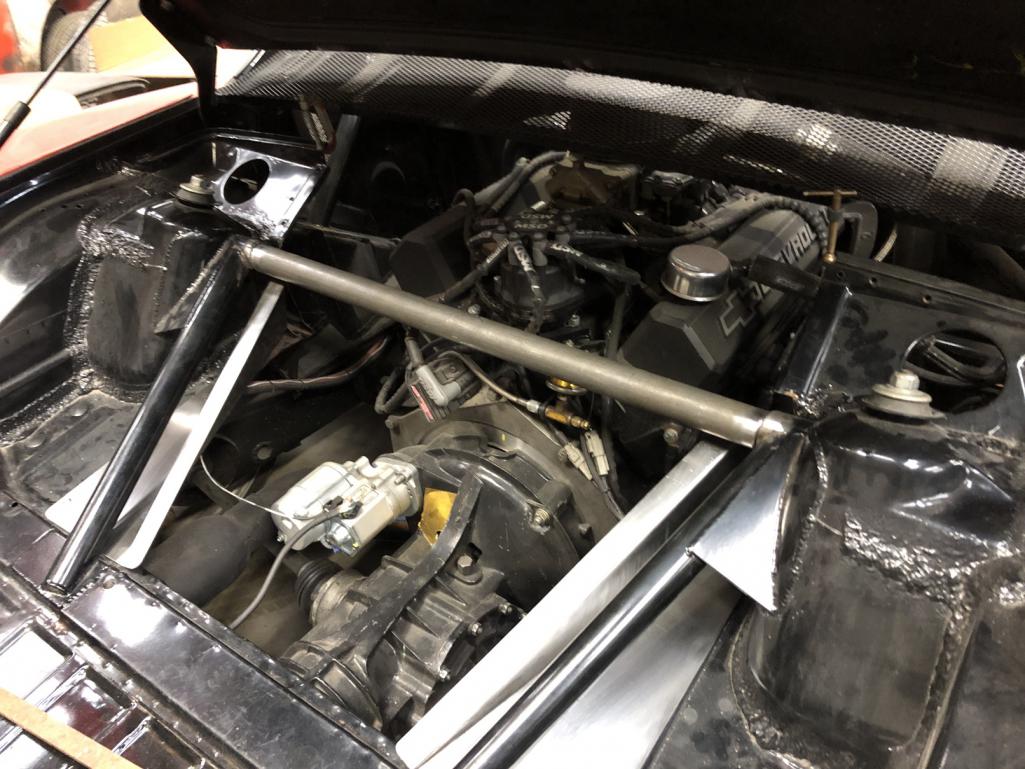

tygaboy   The cross bar is in, the framework for the removab...   Oct 14 2025, 06:57 AM

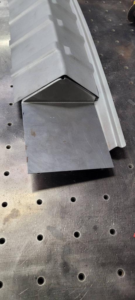

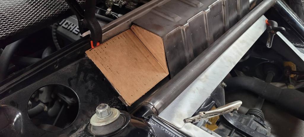

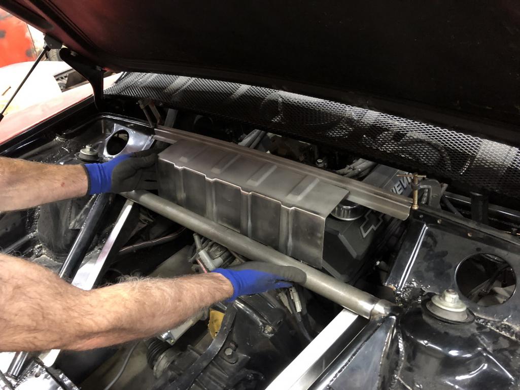

tygaboy   Two-piece removable engine / trans cover complete....   Oct 16 2025, 08:41 AM
