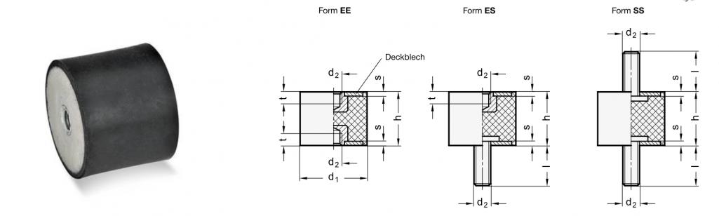

Right now the MPS in my car is mounted with some sheet metal screws and old squished rubber grommets. Not at all the original mountings... Didn't see any suppliers for OE-style replacements anywhere near here, so I am looking at re-mounting it on some rubber standoffs like this:

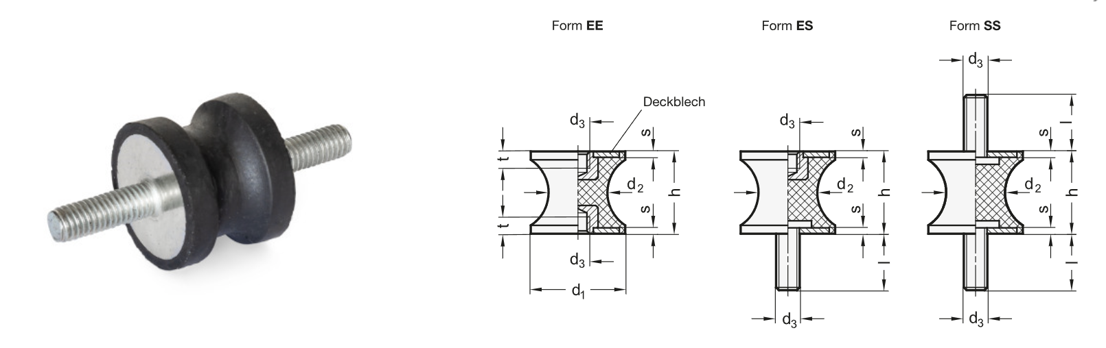

10mm in diameter, 10mm high, M4 threaded studs (Form "SS"). Three different Shore A hardnesses available, 40, 55 and 70. The same ones without the "necking down" in the middle are also possible:
The idea is to mount the standoffs to the body sheet metal and then be able to easily bolt/unbolt the MPS on the protruding studs with M4 locknuts and flat washers. What do you think? The mounting should be soft enough to damp out vibration but not so soft to allow the thing to shake significantly.

Only real downside I have seen with using the stand off mounts is it puts the MPS into the fuel rail. they work but it gets really tight.

Hmm, OK, at 10mm height, I think it will only add 6mm or so over the original mount. I do have a couple of other ideas for a flatter solution if that is indeed too much.

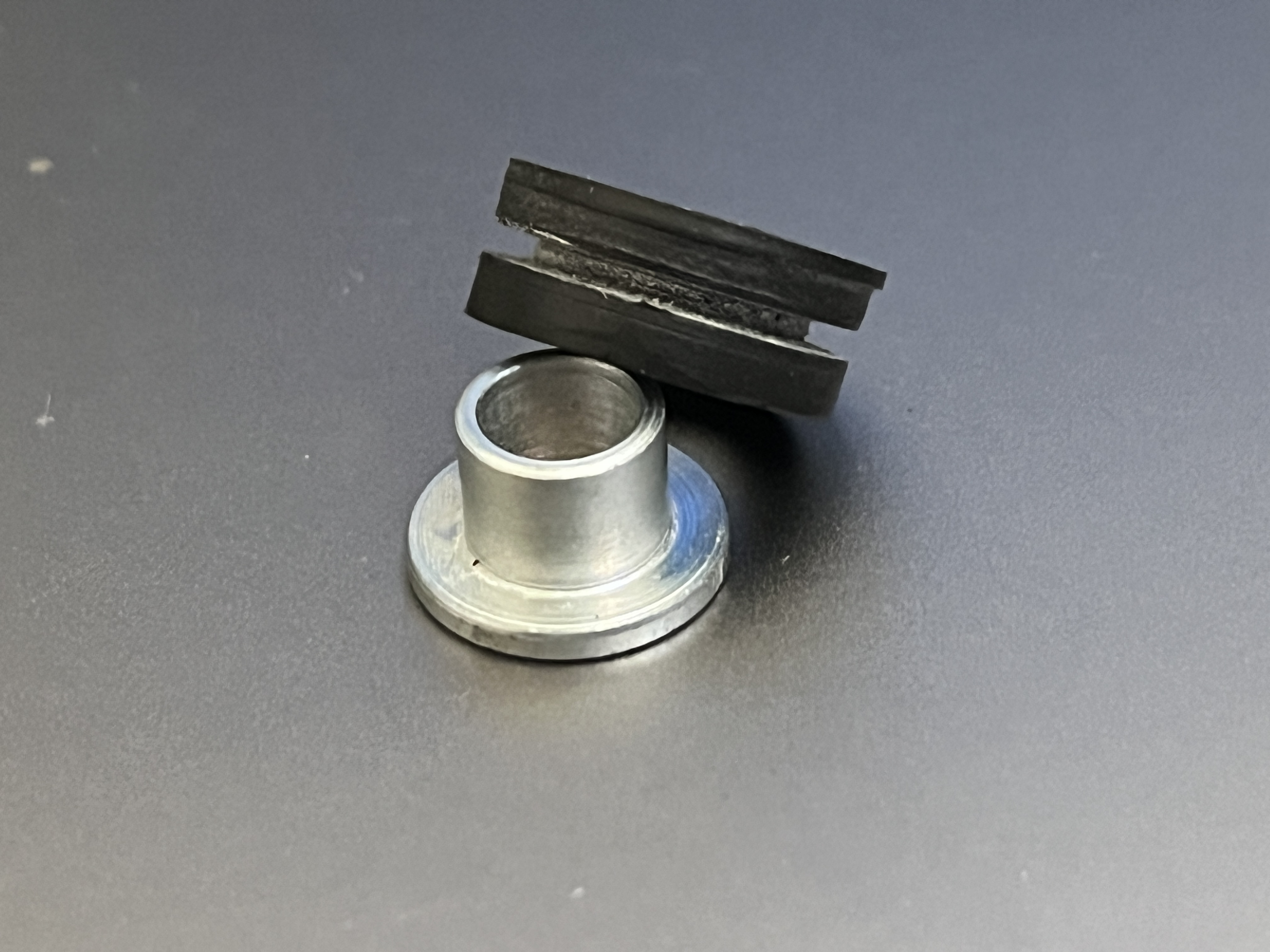

The original rubber grommet:
OD 16mm
ID 9mm
6mm Thick
The ID of the metal bushing is 7mm.
I think if you look around an acceptable solution can be derived.

Hey Jeff,
Thanks for the dimensions and the image! : (IMG:style_emoticons/default/beerchug.gif)
The bushings I can fab here - I have a small toolmaker's lathe - so I just have to look around for some grommets that are around that size.
Edit - found these in my collection. The one on the left is 16mm OD, the one on the right about 18mm, both around 9mm ID with groove diameter abut 13mm. The groove diameters may not be quite small enough, but probably can be made to work.

Nice Mitch!
The groove diameter of the original is 11mm, it may compress enough to squeeze into the bracket.
