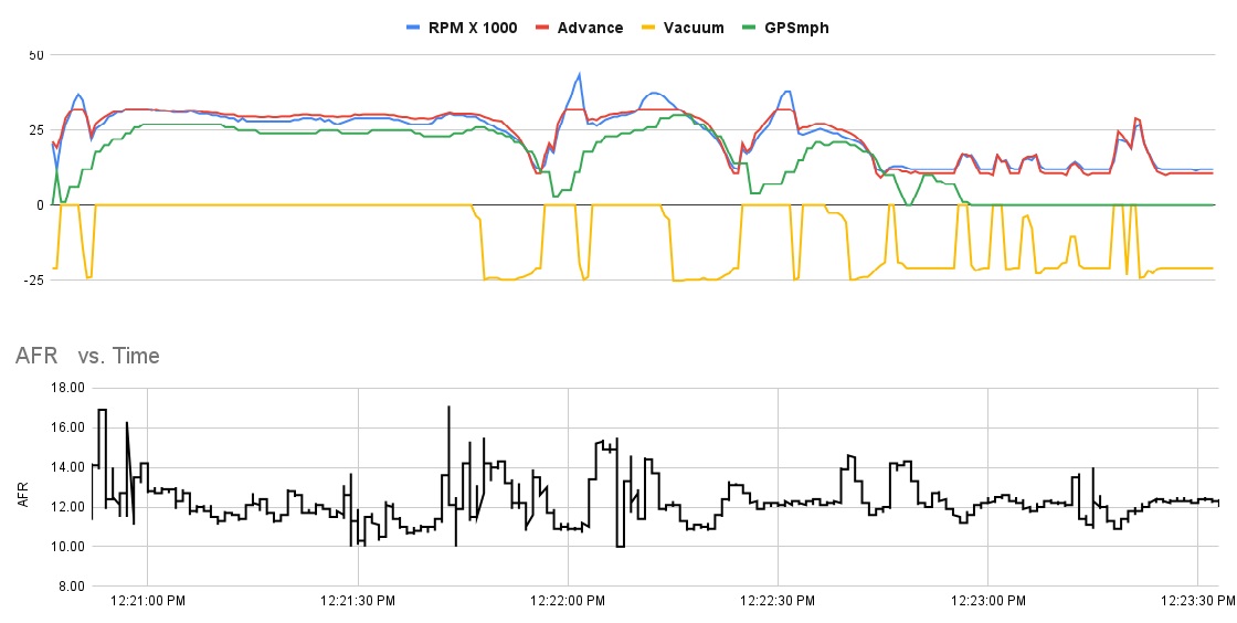

Science Project: During the tuning process I discovered that the 123 + with bluetooth builds a log file every time you connect with your phone. I’m pretty sure this is the only 123 version that does that. The file resides in the File area of your phone (makes sense) and is a pretty rich set of data parameters. It's easy to dump the file into a spreadsheet.
I also installed an AFR gauge and a bung for a Wideband O2 sensor… and noticed that it had the ability to also log AFR readings. This got me thinking… Joining the two data sets together would be a great tool/ resource to help with the tuning of the car. So this past week I spent some time trying to get the AFR to communicate with the Windows laptop. I ended up upgrading/buying a real AEM gauge (mine was a Chinese knockoff) and some cables… and was finally able to collect data. I use Realterm software (free) and it can add a timestamp to each data point.
Next problem…. The AFR puts out about ten times the number of data points then the 123 distributor does. Also…Realterm date stamping is very limited compared to the AFR gauge. I haven't quite figured out how to marry the data completely together yet. I’m doing this in Google sheets… and find it slow and clumsy compared to using Excel (which I don’t have any longer). But I was able to chart the data sets individually and stack the charts on top of each other which got me most of the way there.
This was a cold engine (135F) and a quick drive( 3 Minutes) in suburbia …. And is just meant to show what is possible.
I also sent an email over to the 123 guys in Europe asking if they have ever considered building a tool and system like this (they said they are always evaluating ideas) There are now Blue Tooth enabled O2 Kits which could be a nice pair with a 123+ reporting tool. The idea works for FI or Carbs (and other cars)… as long as you have a 123+ and an O2 sensor/gauge that can log data.
Thoughts??
