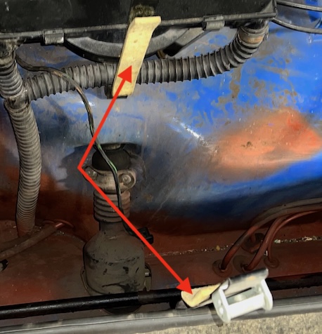

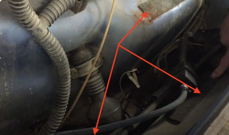

There is a drain at the bottom of the gas hole. Make sure it is clear. There should also be a couple of pads/carpet type pieces that are glued in place. The help noises and metal to metal rubbing if the tank moves a little.

Yup, replace the felt pads that the tank rests on. Clean up where they go, repaint if necessary. Check the gas tank where it sits on the pads; they hold moisture pretty well and can promote rust pinholes in the tank in those spots.

QUOTE(Ishley @ Sep 17 2025, 06:27 PM) *
Thanks for pointing this out. I assume you're referring to the ones seen in this Auto Atlanta video? So there were three black strips? I don't see them in the parts catalog. Were they on all years -4 and -6?
I do have two white strips of felt-like material, but as I recall they went between the metal straps and the tank.

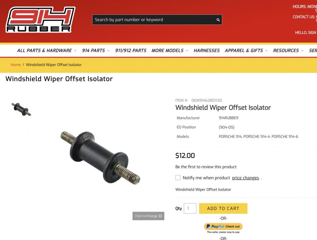

ALSO, your wiper assembly and motor sit behind the fresh air box. That assembly is supported by a rubber foot/isolator that has a bolt running through it and it mounts to the firewall. One nut you'll be able to access from the frunk and the other you can access in the cabin (you have to pull out your speedo to best access that nut).
If that rubber foot on your wiper assembly has never been replaced, it is likely falling apart and will eventually lead to your wipers failing. Definitely inspect that foot and replace it if it looks old (while you're in there). My wipers were failing and it turned out it was the isolator rubber has disintegrated and the metal bolt then snapped.
Here's the part:
https://914rubber.com/windshield-wiper-offset-isolator
