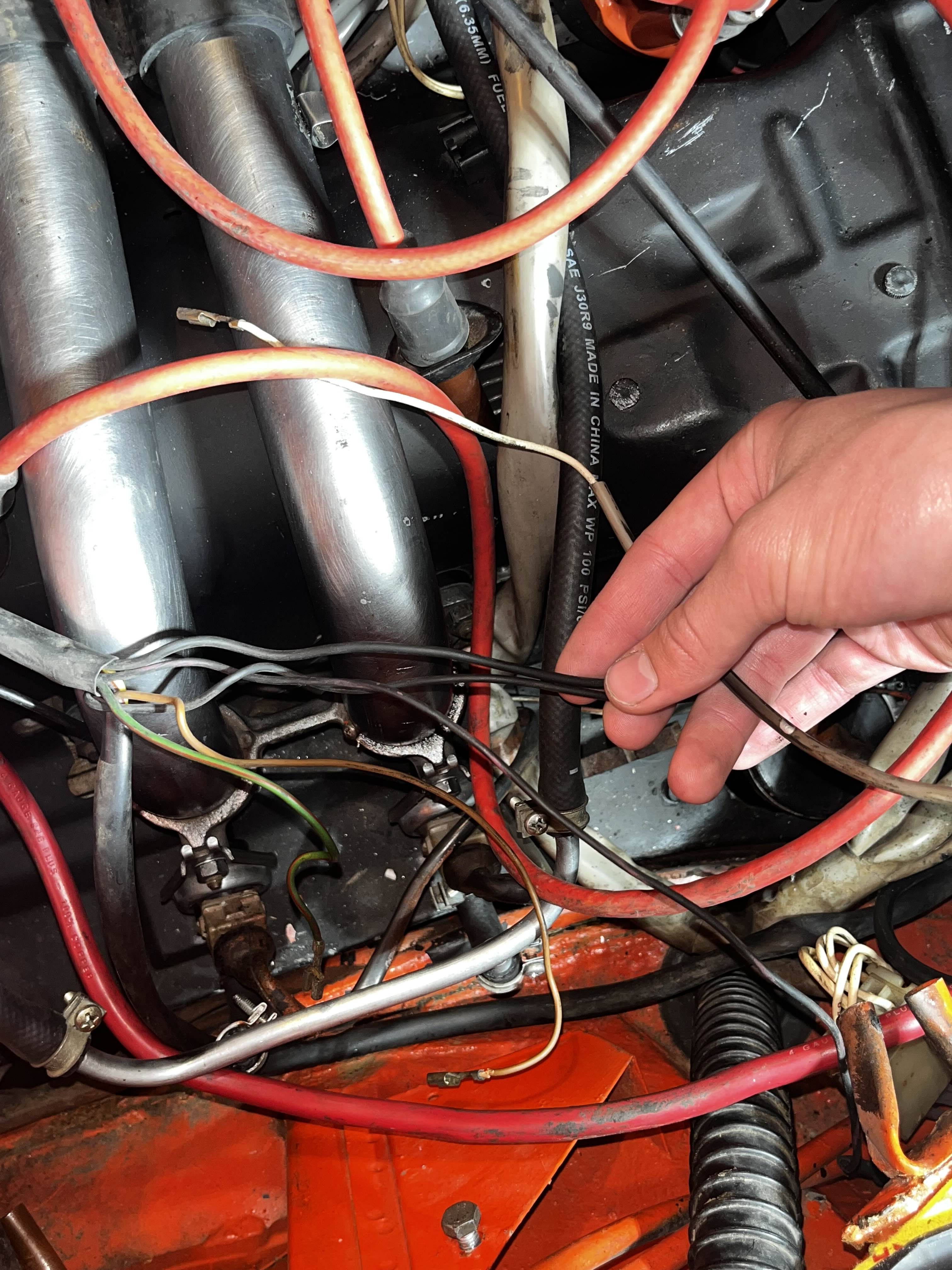

So, its a fully stock 1974 1.8L
https://ik.imagekit.io/bhptmszid/IMG_1928.j...t=1758928645823
trying different ways to add an image but isn't working. so here's an image link.
the white wire (#1) I'm holding is from the main harness, close to the computer.
The two black wires (#2) I'm holding go into one connection.
then there's a green and brown (#3) , brown (#4) , black and red (#5)

This diagram should answer all you questions: https://bowlsby.net/914/WiringHarnesses/doc...74-75_L-Jet.pdf

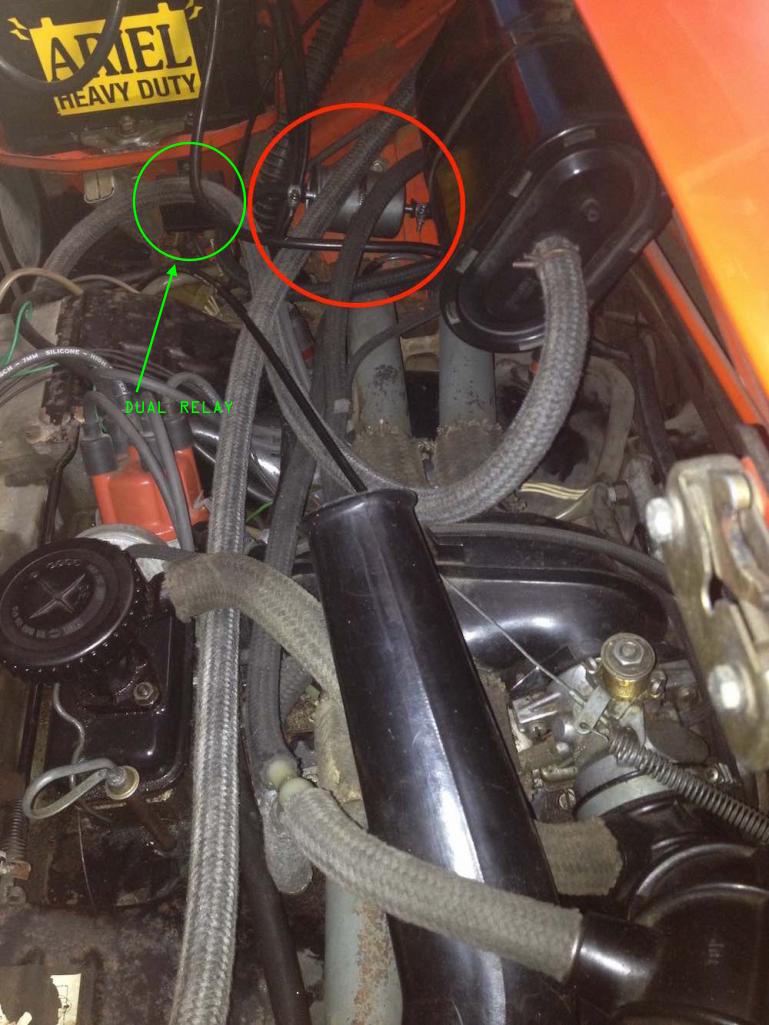

i had this photo lying around from another topic.
dual relay is the gizmo doing a lot of the work controlling the f p.
if its an original d r it will be silver in color.
later update replacement d r is black plastic.
