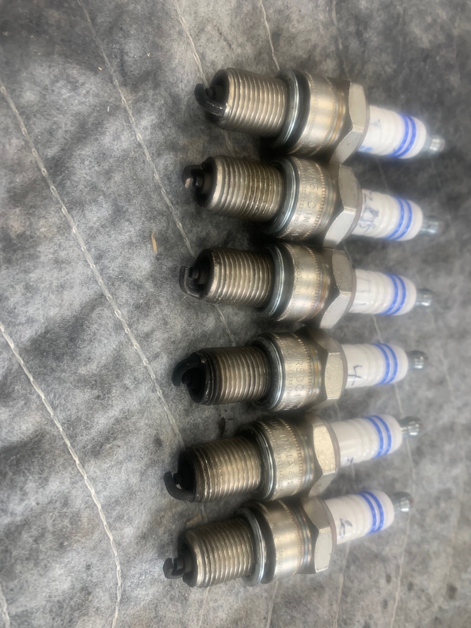

Hi,
I came back to this car after a few major trips and family events……….

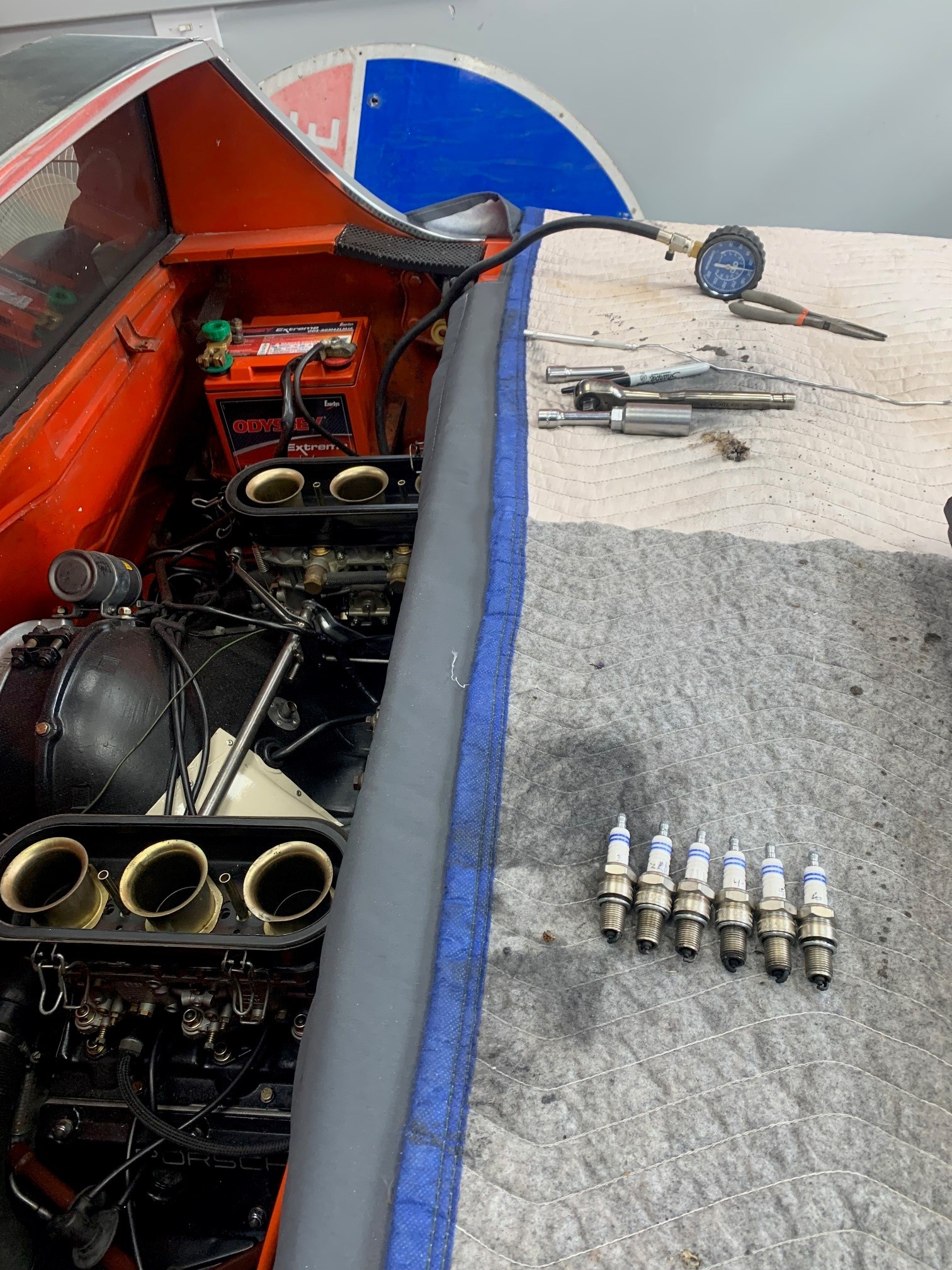

I took all of the plugs out and retested the compression – the engine is super cold (15 degrees out) garage is heated to 40 at all times.
Compression is about the same as listed above – 5lbs less for all cylinders.
I am declaring that compression is not the problem

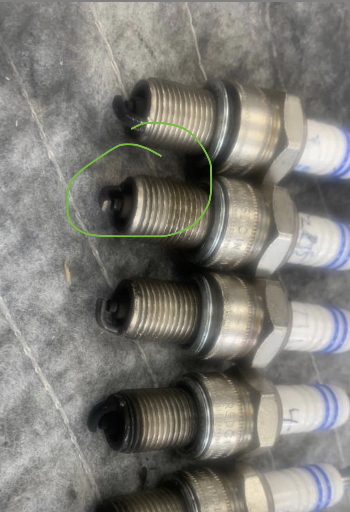

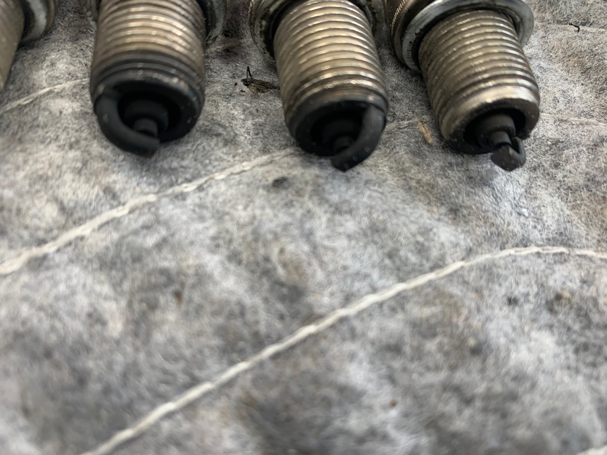

Next, here are the plugs – the 1,2,3 plugs look good – the 4,5,6 are very heavy, rich
I am going to start over – my sense is that it should be possible to get this car to:
Prime sensibly – fuel pressure and then couple of pumps
Start with a couple of cranks
Sustain the running while in high manual idle until warming up
And then, can idle smooth and clean at 900
Here are some pics of the plugs – what would you do next? Ignition?
Plugs 1->6, L->R
Respectfully,
Cary Conrad
Ninja
post Feb 14 2026, 02:01 PM
Post #31
Posts: 323
Joined: 25-September 25
From: Granbury Texas
Member No.: 29,004
Clean plugs, check float levels, run again.
If all of the jets/venturis are identical in all 6 barrels, then float level is most likely to cause richness difference between the two carbs.
Webers are super touchy about fuel pressure. I see 3.5 psi as the TOP limit. Check your fuel pressure with an ACCURATE gauge. A modern gauge for testing fuel injection will not read properly at low pressures.

QUOTE(ctc911ctc @ Feb 15 2026, 06:41 AM) *
Hi,
Plugs 1->6, L->R
Respectfully,
Cary Conrad
Are those plugs any good they look old to me ? see they are Bosch ,looks like the worst 3 are fouling, have you checked for a good spark @ each cylinder ? ,is your CDI wiring good ? points set up right ?
Did you set the float heights correctly and what gauge did use ?,check to see if you have no spill over into the throat's under some throttle that will cause the very rich condition you have .
Don't for a minute think that previous work on the carbs has been done right ,pay to add the following ;
Vent size,
idle jets,
main jets,
air correctors,
emulsion tubes .
This would help a lot ,good luck and report back.

QUOTE(ctc911ctc @ Feb 14 2026, 01:41 PM) *
None of those look good. All are too rich. 3 are way richer than the other 3.
Carbs are not tuned properly.

Thank you EVERYONE for contribution - this has been pretty frustrating - will soldier on!
The plugs are all new, from Pelican - for the engine in stock condition - which it is currently in.
I previously took the carbs apart and measured the floats, their height, relative positioning to the cutoff valve. Used the float level after to check and the level was right at the line. See this thread:
Vent size,
idle jets,
main jets,
air correctors,
emulsion tubes .

There is one plug in there that doesn’t look “terrible” but on the whole they are all rich.
Even the one that is circled is still trending rich but not as bad as the other 5. Normal is a very light grey to brownish. The one plug that is circled could be called grey if you squint and the electrodes aren’t quite as carboned up but it still isn’t where it really should be.
Spend some time looking at these plug charts and you’ll see all your plugs are carbon fouled to various degrees. The three you’ve pointed to are just egregiously bad vs the other 3.
