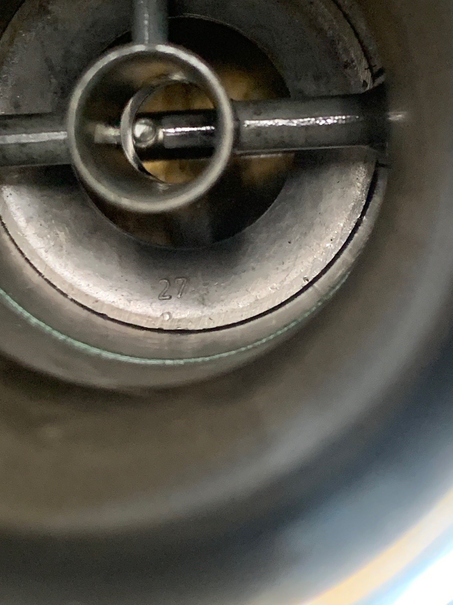

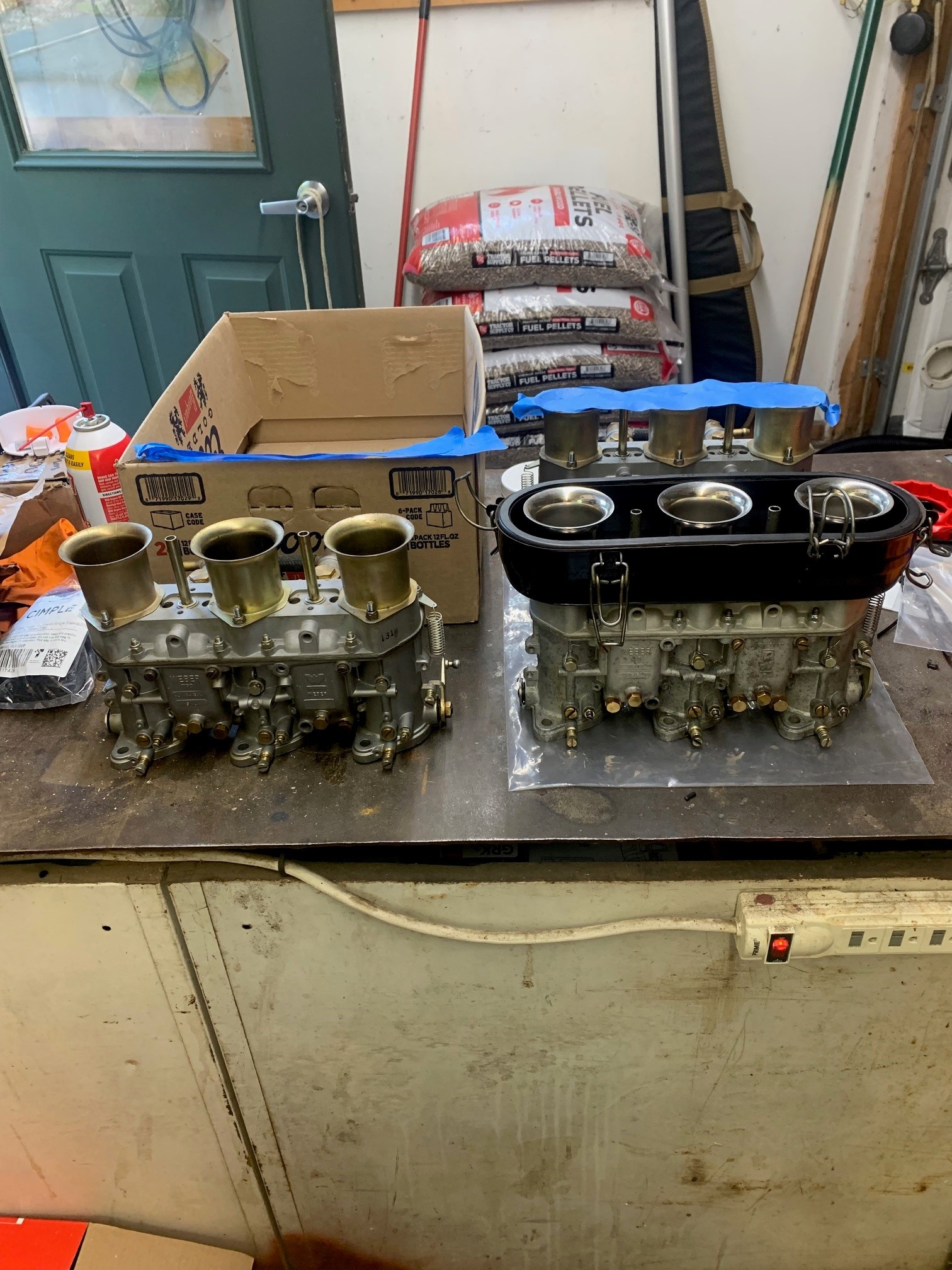

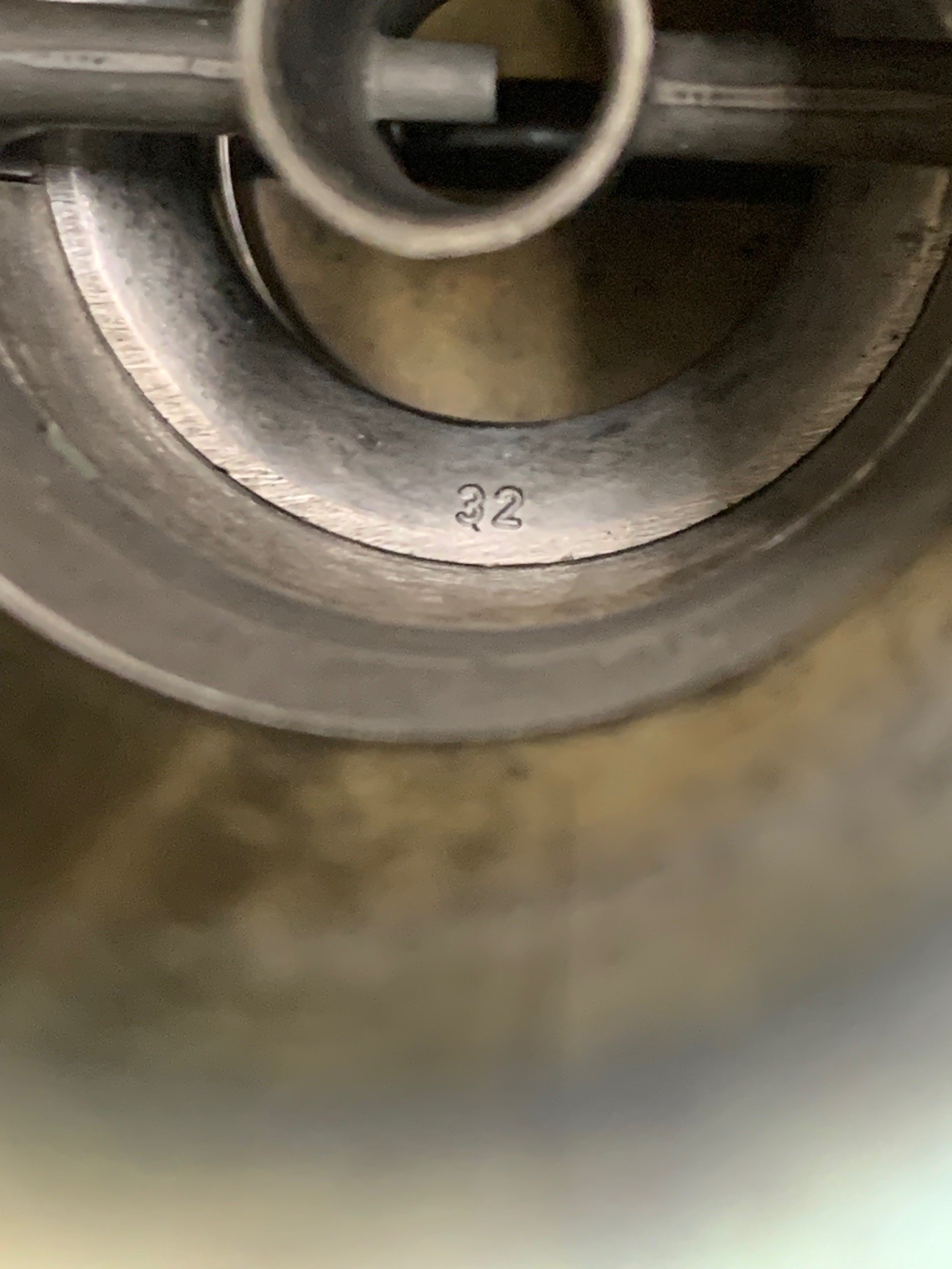

post Sep 7 2026, 05:28 PM
Post #58
Posts: 1,389
Joined: 9-June 18
From: boston
Member No.: 22,206
******NEW INFORMATION********
So, where we last left this puzzle is as follows.
1. Car came with Carbs - Not original but Weber Reproductions in very good shape
2. Could not get the carbs to tune
3. Bought a Set of originals, in very nice shape - recently rebuilt, receipts, etc.
4. Installed the new Carbs
5. Still had the same trouble.
6. Changed the Distro springs - they were not correct, too loose
7. verified timing, right on the money
8. Car started and spitted and popped
9. tried the least Lean method - could not get carbs 2 and 3 to react to the method
10. Clanking was heard from the accelerator shafts bouncing left to right and then back
https://youtube.com/shorts/KFZnitg3QZU?is=92xMfJZFT57ZZkvQ
Was told to spray carb cleaner around the shafts to detect air leaks - when I spray the car idles a bit better if I spray around the carbs 2 and 3, however, it is hard to detect change.
What type of idle change should one expect?
I ordered new teflon spacers and will install them
ALSO
Here are some pictures
Carb that came out of the car on the right, one that came with the car when I bought it is on the left
27mm is from the new carbs that I bought that are original Porsche Carbs.....I just pulled this from the car a few hours ago
32mm is from the carb that came with the car, had all of the original trouble that perhaps was attributable (somewhat) to timing trouble.
Next Step - install teflon on the shafts - measure the shafts for wear.
