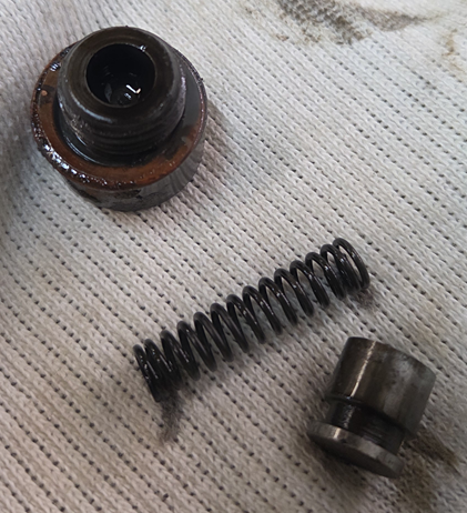

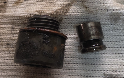

RESOLUTION!
Boy when Jake says check everything that means everything!
I finally figures out (thanks 914world) where the oil pressure control valve is and what fastener it has.
Here are the parts from my 1.7l donor motor.Attached Image
This is what came out of mine.Attached Image
Notice the missing part?
I installed the spring from the 1.7l and cold idle went over 70psi up to 80 with a little throttle. After a long drive idle pressure is 15! So much better then 2.
When I put this motor together over 20 years ago the short block had been assembled by a "professional". We found many problems, but I did not know about the pressure control valve and didn't have an m14 triple square so I left it alone.
Looking forward to some more driving!
FlacaProductions
post Jan 6 2026, 09:50 PM
Post #39
Posts: 2,278
Joined: 24-November 17
From: LA
Member No.: 21,628
Good work sticking with it - congrats.
930cabman
post Jan 7 2026, 11:01 AM
Post #40
Posts: 4,833
Joined: 12-November 20
From: Buffalo
Member No.: 24,877
Those German boys (and girls) didn't include many "extra parts", glad you got her fixed. The oil had been bleeding away without the spring in place
(IMG:style_emoticons/default/cheer.gif)
forgot to ask, engine builder was (is) a professional ????????
