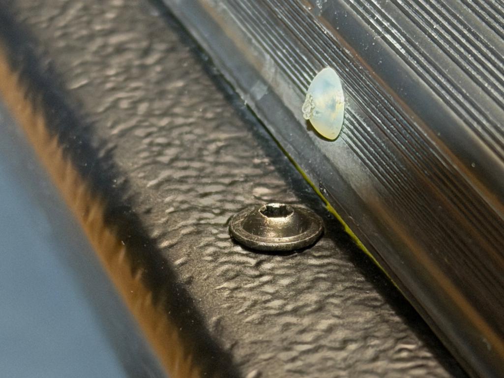

chmillman   In the end I went with screws - because I found th...   Dec 8 2025, 05:26 AM
Aayala   In the end I went with screws - because I found t...   Dec 8 2025, 10:40 AM
chmillman   Do you mind taking a picture of where you install...   Dec 9 2025, 04:17 AM
