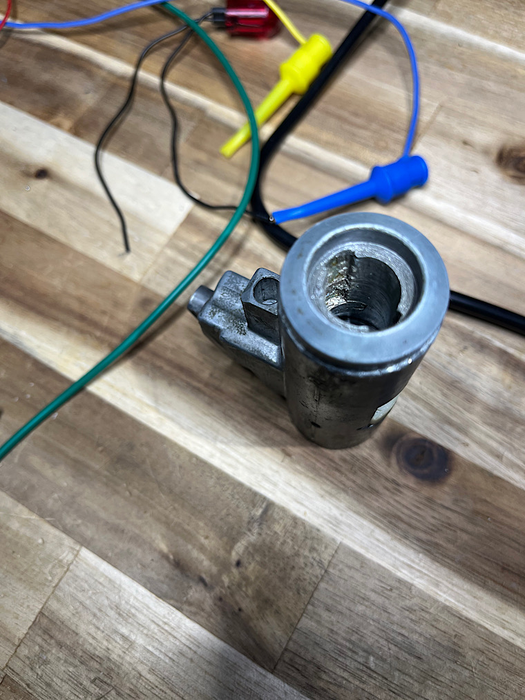

Here’s an example of housing that has gotten groved and leads to sticky / binding when the wafers are hanging out proud to the cylinder

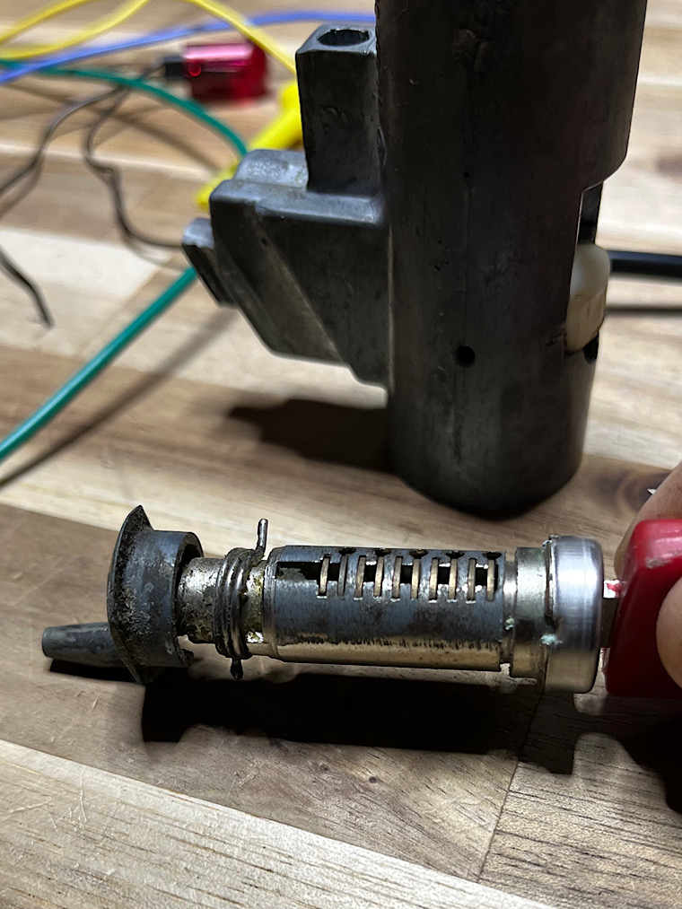

And here’s a shot of a key cylinder (door) but the concept is the same for all. This one is a good one where the wafers are all flush to the cylinder. As keys wear (or aren’t inserted fully) a wafer hangs out and can get caught in a worn housing groove Attached Image
A good cleaning and re-lube may help (little metal particles get caught between the cylinder and housing).
The actual electrical switch has nothing to do with the cylinder jamming up.
