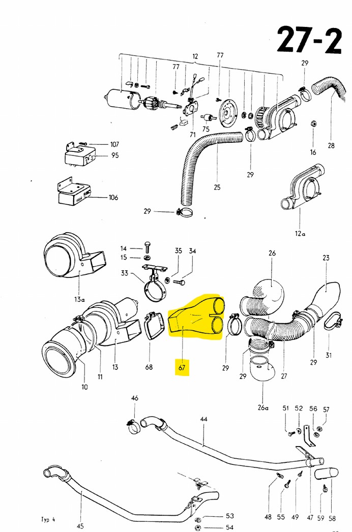

its actually a part from a VW 411/412 variant (square back). the y splitter.
if you can find one of those cars (almost as rare as a 914?) in a junk yard and the heater hoses are still there on the engine you could score one.
the 74-76 came with just one hose, left hand side in original form. the dual hose set up on the later cars is not a factory thing its a dealer and owner mod back in the day using the VW part. unique to the variant version of the 411/412.

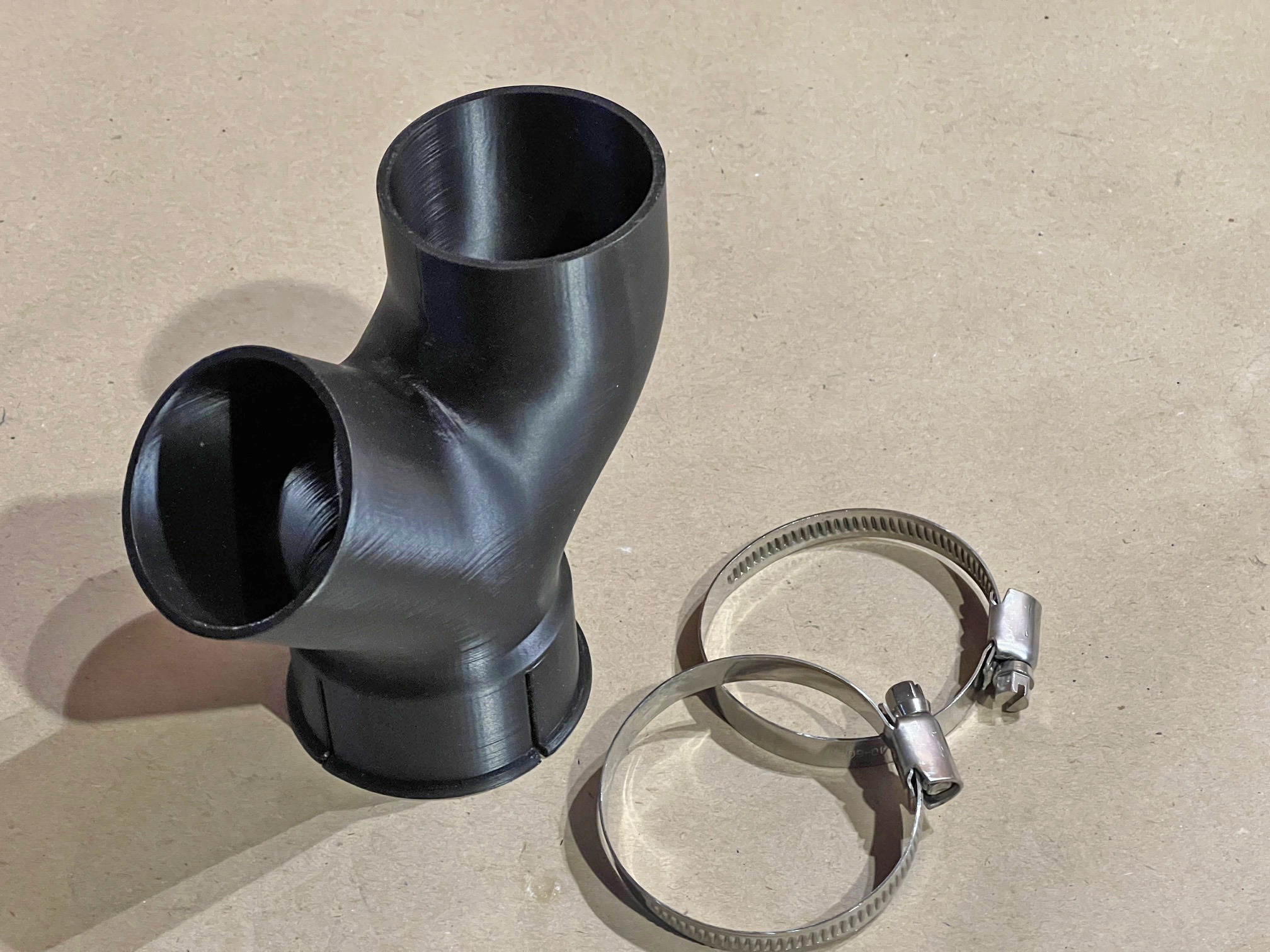

There are a number of threads here on people who have designed and 3D printed their own versions of the Y connection, with files posted to download. I have mine done here, just haven’t installed it yet. There is a bit of debate about its real usefulness IIRC.

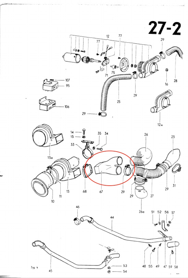

it is not in the 914 PET catalogue.
what is listed in the PET is the standard square to single circular adapter piece for a single hose.
these parts are all listed at the very end of the section on the exhaust system page.
along with the later fan. all clumped together after #48 on the diagram. they have no numbers which reference the diagram and the later fan set up for 73 onwards is not drawn in the diagram.
where it is shown is in the parts catalogue for the VW 411/412.
but i do not have a part # for it.
just the diagram from the 411 catalogue.
this.
the way it went is that the 411 always had two different blower fan set ups.
the 4 door and 2 door sedan had the blower motor with two outlets either side and two hoses centrally mounted above the fan housing. early 914/4s used this set up.
70-72.
the variant (station wagon) 411/412 with its much flatter engine bay under the rear cargo area used a single outlet fan offset to one side of the engine with the adaptor transition piece that fitted to the square outlet on the fan and branched into two circular outlets for twin hoses. later 914 1.7, 1.8 and 2.0s used this variant fan but had their own unique adaptor transition piece that went from a square fan coupling to a single circular opening. that unique standard part for the 914 is what is listed in the PET.
you would need the VW parts catalogue for the type 4 to reference the part #.
but it would not be much use as this part is long not available from VW.
if you wanted a reference part to copy in order to make the adaptor your best bet would be either a junked 914 that had the modification part fitted or find a junked 411/412 variant with it still in place.
what was happening with the twin hose set up is that either dealers worked out this mod was possible, given it was VW parts, and offered it to customers or owners somewhere along the way in the 70s figured it out and did the mod. but the twin hose set up you see on some 73-76 914s is not a factory set up or factory option. why its not in the parts catalogue.

Here's mine again just in case. I didn't want to remove the square-to-round part from the blower, so it is designed to go over the round part. The longer end points toward the passenger side of the car, the shorter end is angled upwards and should work fine with the existing hose.
It was designed to be able to be printed without needing any supports. I have a CAD file (STEP) if anyone wants to continue to work on it/modify it.

QUOTE(chmillman @ Oct 20 2025, 01:03 AM) *
That is a very nice print. What is the material?
