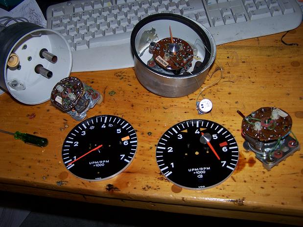

So, while I had the steering wheel off to fix the ignition switch, I thought it would be the perfect time to fix the other problem I had - the high beam indicator light wasn't working.

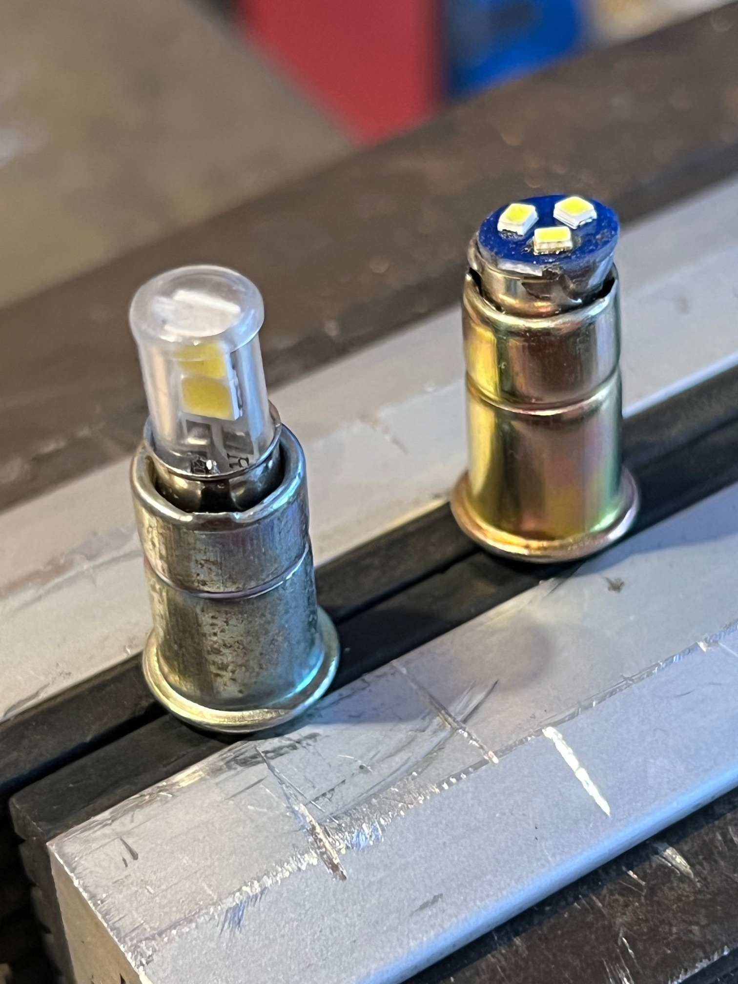

Previously I was able to pull the gauge panel partially out with the steering wheel still on, in doing so I was able to replace the existing dash lighting tungsten bulbs with LED's - but I could never get the bulb for the brights indicator out - it was stuck in place and impossible to remove in that position.
So finally with the steering wheel off, I disconnected the various wires and pulled the whole tach gauge out. Then, on the bench, I was finally able to gradually work the brights indicator lamp holder out of the socket in the gauge. Mine is a '74, but it actually has a '73 or earlier tach, with the individual left/right turn signal arrows at the top (which I much prefer over the later version) and the brights indicator at the bottom.
I pulled the existing bulb out and tested it... and it worked. I was like huh? Why am I not seeing it light up in the gauge? So then I held the gauge up to the light and looked into the socket hole to see if I could see anything. Nothing. Then I tried holding the soocket side against a really strong light and looked from the front - and then I dimly saw some blue light...
So I surmise that over 50 years, the blue plastic has simply aged and gotten darker, to the point where it's almost opaque.
Nothing I can do about that short of having the gauge rebuilt - which it doesn't need, the tach works perfectly, as do the turn signal indicators. I put in the brightest front-facing BA7 LED's I have been able to find - the right one in the image below. I have one of these already in the green parking lights indicator on the speedo and it's almost too bright.
Now I can kinda sorta see a faint blue glow if I'm driving the car in the dead of night with the high beams on. During the day though, it's still invisible. So if you think yours is not working, it might be the same as mine.

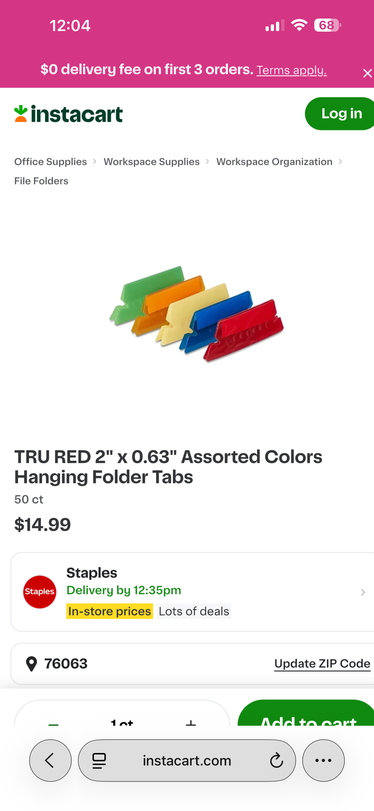

The trick I used was the use colored tabs for hanging file folders. I did this for the ‘low fuel’ light as well. If I remember correctly I had to double or triple the thickness on the red. Looked great with just the little red plastic piece in there but once the light turned on the material was so thin the light looked almost pink. Just added two or three pieces to make it thicker (they were taped on) to achieve the right shade when the light was on.
