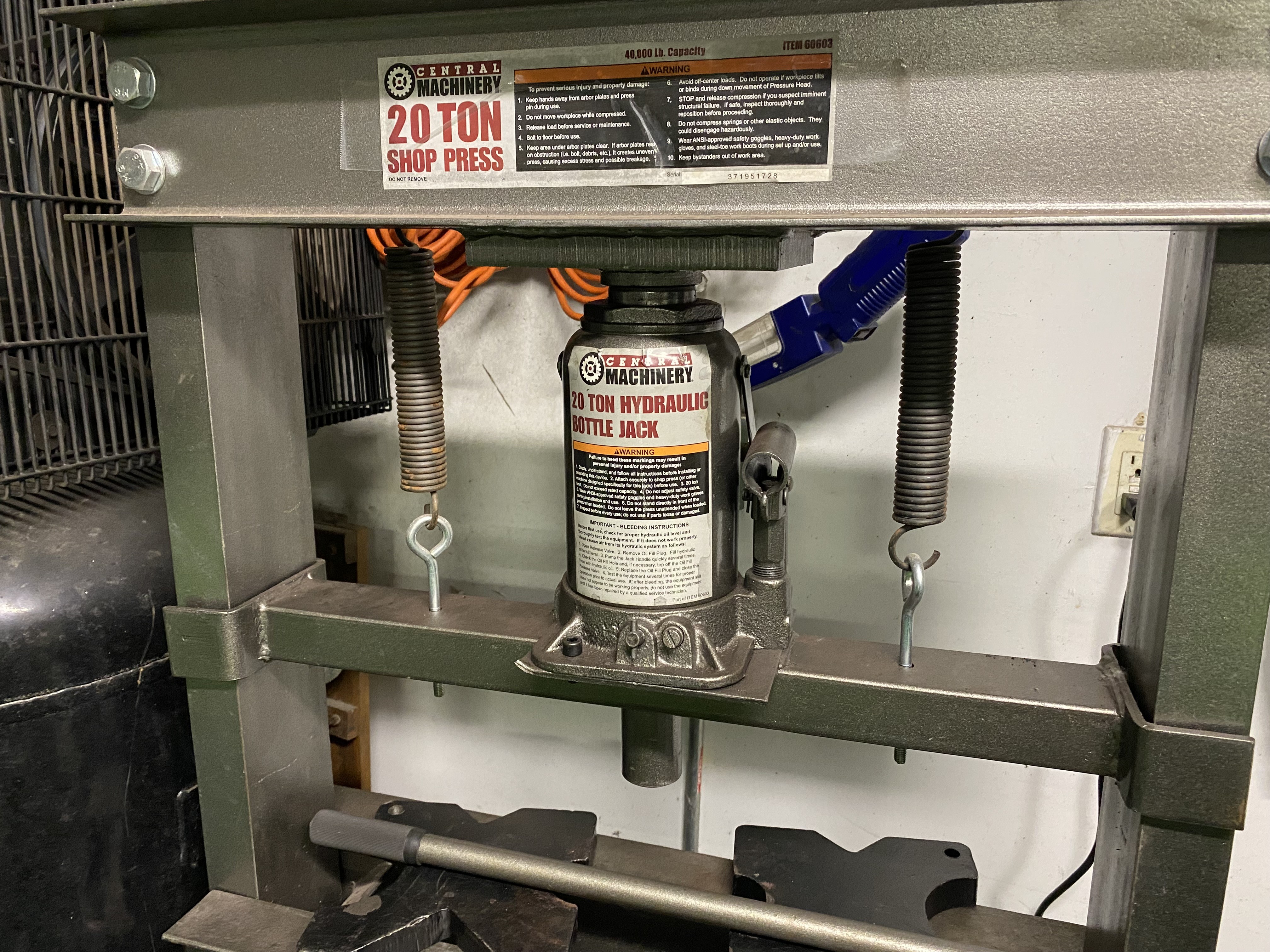

I bought a 20-ton Harbor Freight press for $100 at an estate auction. I have found it to be an invaluable tool. I have used it for removing and installing wheel bearings, suspension bushings, crankshaft gears, and even stubborn rusted bolts in exhaust parts. Much safer and more controlled than the hammer.

We have that 20 ton HF at our shop. It works fine but lacks the ability to adjust the width of the crossbar. We are doing about two trans a month but that will probably increase once we move into the new shop. We’ll be getting a better press shortly.
