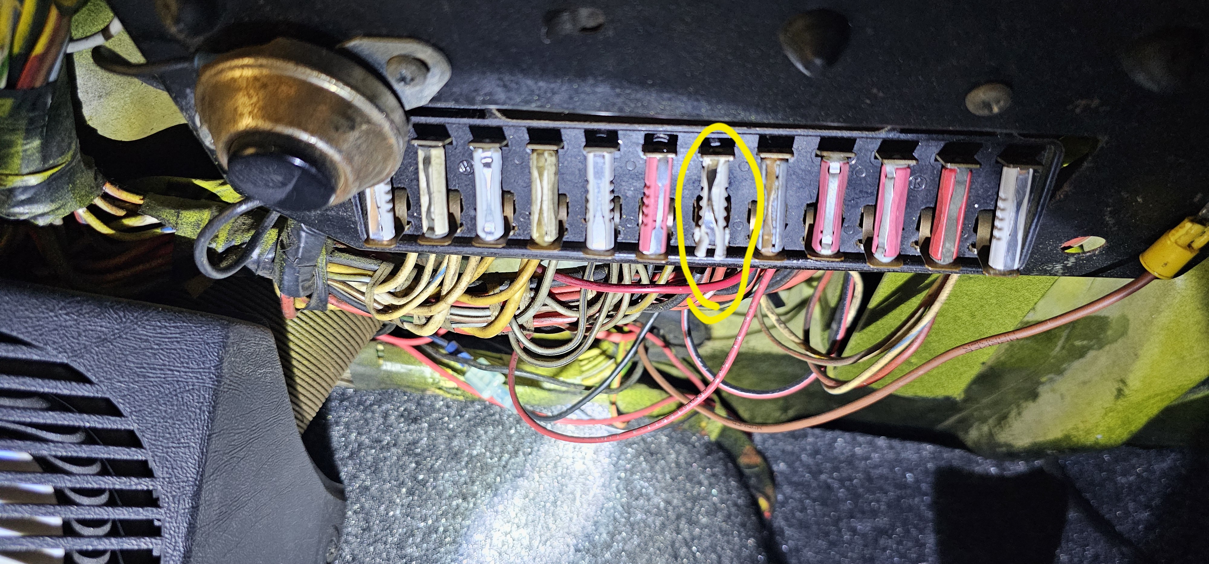

Sunday morning as I was pulling out of the driveway I noticed a flash under the dash, then i realized the gauge lights were out.
Worked on it last night and put in what is labeled as an 8 amp fuse (from Amazon)
Turned lights on and after a minute or two it melts the fuse.
Tried it again tonight and same thing.
I was under the center console recently getting my blower motor control lever to make the fan work (turned out to be fuse in engine compartment)
I don't think i disturbed anything under there.
Any thoughts on what else to look for?

When I was fitting my 6cyl gauges I had a failure with the dimmer ,when turned it had a dead short ,ended up bypassing it and no more blown fuse ,I wasn't worried as I have led lighting so no need for it anyway.
I 'am not aware that you can repair the dimmer as mentioned I had no need to ,cheers
