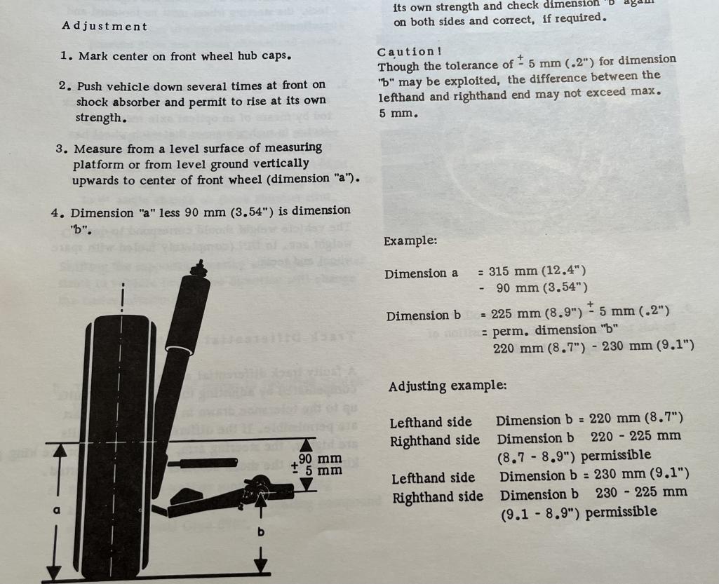

Taking a measurement from the "donuts" on the underside the front sits 1 inch higher than the rear. (Front == 6.75" and Rear == 5.75"). I still have some adjustment left in the front to lower, but not sure how low the car should be lowered. My understanding is the rear should be slightly higher.
Center of the wheels measure right at 12" and the torsion cap is 7.5" (center to ground). Based on the manual I should technically need to raise the front to get back to within factory specs, but I know the car isn't running factory springs.

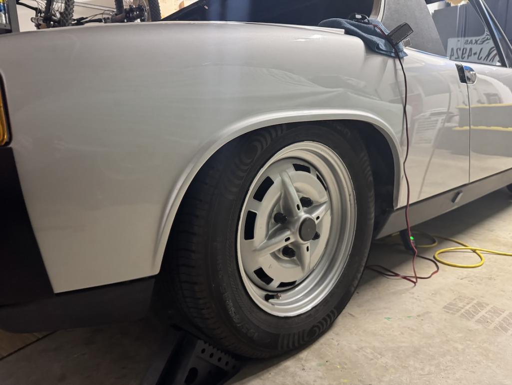

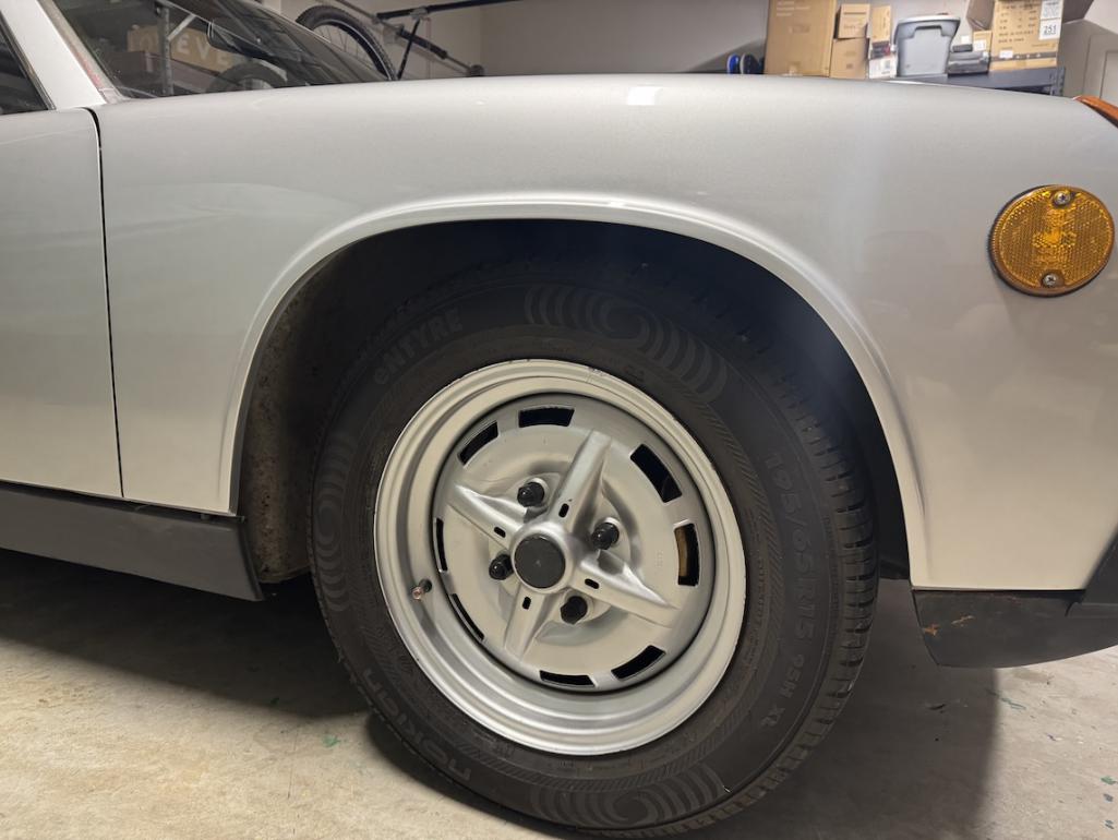

Thought I would add a couple pics for reference

IIRC, the stock height is taller than most like.
I adjusted mine to look like most of the other 914s I see, so I can't give you exact dimensions of what you should be aiming for. Your rear ride height is similar to mine, but my front looks lower. I like for the front to be a little lower than the back, but not so much that it stands out.
What I can offer is that you need to ensure that you're car is on level ground to get it right. Any adjustment you make on one corner can (and likely will) impact all other corners. If you're not on level ground to start with, you'll be making adjustments in the dark.

You might know this, but the factory spec for front ride height is based on the angle the A-arm makes. And the rear was not adjustable.

The factory ride height is the difference between the center of the front wheel and the center of the torsion spring. The stock number is 90mm +\- 5mm. This is measured with a half tank of fuel and the driver’s weight in the left seat.
Raise the front to unload the torsion springs to make adjustments, otherwise you can break the adjuster screws.
I like the front of the car to be a little lower. I measure along the bottom pinchweld, as far rear before it curves up, and as far forward before it curves in towards the center. About 1/4” lower in front seems to work well. You can go a little lower but never higher in the front.
