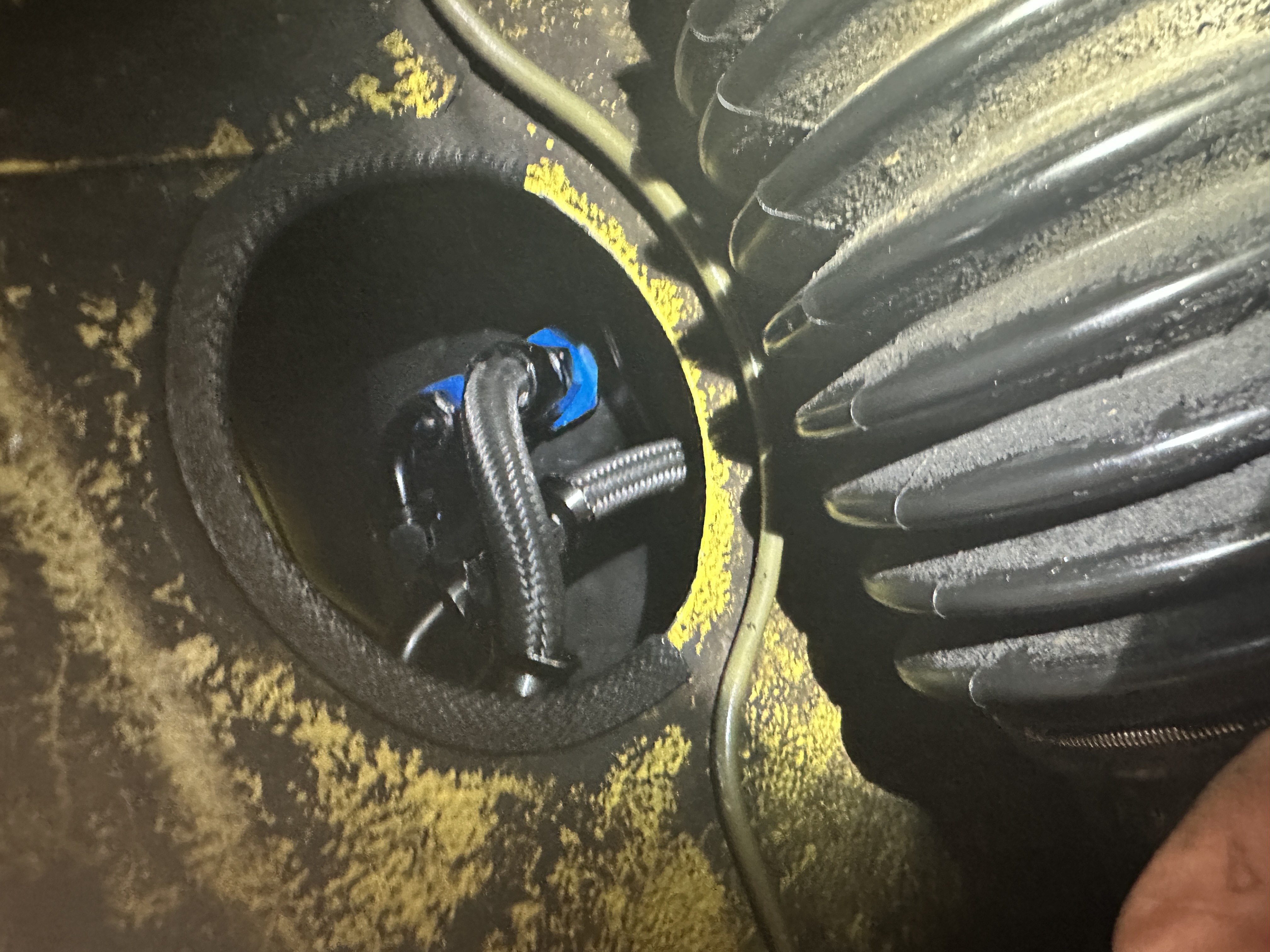

rfinegan   Wrapping up the new fuel tank and AN lines today. ...   Jan 11 2026, 08:26 AM
