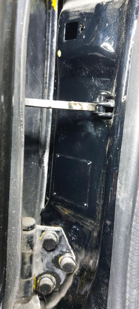

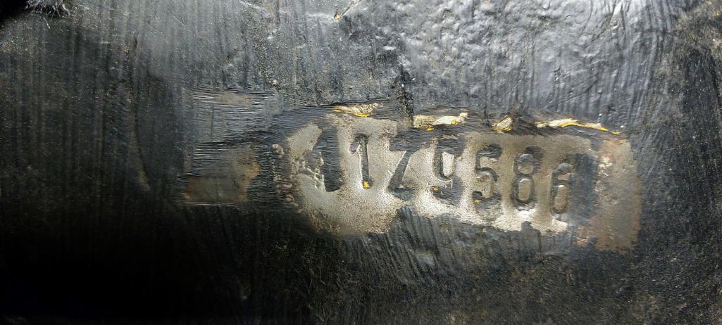

Yes. Unfortunately "Karmann" plate is gone. But I´ll try to locate the stamped body number.
I´m very sorry, wasn´t sure if posting full VIN number is a good practice here.
Here´s my full VIN if "historians" can do their magic.
I managed to find my "Karmann plate" (IMG:style_emoticons/default/headbang.gif)
But was lucky with the stamped body number (IMG:style_emoticons/default/party.gif)
Do we think we can find some information about my car now, please? (IMG:style_emoticons/default/pray.gif)

Is that 1129586?
If so:
Body number decode:
1129586
First number or two numbers is week of year.
second or third number is day of the week.
9 indicates Karmann factory.
5 indicates the first hundred cars for day. 6 used if exceeds 100
last two numbers indicate which number car it was for the day.
So
11 = week 11 Monday, March 15, 1971, to Sunday, March 21, 1971
2 = Tuesday 16 March
9 = Karmann
5 = First 100 cars of the day
86 = 86th car of the day
However the VIN number does not appear to be in the 914World database
http://www.914world.com/bbs2/index.php?act=membervins
BTW, if you carefully pull the Karman plate and use some paint remover, you might see the numbers as they were engraved. Would also tell you the original paint color code.

don't think its 11 at the start of that body stamp for VW production plate number.
using Vin data base here you can get close to OP vin of 07729.
914world vin data has a 07746 and VWpp# is 4459577.
the first number of the stamped number is really hard to discern accurately from photo posted and the second number is a little bit clearer but not much.
my bet is its actually 44 going off close proximity to vin and vwpp# that is 17 cars different.
which would make it a tuesday car of the 44th week of calendar year 1970.
model year 71 being from aug 70 to june 71. (IMG:style_emoticons/default/beerchug.gif)

Well, if you can get ‘44’ as the first two numbers, you’re a better man than I… if you look at my stamping - which actually does begin with 44 totally coincidentally - you can see the angle of the ‘4’ looks quite a bit steeper… Anyway, maybe trying to remove the paint from the painted over Karmann plate might give you more clues…

using the vin register. the 11 for a march 71 build equates to a vin in the 11204 vicinity. see 11204 on world vin register with vwpp# 1139544. in other words the next day from the OP's vwpp if its an 11 and not a 44 as first two numbers. there are a few either side of 11204 vin also with the vwpp#s in the 11 first two numbers range.
what i can see is the top third of two 4s with the rest of both numbers obliterated either by surface rust that has been treated and painted over or a dent from below.
44 equates with his vin and the range it would be in.
only other explanation is a car that got pulled off the line and sat for 8 + 11 weeks (close to 4-5 months before it got rectified and given a vin. i think that would be less likely than 44 being the number not 11. (IMG:style_emoticons/default/biggrin.gif) (IMG:style_emoticons/default/biggrin.gif)
one way to know a bit more clearly is to clean the overpaint off the karmann plate.
or if its got its original dash that has not been molested to look up there. the number will be visible in crayon on the underside of the metal dash frame. takes a bit of looking to see it and find it but its usually there as well. (IMG:style_emoticons/default/beerchug.gif)

The first stamped number is maybe 1 but it can be also something with round bottom part (5). I promise to try to clear the number hopefully tonight and post another picture. The second number is 1
I´ll try to clear the paint off my "Karmann plate" but it can take some time due to my oncomming Xmas travelling.

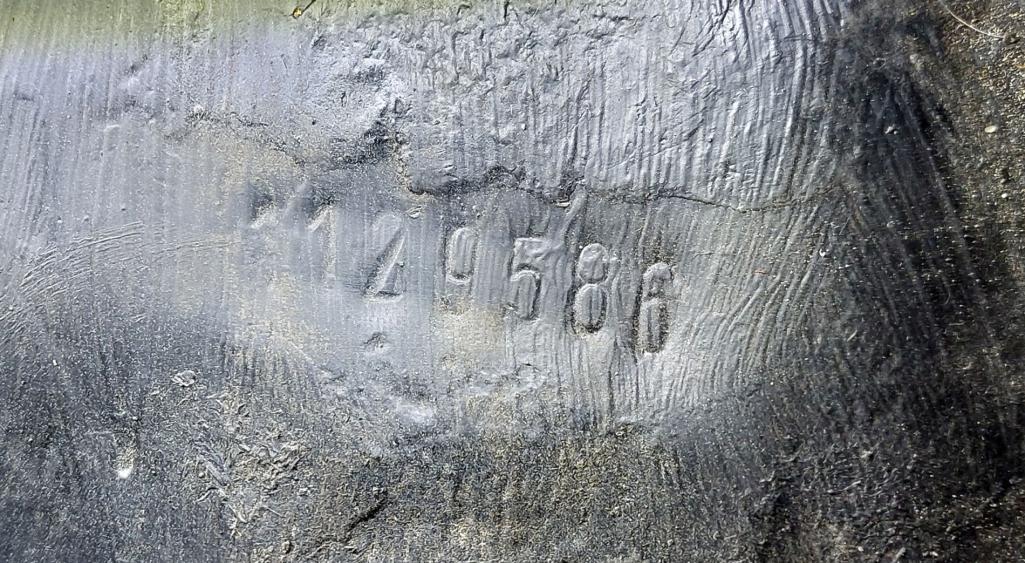

And the winner is ....... Mr. chmillman (IMG:style_emoticons/default/cheer.gif)
I also removed driver´s door and stripped Karmann plate. This confirms body number 1129586 (IMG:style_emoticons/default/smilie_pokal.gif)

Cool! OK, so I assume my original decode is correct? Made in March of 1971?
Doesn't quite explain the VIN number, but I don't know how those are attributed.

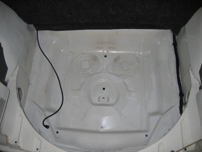

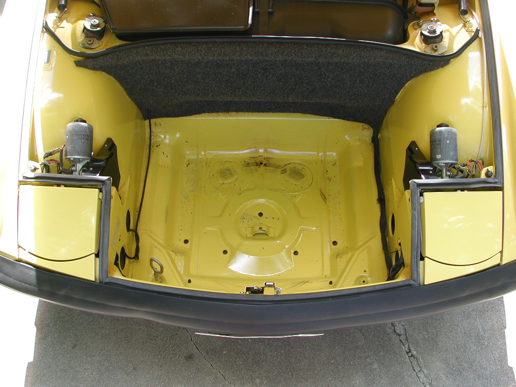

Your original color is L13K - Sunflower yellow. Looks like the black sunflower spots grew to cover the whole car... (IMG:style_emoticons/default/biggrin.gif) I do see a touch of yellow under the black where you sanded the number in the trunk...

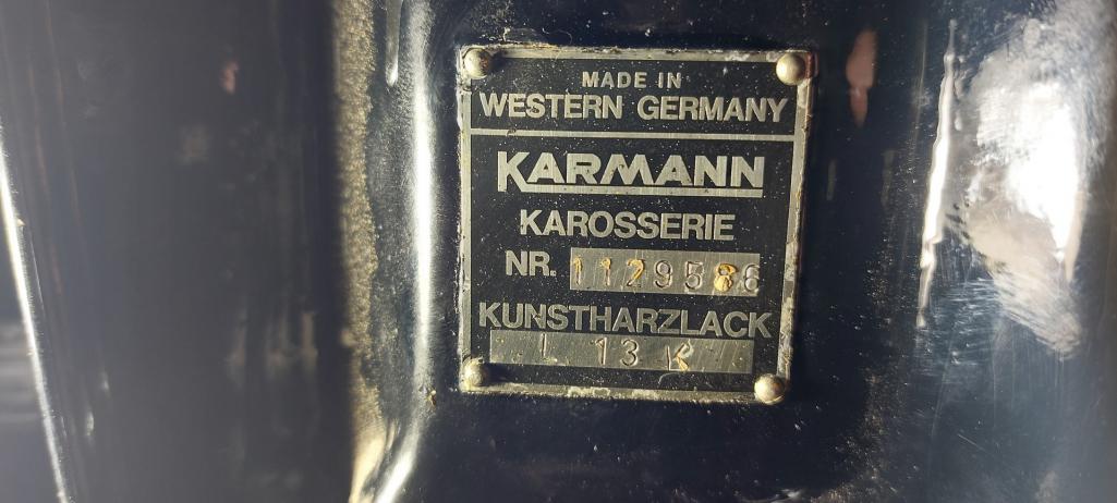

Your guide to locate body number and Karmann plate helped. Many thanks.
Shame it can´t help to identify what wheels and interior trim and other extras it was supplied with and who was the original owner.
Yellow colour is lurking everywhere - boot, trunk, under door cards etc.
Me and my wife already have black, yellow and red cars. I´m ready to respray 914 but still unsure to what colour. I´m seriously considering blue or modern grey.

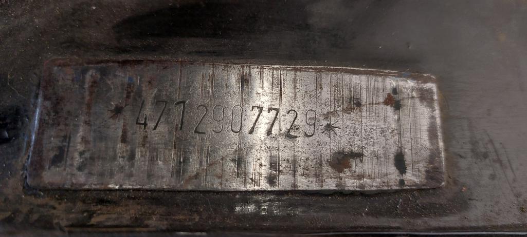

Funny enough L13K is listed only for 1974 but my car is 1971. Can someone explain it, please?
This car has proper VIN and rivetted label so it must be genuine 1971 (IMG:style_emoticons/default/popcorn[1].gif)

Yeah, that is odd. L13K is also listed for 73, but not 71. One wonders if someone put on a repro body plate at some point… Total mystery.

Lets figure out your model year.
Does your front trunk look like the white or yellow car below?

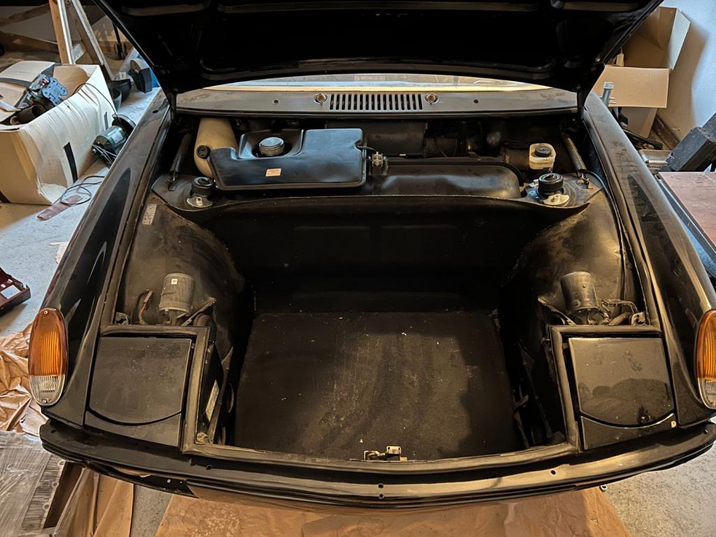

Yellow example, please.
This is my frunk:
There are some hints of the original Sunflower yellow in hidden corners too.

You need to lift the trunk floorboard to see what’s underneath.
If your car was originally made for the US market and delivered directly in the US, then there is the following: in ‘73 the curved reinforcement you see in the frunk on the white car above was added to the US models along with the bumper horns. However, the Euro models did not get either of those - mine is a 74 delivered in France and has neither.
I see both holes in the sheet metal near the headlight area, the reinforcement seems to hide the front most one in the pic above, so it looks to be absent.
Add to that that there are no side marker lights on yours - unique to the US models I think. They may well have been removed however. Do you see any evidence of that - patch welded in where they should be? I’m just wondering if it’s certain that the car was originally delivered in the US. If so, and the reinforcement is not there, it’s highly likely that it’s pre-73.
But of course I defer to the real experts…

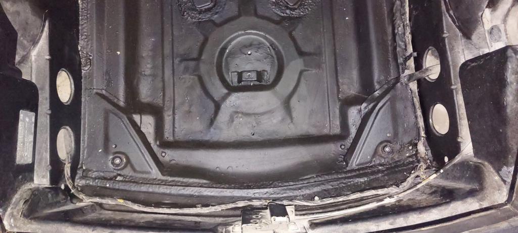

Very sorry. Wrong picture.
No brace there

@chmillman has better eyes than me. good thing i am not a pilot. (IMG:style_emoticons/default/biggrin.gif) (IMG:style_emoticons/default/biggrin.gif)
but since the vwpp# is an 11 matching the karmann plate that settles the question of the vin i was highlighting. the 7000 range its in is not right by a long shot. let alone the L13K yellow paint code which is as pointed out a 73 on color only.
a couple of other observations. the dash is not right for a 71. it would have had a central demister vent and would lack the side vents at either end of dashboard in the dash face. additionally the seats and backpad are the dual fixed seat variety.
the interior is at minimum a 72 onwards. has end vents in dash and two adjustable seats.
my conclusion is that its likely the car is a cut and shut job. 71 front end cut and welded to a 73 or 74 from the tank or thereabouts back. or perhaps a right front quarter replacing the original, but the spare wheel well tends to indicate its an entire 71 front end.
its probably a 73 with a 71 front cut and shut. the dash heater vent controls might be a give away if that is the original dash. i think the heater slide controls were slightly revised from 73 to 74. not sure. jeff bowlsby could probably tell.
additionally taking a close look at the engine shot. it does not appear to be a 1.7 or 1.8 block. no engine number in the usual spot that i can see. and i don't think its a 914 2.0 due to sheet metal but i could be mistaken. the fan casting is definitely of the type found on bus engines. the timing hole is not drilled out.
maybe the greek registration details are correct where it is identified as a 73?
somewhere along the way something happened that required complete replacement of the front end and the VIN was not swapped over.
very mysterious.
the vwpp# (karmann number) is likely relating to 11th week of 1973 production date.
in answer to chmillman question - when is the vin applied or allocated.
vin is done right at the end of the production line. when car is complete.
the vwpp# is assigned right at the start when the body shell is completed.
that number is a build sheet number and follows the car down the production line. its on the top of every vw build sheet.
its not particular to the karmann factory - every vw built at that time used the coded numbers with adjustments to what the numbers where depending on the model and the factory it was being built at.
given the vin allocation in the production sequence i can understand a car with an earlier in the model year vwpp# getting a Vin number much later in the range. the car or body shell might be held over and then much later completed. either weeks out of range or maybe even months. what i can't understand is an earlier vin (in terms of range and date) being assigned to a later vwpp#. i don't think vin plates sat around on the shelf waiting for a car to be built. the vins were all stamped and assigned on the day the car was completed. anyway its academic when it comes to this car, there is no way that vin and front goes with the rest of the car including its vwpp#.
