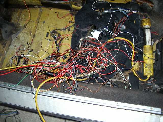

This is the mess that exists behind the dash. There's about 10lbs of wire there.

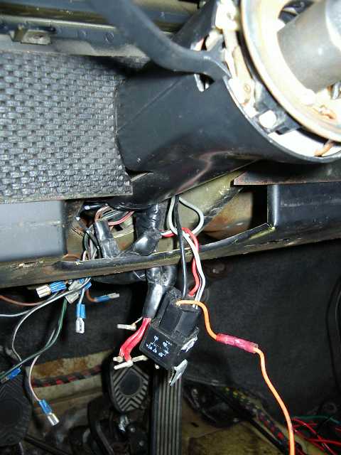

Here's an example of PO hackage: this relay is NOT OEM. It's tied in directly at the steering column, and took some doing just to fish it out. No clue what it was supposed to do. The white/black wire isn't part of the OEM wiring, but disappears into the steering column harness. The orange wire with the pink connector goes off to nothing.

The wires dangling from the steering column with the blue insulated spade connectors are from the turn signal/high-beam switch. This is a '71, so there's no stalk on the other side. The wiper/washer switch is on the dash. The connections out of the ignition switch all lead into a connector very like the connectors on the relay board. I've disassembled it in this photo.
