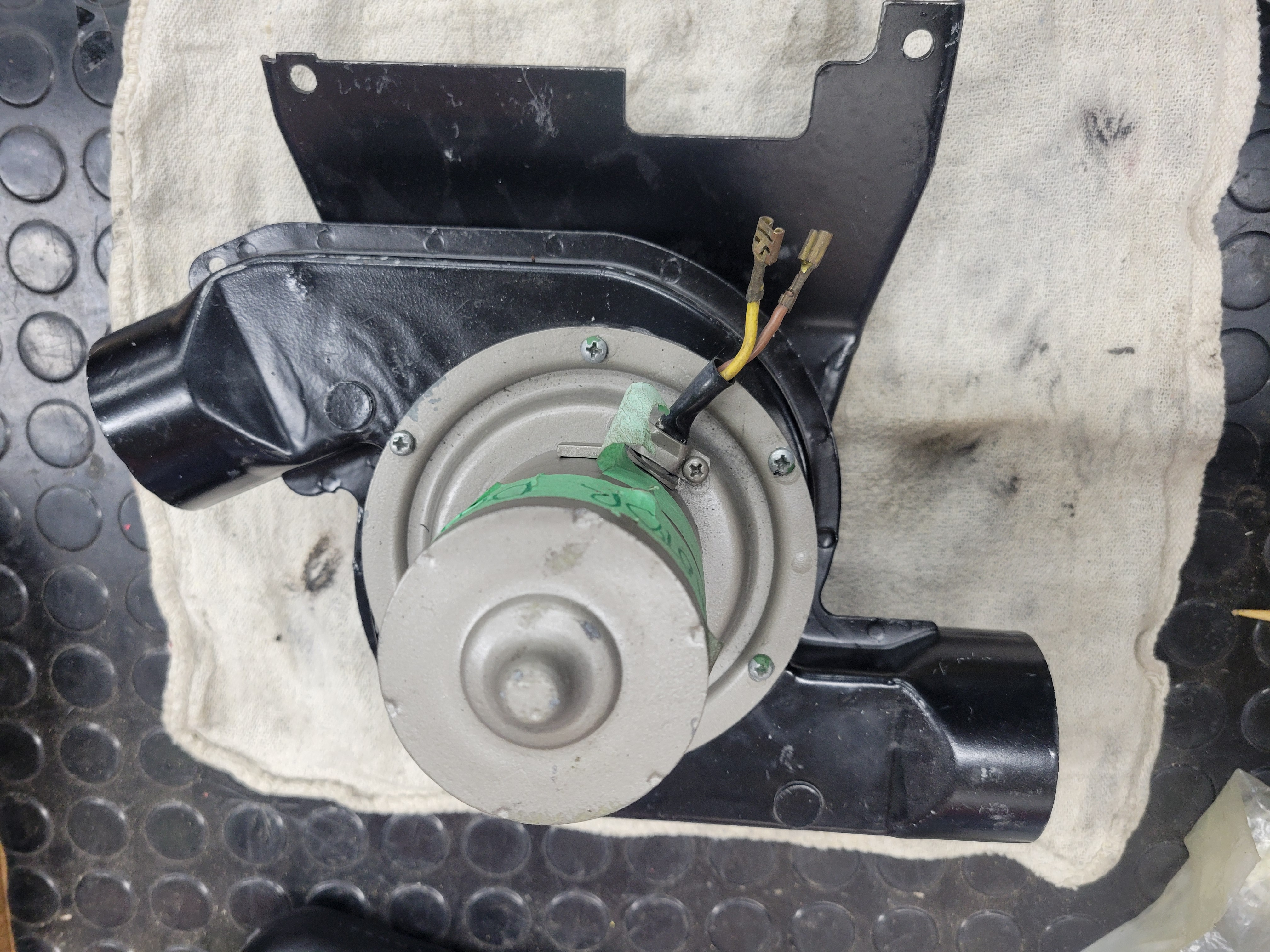

I have a 1973 914/4 2.0 which is is partially disassembled.
It came with two hot air blowers:
Single Port - Working Motor
Dual Port - Dead Motor
In 1973 there was apparently a switch between the dual outlet blower to a single outlet with a Y pipe.
I was thinking I would like to use the dual outlet one so I thought I would swap in the working motor.
Two questions:
1) Does the dual outlet unit provide better heat flow through the heat exchangers than the single outlet with a Y connector? Any pointers to pictures of each type mounted/hoses?
2) How to remove the motor:
Removed the 6 screws on the motor flange
Removed the nut/washer from the cage fan
After doing so I can get zero movement from the motor from the housing. Even prying between the flange and the housing nothing moves.
Does anyone know if there is some kind of adhesive between the motor flange and the housing? If so do I apply a little heat maybe?
Thanks in advance
Scott

I have received the splitter from AA and tried it on my single outlet fan. Output is poor.
Regardless of which way I place the splitter the flow is minimal.
Moving the exact same motor/fan assembly over to the dual outlet housing the output is extremely powerful on both outlets.
I have an anemometer I am going to try this week to measure the output in all the combinations. I will post my results.
Initial thought is if you want really good heat you will want the dual outlet housing from the earlier cars.

I was finally able to separate the old motor from the dual outlet body with a little heat. It appears to have been bonded somehow. Not sure if that was a factory setup or a PO.
