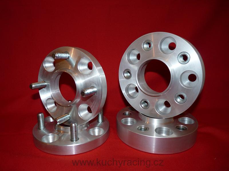

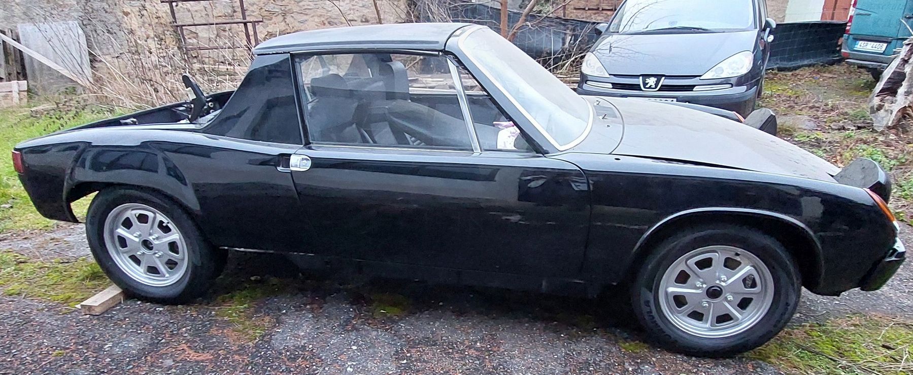

I´d like to replace my 4 lugs baby Fuchs for something a bit wider.
Unfortunately I can´t find any wheels 6x15 or 7x15 at 4x130. (IMG:style_emoticons/default/headbang.gif)
Therefore I decided to go for conversion plates 22mm thick to go from 4x130 to 4x100.
And use Japan Racing JR3 7x15 4x100 ET25 White 67.1 wheels.
What do you think about such combo, please?
I may like to go on 205/60 R15 front and 225/50/15 rear. Or maybe 205/60/15 all 4 corners.
This will require wider fenders
Or maybe Japan Racing JR3 7x15 4x100 ET40 plus 22mm spacer and try to squeeze them into narrow body.
Any thoughts are welcome (IMG:style_emoticons/default/confused24.gif)

Wheel spacers add significant scrub radius to the front wheel steering geometry increasing steering effort. This is in addition to any effort increase from increasing tire width.
It usually doesn’t work out to add the same width spacers at both front and rear. Changing front and rear unequally affects vehicle handling depending on which track width is wider front vs rear. Even if you can change front and rear equally, the change in track width still affects vehicle handling and suspension set up one way or another.
Wheel spacers increase stress and wear on wheel bearings.
I’m not really a fan of spacers especially just to accomplish lug pattern change but I’d bet you haven’t considered any of this.
The tire stagger that you are proposing will increase understeer. Is that really what you’re trying to accomplish with the change to the vehicle handling?

These are all good points.
But wider track and GT flares were manufactured by factory so I believe they had a good reason for it. It is also very common mod, It can´t be all wrong. (IMG:style_emoticons/default/stirthepot.gif)
I also believe that you can compensate for conversion spacers thickness with higher wheel ET number,

To the first: what is good for racing isn’t always good for the street. If you know how to properly tune a vehicle suspension for your desired outcome you’re ahead of the game. If you’re blindly following what someone did 50 years ago you might end up less than pleased with the changes.
To the second - you are correct assuming you can find an offset increase equal to the spacer. But at the end of the day, you’ve added unsprung weight and inertia.
Not trying to deter you per se. Just make sure you understand what you’re doing and what the trade offs will be.

Truth is that I don´t know what I´m doing and that´s why I joined this thread to learn a bit more from more experienced members. My car is non-runner and I haven´t ever driven P914.
On the other hand we have more options than factory some 55 years ago so there may be some options how to make these cars to look and handle a bit better.
Ultimately this is a sports car and I have lots of winding roads nearby so original skinny 155 tires are no option for me despite being outcome of Porsche engineers (IMG:style_emoticons/default/evilgrin.gif)
I will not compete with my car but really like enthusiastic driving.
My car will also get Inner longitudal stifner kit (BTW. Can anyone provide a drawing of the parts, please? Shipping these from US to Europe will cost more that the value of the parts plus custom duty (IMG:style_emoticons/default/ar15.gif) )
I think I will go for 22mm conversion spacers, 15x7 ET40 wheels, 205/60 tires and will make my fenders to fit. There are even more tire options in 195/60.
Do you think this is acceptable compromise? (IMG:style_emoticons/default/idea.gif)
As you might imagine, there are also a lot of windy roads here in the Alps… My car already had a good 5 bolt conversion when I acquired it, and is equipped with 7x15 Fuchs on both ends - stock ET and no spacers. I am running the narrowest tires allowed on 7’s, 195/65-15’s. They just clear in the rear, the fender lip has been rolled however.
The setup is a trade-off. I love the look of the Fuchs and the stance with the wider wheels, but I agree that at least the wider tires on the front make the steering harder and the car feels less nimble than what I remember from my ‘teener back in the 80’s that had 185/70’s on 5.5 Mahle wheels.
I drive fairly spiritedly but within reason with the 914 on our curvy roads here (much less reasonably on the motorcycle) and I have not yet found a need for more grip. My motor is a stock D-Jet 2.0, IIRC you are maybe putting in something more powerful, so YMMV - literally.
I bet you have some winding roads in Swiss! (IMG:style_emoticons/default/cheer.gif) (IMG:style_emoticons/default/evilgrin.gif) (IMG:style_emoticons/default/pray.gif)
.. and I´m keen and fast motorcyclist too (IMG:style_emoticons/default/beerchug.gif)
I got your point and will think about this a bit more.
BTW. What is stock ET on your 7x15 Fuchs, please? Do you know?

So in theory I would need 15x7 ET45 rims to be within 1 milimetre of your setup with my 22mm wide conversion spacers. (IMG:style_emoticons/default/idea.gif) Do I understand it right?
The spacers I´d like to buy are made from duraluminium so not so much unsprung weight...
