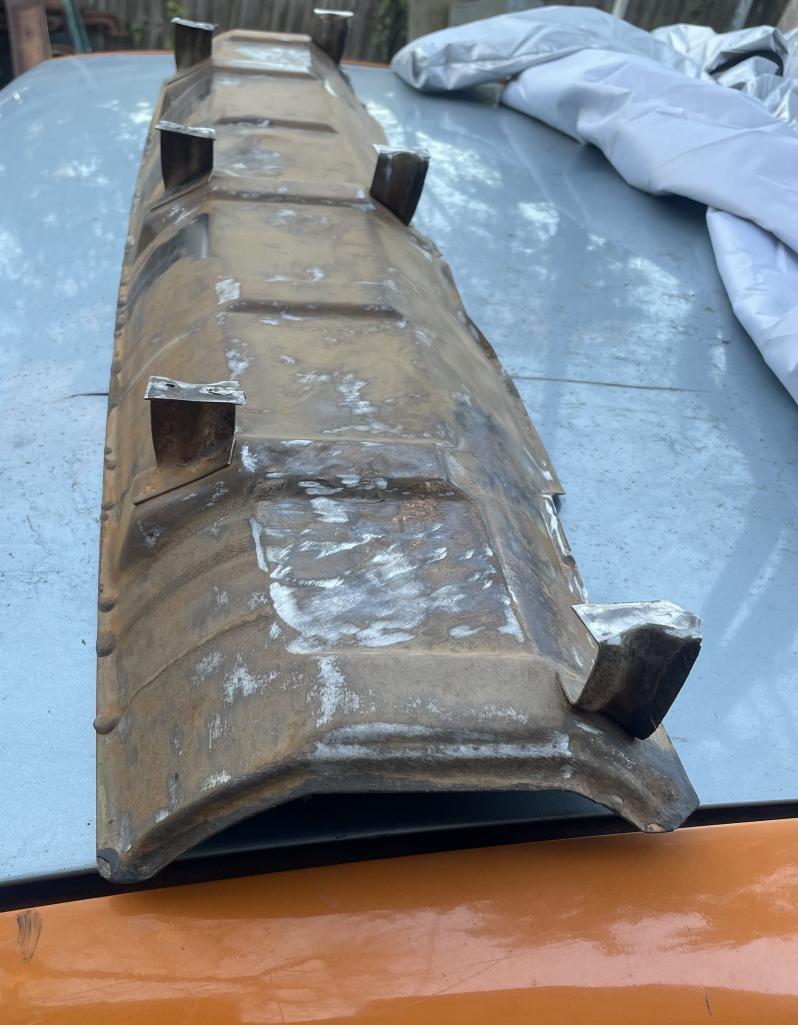

Literati914 I cut this section off my parts car (late model) t... Dec 8 2025, 12:57 PM
Literati914 Here’s a shot showing the compromised metal area... Dec 8 2025, 01:03 PM
Literati914 I cut away the edge of the piece that sits atop th... Dec 8 2025, 01:07 PM
Literati914 Since the cross member section of this car is in g... Dec 8 2025, 01:11 PM
Literati914 I then salvaged the original heat shield: Dec 8 2025, 06:24 PM![]() ![]() |
