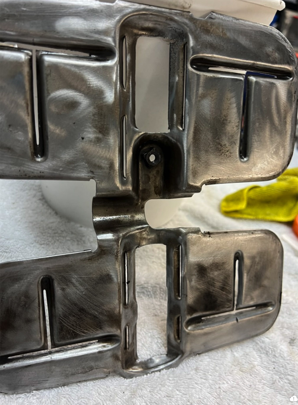

Here's one version of a modified windage tray, although a little hard to see. Don't know what version we'll put in the project motor yet. Can't find another photo of one that's much more modified (think it was from a Raby motor), but maybe searching around, you can track it down. Probably the best choice is to make/increase drain back holes, slots and probably be sure to put them right below the pushrod tube ends. Is this cut on the other side also? Thanks |

Thanks for sharing Bob!
That looks like how I remember the tray (or very similar), but just couldn't find the photo. |
