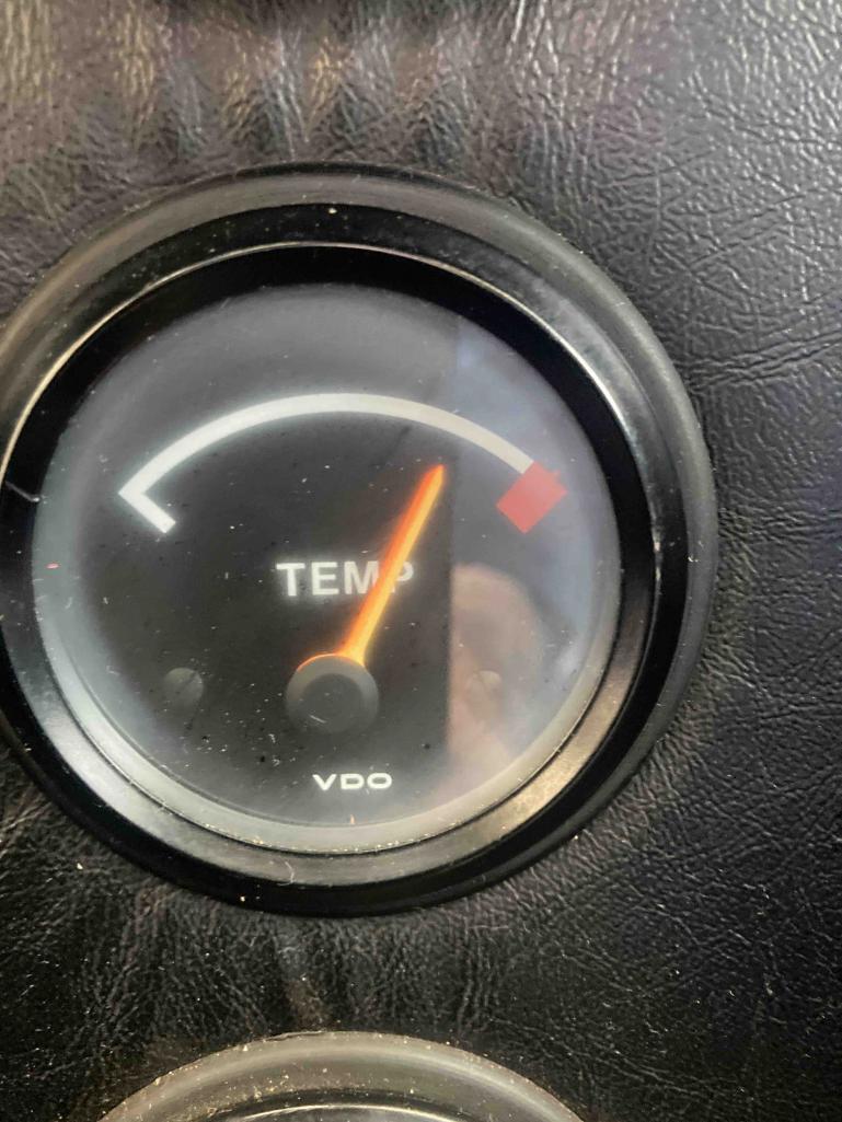

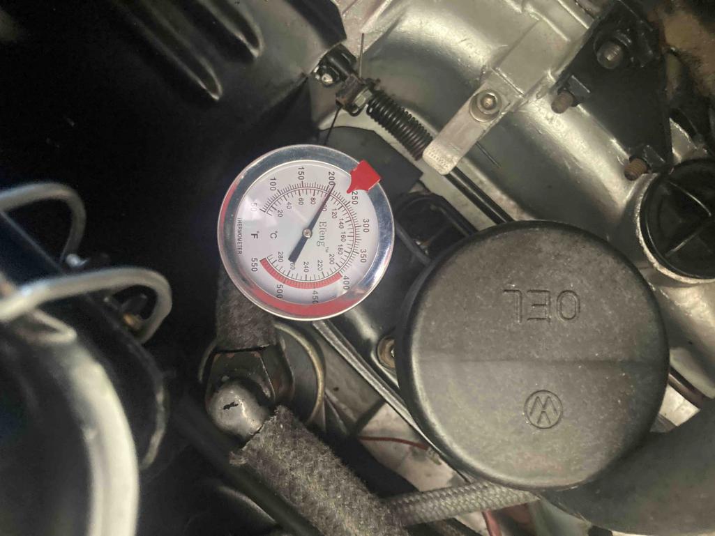

After driving around town for 30 minutes the photo shows my oil temperature oil gauge and a actual thermometer reading using a turkey fryer thermometer.
The needle on my console gauge gets very close to the red high mark and sometimes just about to cross into the red .
At this point the turkey thermometer reads ~216 F degrees .

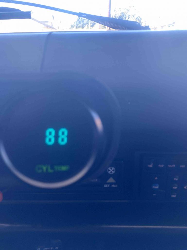

My Dakota Digital head cylinder temperature reads 111C (231F) .

Dave_Darling   The temp gauge on the center console is not super ...   Dec 10 2025, 02:45 AM

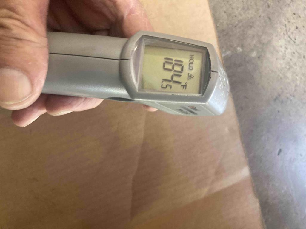

Ron914   I made a couple of more temperature readings when ...   Dec 11 2025, 06:24 PM

emerygt350   I think the turkey thermometer is probably as good...   Dec 12 2025, 06:07 AM
